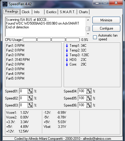

Swee, here be the speedfan picture:
Please run the SIW instructions to verify the readings :D

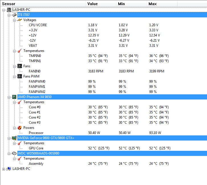

Oopsie! Here's the info:
Motherboard:
Property Value
Manufacturer ASUSTeK Computer INC.
Model M4A785-M
Version Rev X.0x
Serial Number 105329600000879
North Bridge AMD 785G Revision 00
South Bridge AMD SB700 Revision 00
CPU AMD Phenom™ 9850 Quad-Core Processor
Cpu Socket Socket AM2+ (940)
System Slots 4 PCI
Memory Summary
Maximum Capacity 16384 MBytes
Memory Slots 4
Error Correction None
Warning! Accuracy of DMI data cannot be guaranteed
OK temps and voltages verified and within acceptable ranges.
