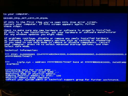

I've had 2 Blue Screens today both to do with tcpip.sys. I don't have a clue why it's happening but it's only started doing it today. I've read a couple of topics on the forum and have downloaded BlueScreenViewer to get the details, I will also attach the dumps and a screenshot of the blue screen for you. Hope someone can help.
Dump File : 030811-52587-01.dmp
Crash Time : 08/03/2011 18:29:19
Bug Check String : DRIVER_IRQL_NOT_LESS_OR_EQUAL
Bug Check Code : 0x000000d1
Parameter 1 : fffffa80`09440000
Parameter 2 : 00000000`00000002
Parameter 4 : fffff880`01754ae7
Caused By Driver : tcpip.sys
Caused By Address : tcpip.sys+87ae7
File Description :
Product Name :
Company :
File Version :
Processor : x64
Computer Name :
Full Path : C:\Windows\Minidump\030811-52587-01.dmp
Processors Count : 2
Major Version : 15
Minor Version : 7601
Dump File Size : 291,440
Dump File : 030811-51371-01.dmp
Crash Time : 08/03/2011 14:33:12
Parameter 1 : fffffa80`08dc8000
Parameter 4 : fffff880`0174cae7
File Description :
Product Name :
Company :
File Version :
Processor : x64
Computer Name :
Full Path : C:\Windows\Minidump\030811-51371-01.dmp
Major Version : 15

The DRIVER_IRQL_NOT_LESS_OR_EQUAL bug check has a value of 0x000000D1. This indicates that a kernel-mode driver attempted to access pageable memory at a process IRQL that was too high.
Important Information If You Have Received a STOP Code
If you have received a blue screen error, or stop code, the computer has shut down abruptly to protect itself from data loss. A hardware device, its driver, or related software might have caused this error. .
  • Download and install updates and device drivers for your computer from Windows Update.
  • Scan your computer for computer viruses.
  • Check your hard disk for errors.
GOING ON FROM HERE
1. Check Device Manager, including on the view tab, show hidden devices - are there any error warnings pls.
If so and particularly if it is on the network adaptor, please, check for any driver updates. If none are offered, uninstall the device and reboot.
2. It could be a memory fault, but you would most likely have other symptoms. - we can look there later.
Post back with results pls.
We will I think next move to reset TCP/IP stack

I do not really expect Who Crashed to help a lot.
I expect the report to say that the error may have been caused by a fault in a kernel driver that cannot be identified at this stage. OR words to that effect.
HOWEVER it was worth running just in case.
If I am right to save you waiting
1. Uninstall the driver for the network adaptor. -Device manager, open device. Driver tab, uninstall
Reboot and Windows will reinstall the driver.
2. If that does not work check please for any driver updates that have been installed on automatic updates if you have those configured.
Also check pls if any new software has been installed.
