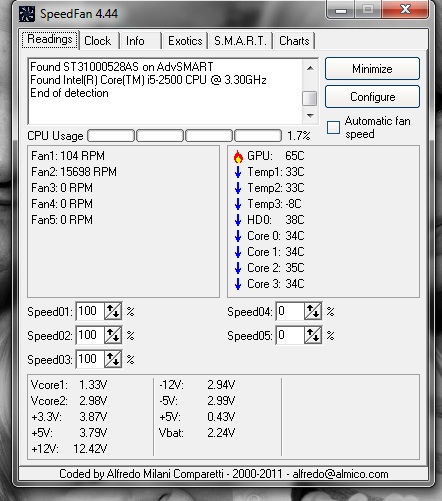

hello
we are having issues with our PC.
it is a newly rebuilt, around 6 months old.
It has been working perfectly, very quickly, until the last week or so, it's like it's had a breakdown.
Hubby filled the computer hard drive up when needing to redo his external hard drive, but even since removing those files the computer has been slow to the point of not functioning at all at times.
It is slow to boot up, like 10-20 minutes, and loading any program/performing any function can take a long time.... again 20 minutes or longer.
I'm not much on technical things with computers, but i found this site useful many years ago.
Am hoping someone with patience can please guide me through some options for fixing this.
Thanks in advance for any help.

IMO what you have is a lot of file fragmentation and I am going to address that after getting some logs and pics of your system. Please follow the steps below and in your next reply include any requested logs and pics.

I have done the steps as best i could, however the pc pitstop wouldnt work even though i tried the troubleshooting tips.

Version EVEREST v2.20.405
Report Type Quick Report
Computer DESKTOP
Generator Default
Operating System Windows 7 Professional Media Center Edition 6.1.7601
Date 2011-08-04
Time 11:52
Computer:
OS Service Pack -
Computer Name DESKTOP
User Name Default
Motherboard:
CPU Type 4x , 3300 MHz
Motherboard Name Unknown
Motherboard Chipset Unknown
System Memory 8173 MB
BIOS Type Unknown
Display:
Video Adapter NVIDIA GeForce 8600 GT
Monitor Generic PnP Monitor [NoDB] (HMDQ301692)
Multimedia:
Audio Adapter High Definition Audio Controller [NoDB]
Storage:
IDE Controller Intel® 6 Series/C200 Series Chipset Family 2 port Serial ATA Storage Controller - 1C08
IDE Controller Intel® 6 Series/C200 Series Chipset Family 4 port Serial ATA Storage Controller - 1C00
Disk Drive ST31000528AS ATA Device (931 GB, IDE)
Disk Drive Generic USB CF Reader USB Device
Disk Drive Generic USB MS Reader USB Device
Disk Drive Generic USB SD Reader USB Device (7 GB, USB)
Disk Drive Generic USB SM Reader USB Device
Disk Drive Lexar JD FireFly USB Device (7 GB, USB)
Optical Drive PIONEER DVD-RW DVR-219L ATA Device
SMART Hard Disks Status FAIL
Partitions:
C: (NTFS) 953639 MB (515889 MB free)
Input:
Keyboard HID Keyboard Device
Mouse HID-compliant mouse
Network:
Network Adapter Realtek PCIe GBE Family Controller (192.168.1.151)
Peripherals:
Printer \\LAPTOP\Canon MP495 series Printer (Copy 1)
Printer Canon MP495 series Printer (Copy 1)
Printer Fax
Printer Send To OneNote 2010
USB1 Controller Renesas Electronics USB 3.0 Host Controller [NoDB]
USB2 Controller Intel® 6 Series/C200 Series Chipset Family USB Enhanced Host Controller - 1C26 [NoDB]
USB2 Controller Intel® 6 Series/C200 Series Chipset Family USB Enhanced Host Controller - 1C2D [NoDB]
USB Device Generic USB Hub
USB Device USB Composite Device
USB Device USB Input Device
USB Device USB Mass Storage Device
Edited by djam777, 06 August 2011 - 10:55 PM.
OK here we go with some recommendations.
First off your voltages and temps look good except for your video temp. It's running a couple of degrees warm for being idle.
When was the last time you opened the system and cleaned out the inside using a can of compressed air? Pay close attention to the fans and don't let them spin freely while cleaning them out.
Now on to the next set of instructions.
