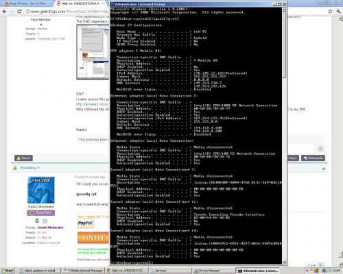

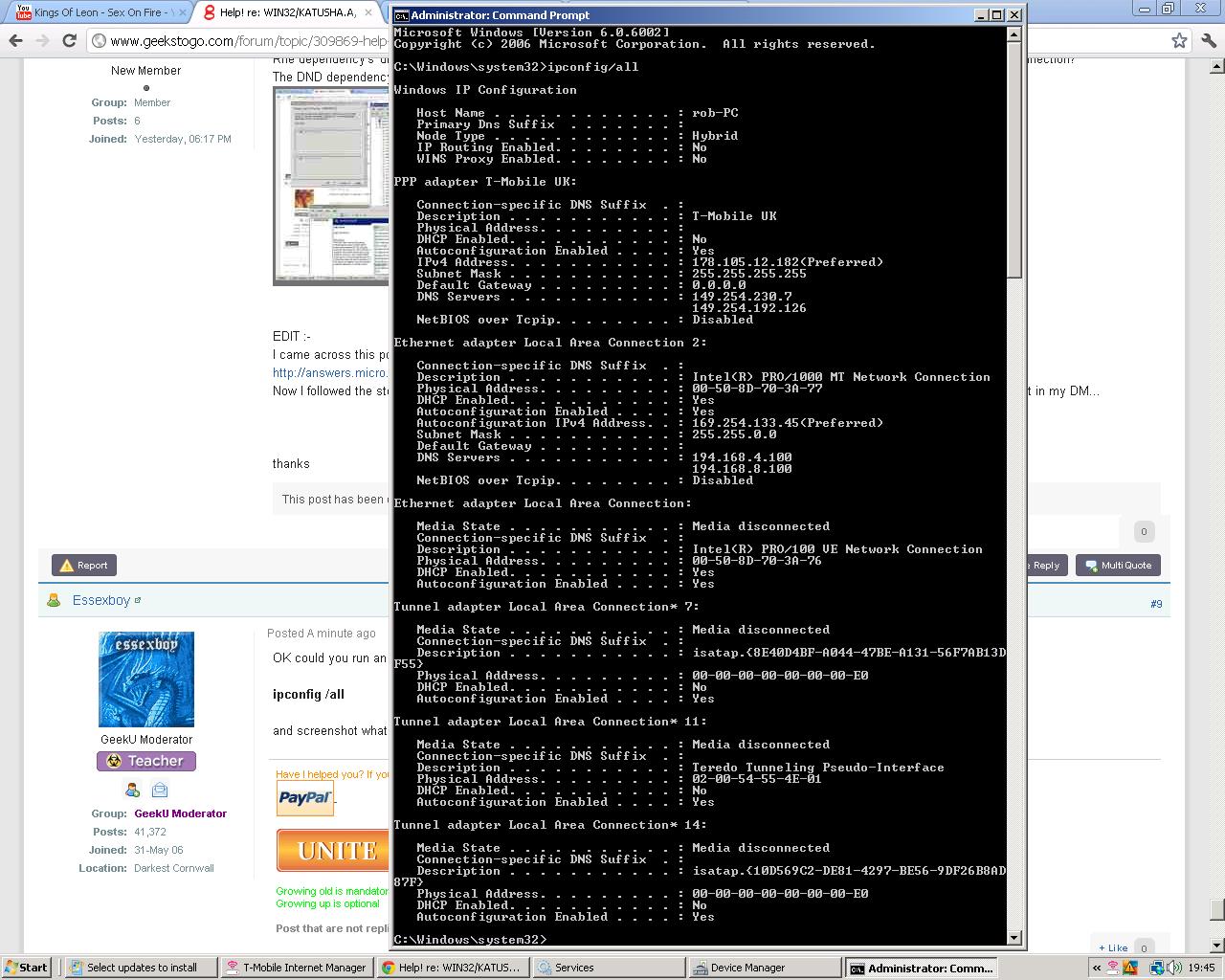

OK I like a mystery so lets get at it... First when you try to connect to the internet what error do you get ?
First I will take a look at the system, then run some repairs and finaly check out the net problem

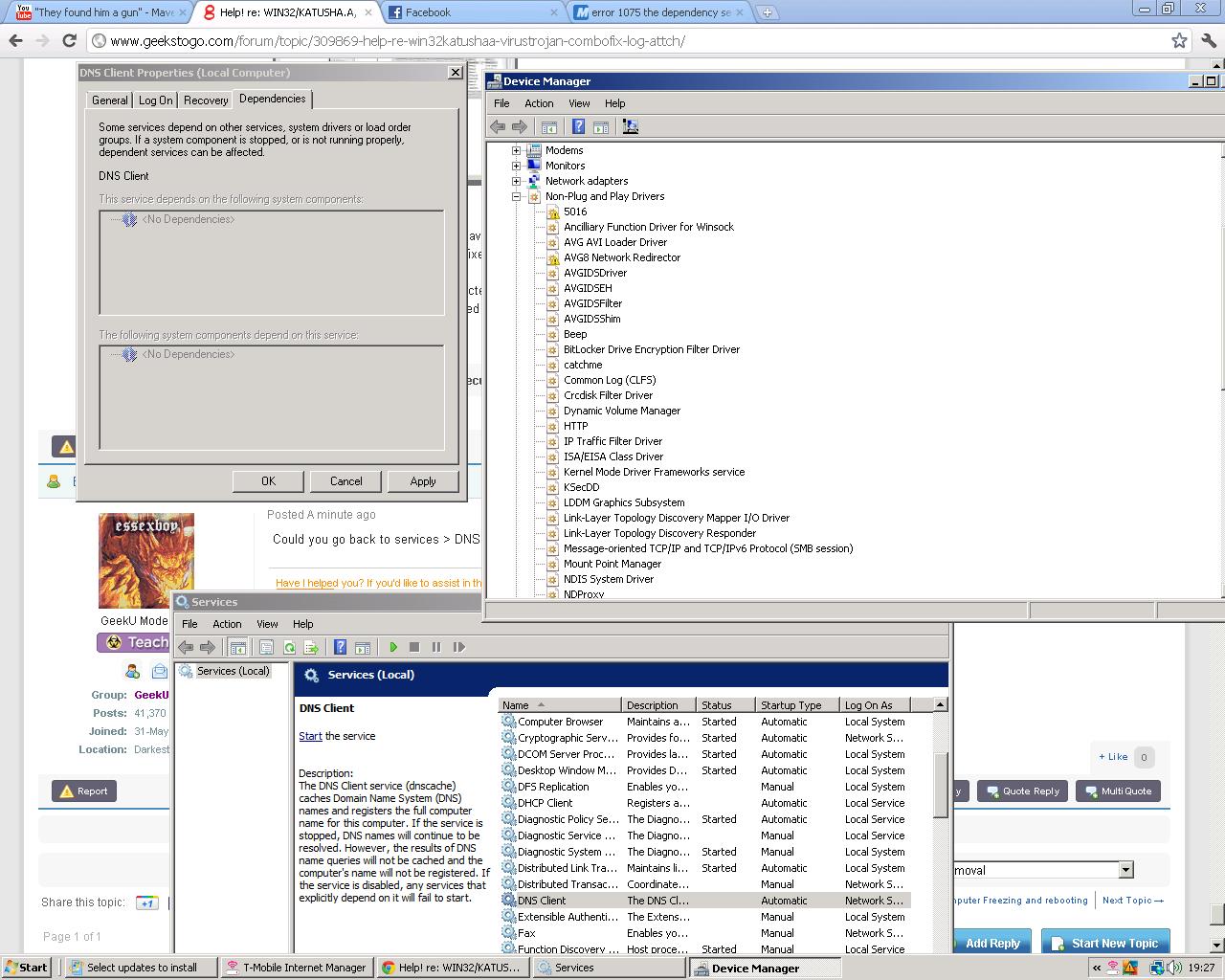

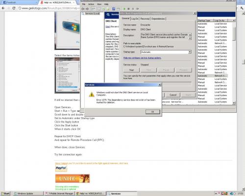

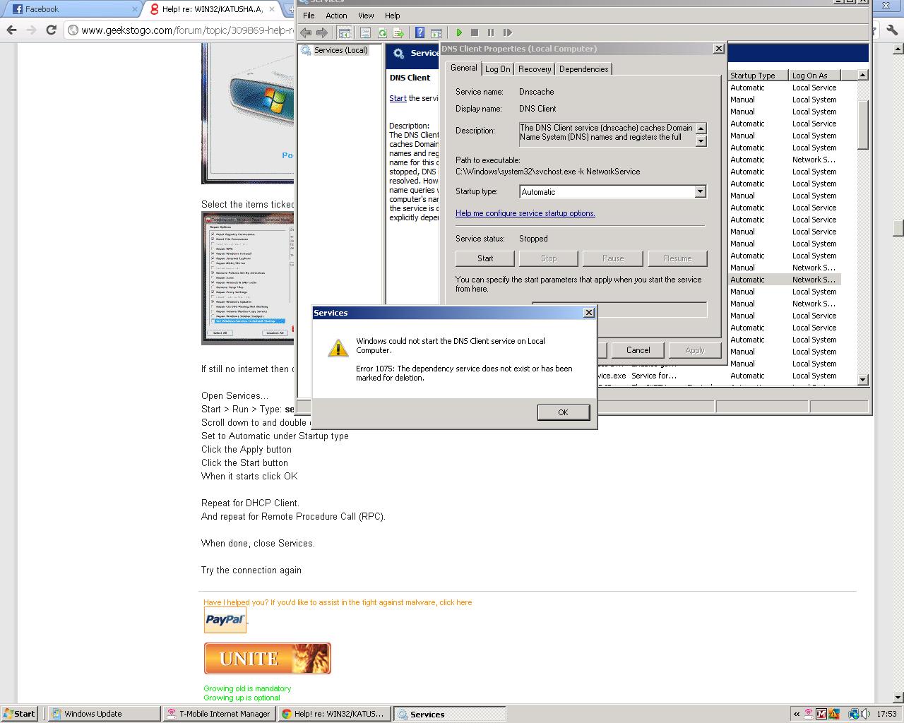

If still no internet then do the following checks
Open Services...
Start > Run > Type: services.msc > Click OK
Scroll down to and double click DNS Client
Set to Automatic under Startup type
Click the Apply button
Click the Start button
When it starts click OK
Repeat for DHCP Client.
And repeat for Remote Procedure Call (RPC).
When done, close Services.
Try the connection again

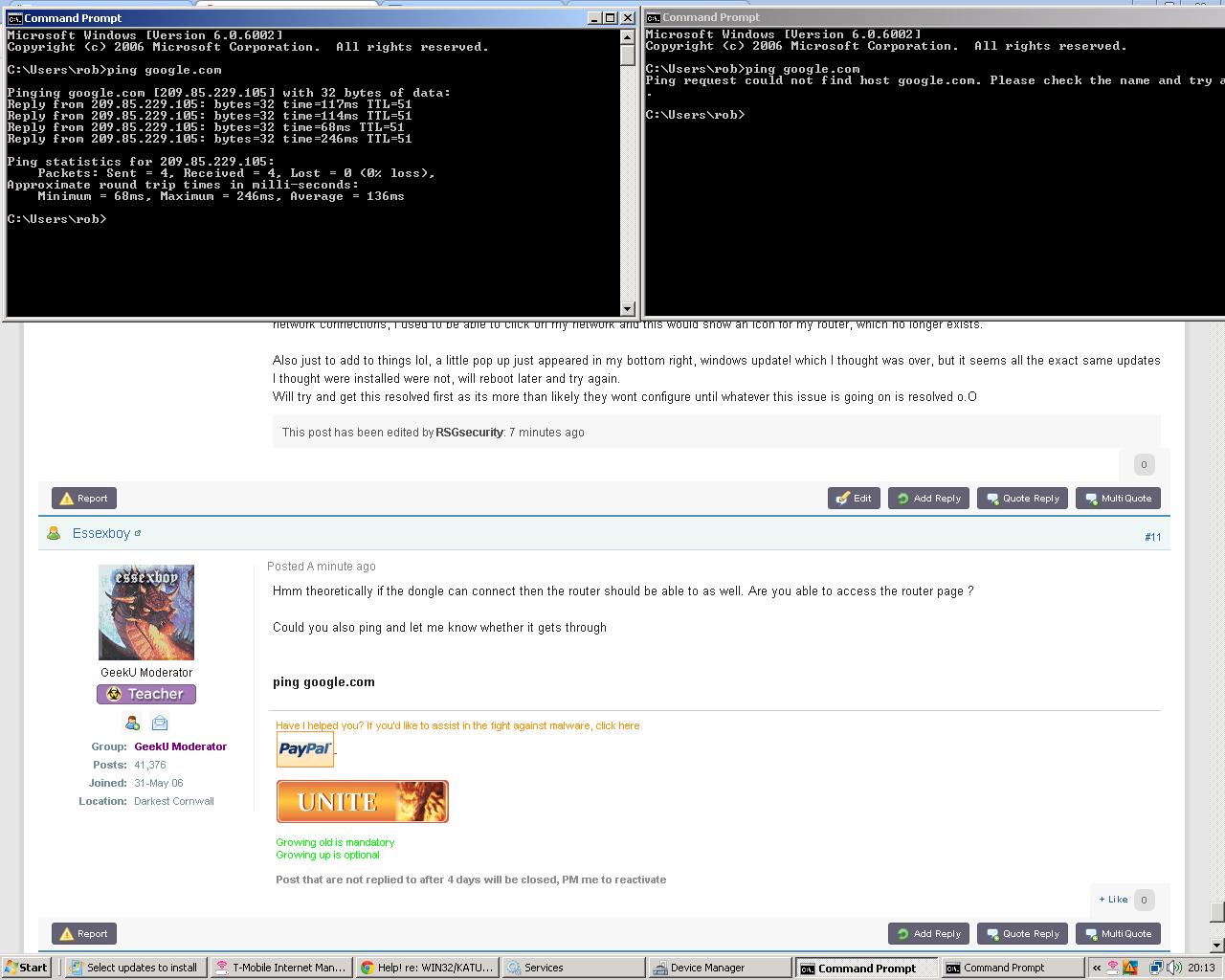

Thanks for your reply, im just scanning OTL now and have installed all in one. With regards to the error message with the internet, its just the simple page cannot be displayed, on IE, Chrome and firefox.
In the mean time, just as an update, I have managed to (well I am sure I have) remove all traces of any malware/viruses, using the miracle bit of kit combofix
Now I have reinstalled AVG and Malwarebytes and both are now scanning/running fine and report no problems, but yet, I still have the odd file not allowing me the correct privileges and my computer still will not recognise my virgin router (or does randomly but then looses it).
Now I rang virgin, went trough several steps grinding my teeth, reset the router ect, now there answer after I was still unable to even bring up the router page trough IE was, "oh your router must be faulty we will send you a new one" now I am almost certain this is not the case but hey ho.
Now my computer can connect to the internet using a dongle I have via t-mobile plugged straight into a USB, so the computer can connect to the internet as I am sitting on it now, just am unable to connect to my bloody router via my virgin connection.
I was connected last night for a couple of hours, it was very odd, I was fully connected, downloading updates trough steam ect, but yet was unable to browse via anything, firefox, chrome, IE, but I was defiantly connected? I googled this and it seems a mystery problem some have but just will randomly cure itself?
Also, I don't know if its related to my iconnection but I can download windows updates fine, but when I restart to install them, they install, comp reboots, then it sais there was a problem configuring them and reboots and rolls back/de-installs them, was not sure if it was because I had to be connected to the internet while they was configuring but did not think this was the case.
but yes thats where i stand at the minute, will post the OTL log as soon as it finishes and then run allinone and keep my fingers crossed.

Right allinone scan complete, conclusion...
It appears to have fixed all my broken shortcuts/admin restrictions which is great, so I can now access all the old files I was unable to before giving me full access back, also, its appears to have solved my windows update problem, after the scan it rebooted, installed updates and appeared to flow properly. so yes, thanks a million.
However, I still have my internet connection problem, now i ran trough services, went to start the first step, double click DNS Client, selected automatic, clicked apply, pressed run, then... this error message appears... (attch)
Now this seems to me like it may have been affected when I had a virus and upon removal/rapair of the infections, this file may have been affected? although I would of expected allinone to have fixed this?
Please let me know your thaughts.
edit= just thinking, I was still connected to the internet via my t-mobile dongle when I hit start, this would not be the cause would it? surely it should still locate the DNS regardless if I am connected via whatever means?
Kind regards.

Could you go back to services > DNS client and open the dependencies tab... What file(s) is it having problems with
RSGsecurity
RSGsecurity
  • 34 posts
Evening essex,
please find attch a screen shot showing my dependency's' or rather lack of, also a screen shot of a possible error in device manager
Rhe dependency's' under DNS are not showing anything, but please also review what I am looking at under Device manager, possible connection?
The DND dependency's being on the left and device manager right.

OK could you run an elevated command prompt and type the following please
ipconfig /all
and screenshot what you get.
RSGsecurity
RSGsecurity
  • 34 posts
as requested :) thanks again for the help.
Top connection being the mobile dongle from t-mobile I was talking about, second one being the connection which should be virgin, also when I check my network connections, I used to be able to click on my network and this would show an icon for my router, which no longer exists.
Also just to add to things lol, a little pop up just appeared in my bottom right, windows update! which I thought was over, but it seems all the exact same updates I thought were installed were not, will reboot later and try again.
Will try and get this resolved first as its more than likely they wont configure until whatever this issue is going on is resolved o.O
Edited by RSGsecurity, 09 November 2011 - 02:04 PM.

Hmm theoretically if the dongle can connect then the router should be able to as well. Are you able to access the router page ?
Could you also ping and let me know whether it gets through
ping google.com
RSGsecurity
RSGsecurity
  • 34 posts
nope, cannot even access my router page, but yet last night i could at points, but then others not, and also as stated prev i was actually connected fully last night, as my dongle was diss-connected and i was uploading tf2 from steam and able to load msn/outlook ect, but yet unable to browse on any browser, but since the connection cut off then, its not been back, whether or not it is connected to that missing file on device manager I don't know.
Attch are the ping results, (tried one whilst connected via my dongle, one while it was dis-connected leaving it down to my virgin connection). left is when the dongle is connected, right is when it is dis-connected, my network connection for virgin is just stuck on identifiying... very odd, and very frustrating!
Essexboy
Essexboy
    GeekU Moderator
  • 69,964 posts
They may well be right in that the router is bad, as all the right files are in the right place and correctly identified within the registry
The dongle uses the same elements and connects well
Yet the router is inaccesible
