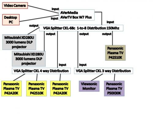

Hello there, attached is the draft plan of my church multimedia setup. Apparently i sometimes face problems with the projection. When i change the source in the AverMedia from computer to video, some of the Plasma TV's show "no signal". I suspect it is the video splitter or the Avermedia is causing this. For the video spltter i'm using a 150Mhz 8-way video splitter and i have many splitting in there. For the Avermedia, i think the device might not have enough power to support the splitting. I need help from experts to help me see this draft to check is there a problem in this setup. Thanks guys....:)
