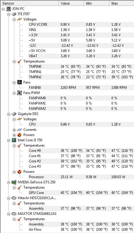

You have this installed
CPUID HWMonitor 1.165/21/10
Run it and get a comparison on the temps with Speedfan

Attached is the cpu hw monitor readings. I replicated the situation when I usually have the crashes so the temperatures should be close to those when I experience the freezing.

Well according to your last screenshot I do NOT think it is a thermal issue on the CPU
http://ark.intel.com...-Cache-2_66-GHz)
The TCase temp of that on the above link is 72.7C and the core temps on your screenshot of the four cores are shown max. in a range 44 to 49c
Core temps should generally be below BUT certainly no more than a FEW degress above Thermal specification.
On average, the temperature of the heatspreader is about 10-20C lower than that of the cores. This varies from CPU to CPU depending upon solder. So if the thermal specification of a CPU is 71C, the cores would have to be running at 81C before you would reach the thermal specification.
SO thermal specification is the maximum temp there should be at the centre of the heatsink.
In short, it appears the issue is not the cooling of the CPU
I WOULD HOWEVER monitor those temps and I would use CPUID again so that you know what readings you have obtained previously for comparison.

I KNOW that I said I did not think it was a temperature issue but HOW many fans do you have
CPU
GPU fan on card
and which others please.

Regarding your last question I have 1 heatsink & CPU fan, 1 attached GPU fan and 3 case fans (one 120mm in the back, one 80mm on the side and one 80mm in the front.)

Please take the side panel off.
LEAVE it off, if there is a case open alarm, disable it in BIOS
Run the computer - check please that ALL fans are working, depending on how you have them configured and connected - some will work at full speed continually from the PSU, some will work from the
M/B fan headers controlled by the setup. eg high speed low speed etc as required by the system temperatures.

Also I am confirming that all fans are working.
