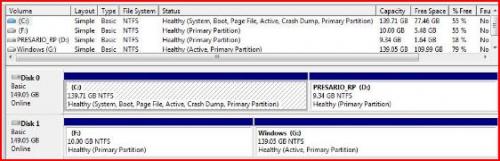

Unless you are utilizing another operating system other than that of Windows 7 (Vista; pretty much the same thing) I would not worry about any driver CDs (mini CDs or otherwise) that came with your external driver "kit" because 9-out-of-10 times Win7 has the "generic" drivers to access pretty much any of the current external drive enclosures in use today (whether the drive is a hard drive or a Blue Ray / DVD / CD-ROM (burner or not) drive that is enclosed within the enclosure. Just for FYI future reference. That being said... on to your notebook issue.
QUESTION: ARE YOU RUNNING WINDOWS 7 ON BOTH THE COMPUTER THAT YOU ARE TRYING TO ACCESS THE EXTERNAL HARD DRIVE AND THE NOTEBOOK (the notebook hard drive, yes) ??? :headscratch:
IF your notebook OS is Windows 7 and your other computer is NOT Windows 7, then good chances are that the computer you are trying to access the notebook's hard drive CANNOT read the NTFS file system.
IF the other computer HAS WINDOWS 7 ON IT and you CANNOT still access the hard drive you can try going the Computer Management...
(Short cut: open a "RUN" window and type, no quotes, "compmgmt.msc" OR go to Start >> ALL PROGRAMS >> ADMINISTRATION TOOLS >> COMPUTER MANAGEMENT )
Even if you cannot access the drive, if Windows gives you a Drive Letter you have a good chance that you can possibly access the dive and retrieve some or all of the data.
Under the Computer Management you should see the Word STORAGE as a heading somewhere on the left side of the split window.
Next, click on the little "Right Pointed carrot" to access the STORAGE sub-menus...once there click on the "Disk Management" and in a second or two you will (or should see) the drive information of all your drives connected to that computer...
If the hard drives all have the same File System (usually NTFS) then you are half way there to recovering what you need on your hared drive... :yes:
Clicking on a volume name will also highlight the graphical display of that same drive below, in this case your external hard drive.
You should also take note that since you are dealing with "another" "Drive C:" your current computer's hard drive and the external had drive should be identical as far as the partitioning is concerned.
You can force Windows to do a re-read of the hard drive and see if Windows can access the drive by Right Clicking on the physical (located in bold) hardware drive number (this is the number [Disk 0, Disk 1, Disk 3, CD-ROM 0, CD-ROM 1, CD-ROM 2] of where the physical drive is connected to your computer via the BIOS). The drive letters are known as Virtual Hard drives where as the physical hard drives or CD-ROM drives are known as DRIVE 0 (usually Drive C:) and DRIVE 1 (usually virtual drives E: ~ Z:) and your physical CD/Blue Ray/DVD (burner or not) is CD-ROM 0 (this is usually an internal drive unless you bought a computer without one).
You can take any hard drive off line and then return it to an online status by Right Clicking on the physical drive number and choosing OFFLINE (you MUST have Administrative Rights for anything you do in this section). Also IF you do take the drive (or any drive) off line you might need to either enter Device Manager which you can access under Computer Management, then Rescan for hardware changes or reboot the computer.

My apologies for being so vague. The laptop that displayed "Missing Operating System" on reboot is Vista Home Premium. The laptop that I am using as a host to insert the USB external enclosure into is Vista Home Basic. They are both NTFS.
The malfunctioning notebook (VHP) HD is a Western Digital Scorpio.
I do have a 2nd Vista Home Premium laptop that I tried to access the HD from without success.

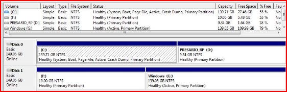

I have included an image of Computer Management that displays from the Vista Home Basic "host". I see that everything on Disk 1 is intact yet inaccessible at this time.
I'll read your post above more thoroughly now.
