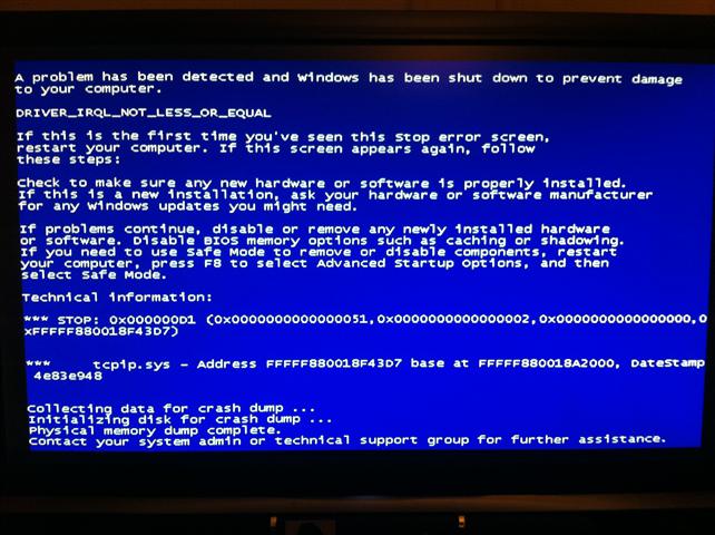

Hi gang, I am hoping someone out there can help me out. I have now experienced 5 blue screens all with the same basic info. I will paste everything further below.
The crashes started happening right around the same time I was having issues with AVG not updating properly. AVG instructed me to uninstall and re-install AVG, which I did. After that, the blue screens increased.
The only other programs that i have installed around the time when the blue screens started include: Pandora Music Desktop App, An upgrade for Adobe Lightroom, A CCleaner update, a Soluto update, a Dropbox update, Dell Support Center update, Windows Live Essentials updates, and Adobe ReaderX and 9 updates. i don't know if the error is caused by a conflict wiht one of these programs. I have not installed any new hardware.
The crash seems to happen however soon after AVG auto updates definitions and such; although i can not be 100% positive this is when it is happening.
I will attach two files, a photo of the blue screen, and a .dmp file.
I am hoping someone has a workable solution other than reformatting and re installing W7.
In case this additional info helps, I have a Dell Studio XPS 9100. Bios A02. Windows 7 Ultimate SP1. DirectX Version 11. Intel i7CPU [email protected]. Cores 4. Thread 8. Hard Drive ST31500341AS (seagate). Memory Type DDR3-SDRAM (1333) Nanya Tech.
Thanks in advance!
Dump File : 050812-44569-01.dmp
Crash Time : 5/8/2012 10:55:23 PM
Bug Check String : DRIVER_IRQL_NOT_LESS_OR_EQUAL
Bug Check Code : 0x000000d1
Parameter 1 : 00000000`00000051
Parameter 2 : 00000000`00000002
Parameter 4 : fffff880`018f43d7
Caused By Driver : tcpip.sys
Caused By Address : tcpip.sys+523d7
File Description :
Product Name :
Company :
File Version :
Processor : x64
Crash Address : ntoskrnl.exe+7cc80
Stack Address 1 :
Stack Address 2 :
Stack Address 3 :
Computer Name :
Full Path : C:\Windows\Minidump\050812-44569-01.dmp
Processors Count : 8
Major Version : 15
Minor Version : 7601
Dump File Size : 286,636

Is is the free version of AVG?
Uninstall AVG for a day or two and tell me if any blue screen comes up during that time.

It is not the free version, but is the full AVG 2012 Internet Security package. I tend to not want to shut the entire AVG off for a few days, and would more likely just turn the auto updates off, since this is when the problem seems to have been happening.
I have the AVG uninstaller tool, and had thought about using Microsoft Security Essentials in the meantime.
I sent a complete log of events to AVG and they said they would look it over.
I also went to Dell's online chat assistance site. I was quite pleasantly surprised at how helpful they are, Normally I am unimpressed with Dell customer Service.
They looked over all the details and zeroed in on a piece of code that made them feel that it was the drivers for my network adapters that got corrupted. They could not say with certainty if it was AVG or a Windows update that caused it. They felt it was a 50/50 either way. So they just had me download two different drivers: R266204 and R290807, then uninstall the old ones and install the "new ones."
Things seem to be stable for now, but I will give it a few more days before I feel confident. I am also curious to what AVG will say.
i will update you in about a week and let you know if the drivers by themselves worked.
