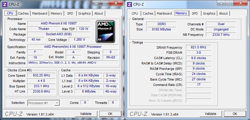

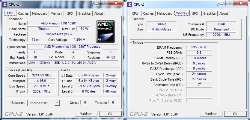

I apologize for the delayed response. Okay so I did the OC Tuner thing in the BIOS setup. Here are the screen shots from CPU-Z of the CPU & Memory for before & after. So far I've been able to run Maya fine for about a half hour with no BSOD :thumbsup: . I'll continue to run it for a few hours to see how it holds up and I'll report back. So far so good :happy: .
