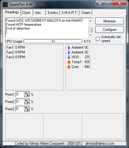

Running SpeedFan, attached the image.

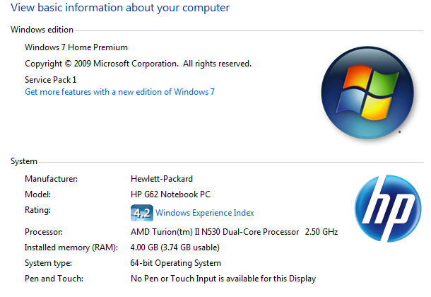

So here's my problem, HP G62, it's about 2 years old, pretty heavy usage.

First you need to shut down your laptop or risk serious damage to your CPU. the reason being is that the results of your speedFan that you so kindly posted is that your fan(s) are NOT running at all(0 RPMs isnt good), so until we can figure out what is causing your fans to stop and fix it you need to keep it off and only use your laptop for short periods that wont hurt it( i believe <2 mins at a time with a 5-10 min break to let the heatsink cool wont hurt it. please someone correct me here if i am wrong.)
now jjblayde depending on how you feel will depend on what happens next. since your laptop is only 2 years old you it *MIGHT* still be under warranty, and in that case i highly suggest you send it to HP and have them fix it, because otherwise you might risk voiding your current warranty. IF you can take this option do your best to backup the rest of your data from your laptop!
if your laptop isnt under warranty then you can either take it to a trained professional, or take the laptop apart yourself, because to find out whats causing the fan to fail requires being able to get at it.
if you chose to try to do it yourself then please read This Guide to disassemble your laptop. if you chose to do this please read through it first and remember that you dont have to take the LCD apart and you can stop at step 25 to access the fan.

Interesting. Sorry for posting in wrong thread, wasn't sure if it was Windows 7 putting too much stress on my computer, or if it was a problem with some drivers causing my computer to run more than it should, etc.
It sure does sound like the fan is running most of the time. When it starts getting really hot the computer starts spewing hot air and I hear the rotation. Though the speedfan readings are ominous..

The readings that you will get from Speedfan are determined by what sensors your MB has and notebooks do not have anything like the sensors on their MBs that desktops do.
Inspect the cooling fan and clean out any heat trapping dust at the same time, this includes removing the memory stick/s, blowing out the slots and then replacing the Ram securely, those notebooks are known to run hot so I suggest that you invest in a notebook cooler like the example @ http://www.newegg.co...Order=BESTMATCH
FWIW, if the CPU cooling fan is known to be none operational then under no circumstances should you apply power, it takes seconds for a processor to fry.

Yea see my computer was on for a very long time yesterday and ti ran just fine. So it appears as if the fan must be working, I can't be consistently using my computer for 6 hours straight without it overheating if the fan was non-operational.
So it seems I still don't have an answer. Remember that my wifes laptop is identical and it never runs as hot as mine. The only difference I could find was that I had drastically larger amounts of memory used up (she had somewhere around 20gigs on her laptop, where I had 120) I have since backed up and erased nearly everything yet I'm still experiencing this problem.
