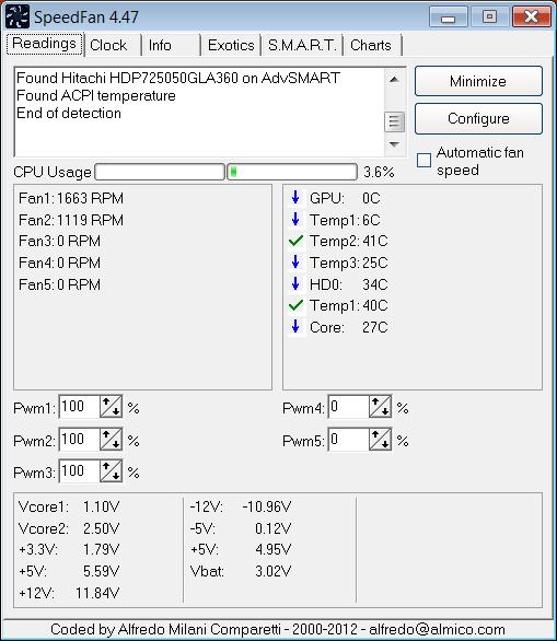

Download Speedfan and install it. Once it's installed, run the program and post here the information it shows. The information I want you to post is the stuff that is circled in the example picture I have attached.
Post here the screenshot first before doing step 2, depending on the results we may need to run an alternative program to get further readings for comparison.

  • 16 posts
Here is the file you asked for. I will run the memory test shortly.
  • 25,095 posts
Thanks for the screenshot :thumbsup:

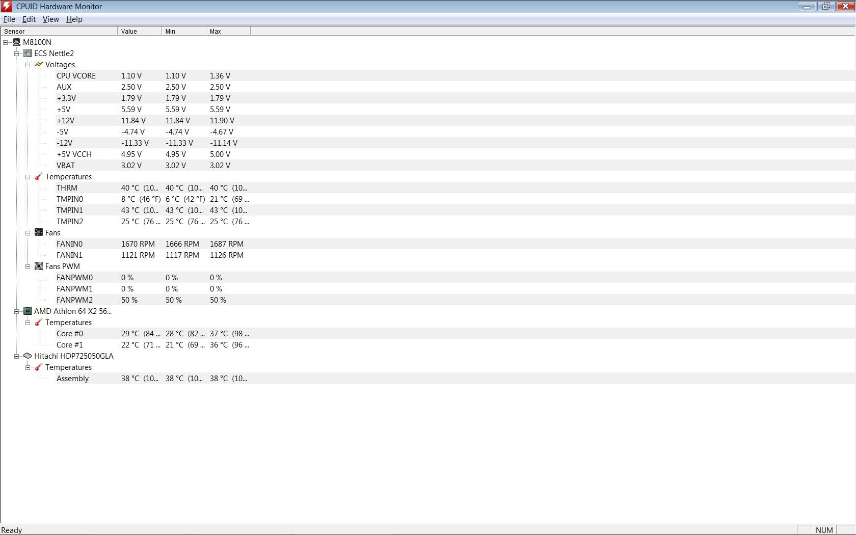

The +3.3V rail is showing as being on the low side (see table below) when you are able to please repeat the first procedure but use HWMonitor this time http://www.cpuid.com.../hwmonitor.html

  • 16 posts
Here is the file you requested.
  • 25,095 posts

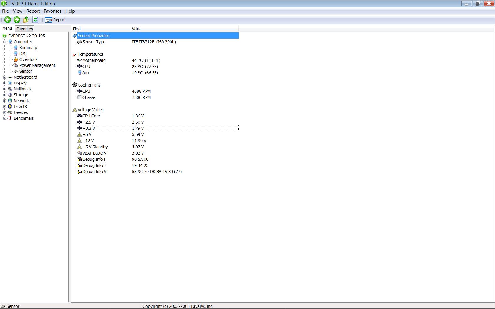

The +3.3V rail is again showing a low output so I suggest a final test for confirmation
Download and install Free Everest Home Edition http://www.filehippo...d_everest_home/
Open it.
2: Click once on Summary
3: In upper menu, go Report
Click the + by computer, click on Sensor. Get a screenshot and post it so your temps and voltages can be checked.

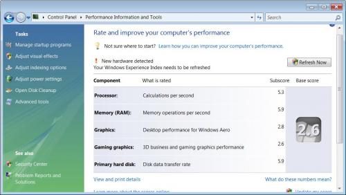

  • 16 posts
I went into the "Performance Information and Tools" to rate my computer's performance. Every time I try to refresh it my computer goes to Blue Screen due to Memory Management. It will not let me finish the tests.
  • 25,095 posts
Try turning off Windows Aero and see if that helps, see Adjust Visual Effects tab.

  • 16 posts
Here is the information you wanted. I haven't tried running a memory test yet. I doubt that it will allow me to do so. Like I said, it will not
even let me refresh the performance test. I'll give it a try though.
So, if my +3.3V rail is faulty, exactly what does that mean?
  • 25,095 posts
The Everest report also shows the same bad +3.3V reading which almost certainly proves that your PSU is bad and needs to be replaced, as I said earlier the +3,3V is often responsible for the Ram slots specifically the memory controller meaning that the Ram and slots are not bad but the electrical supply that they need to function correctly is.
Swapping in a known good power supply is the only thing that you can do now, can you borrow one for testing purposes.
