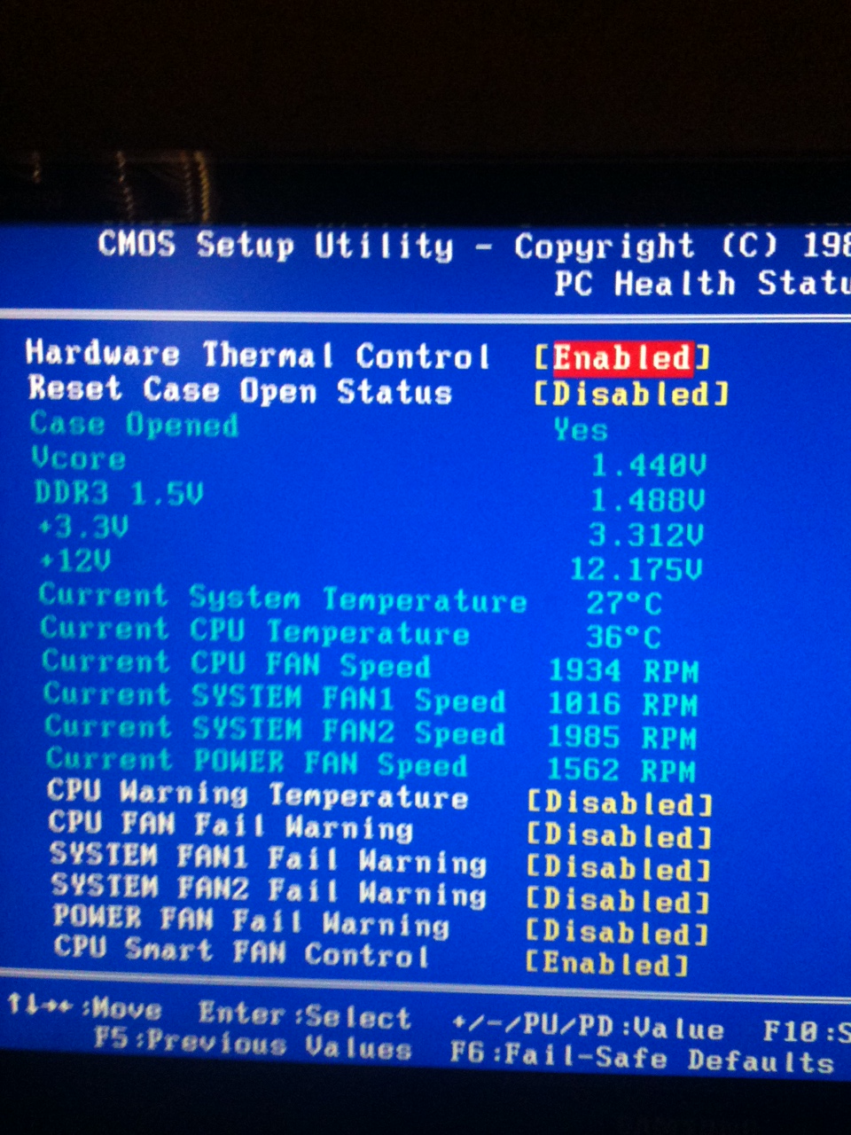

I can't actually boot it up all the way at the moment but I did get this info from CMOS. I hope it's acceptable
Edited by RyeChips, 21 October 2012 - 02:16 PM.
Good picture but the problem is it doesn't have a load on the PSU to actually show voltages.

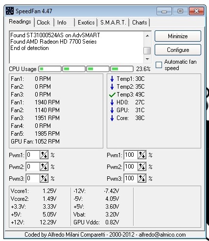

Here we go.

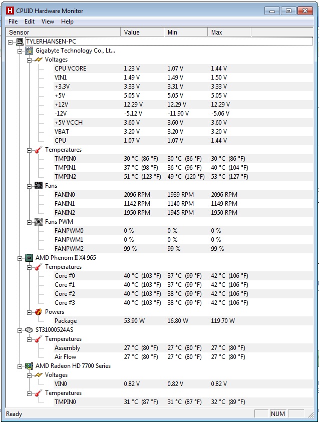

Also a screenshot from CPUID HWMonitor.
The problem is not heat or voltages. What about the chkdsk?

According to the readings you posted your PSU is working perfect.
