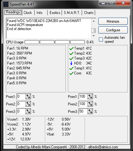

Download Speedfan and install it. Once it's installed, run the program and post here the information it shows. The information I want you to post is the stuff that is circled in the example picture I have attached.

i did what you told me and was watching the program for a few minutes and it kept on fluctuating
especially when i instaled a driver for a wifi adapter i heard and watched the fan go wiled as the numbers went up by 2-3 and then dropped back and gave me a check.

Speedfan is showing your system temps + the +5V and +12V rails on the PSU as being good but the +3.3V rail on the PSU is reading as being low (see attachment below) the +3.3V rail provides power to memory and PCI slots etc and may explain the issues that you are having, as I said earlier it may be necessary to run another program to compare the Speedfan results to, can you run HWMonitor for us and again provide us with a screenshot of the results http://www.cpuid.com.../hwmonitor.html

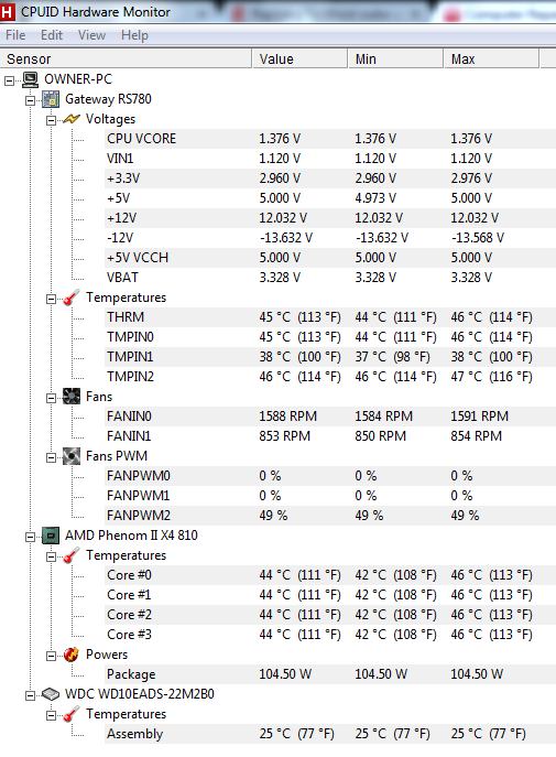

im attaching the screen shot here.
and yes i did set up the pc for now that it shouldn't sleep or hibernate and that the harddrives should always stay awake. now if indeed i do have a PSU problem can i switch the one that inside to another (i took apart every part of a PC except the PSU, idk the closed box seems like it don't want to be touched, lol) ?

HWMonitor is also showing the +3V rail on your PSU as being low and would seem to confirm the Speedfan results but before you go to the trouble and expense of replacing the PSU I would recommend one further test which I will come to after addressing the information in your last reply which is most helpful thank you.
