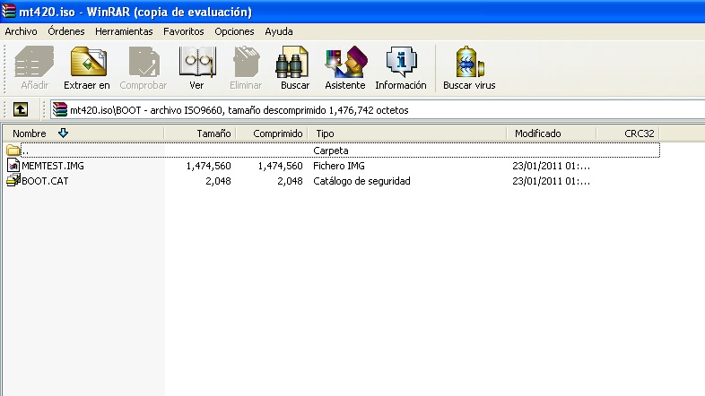

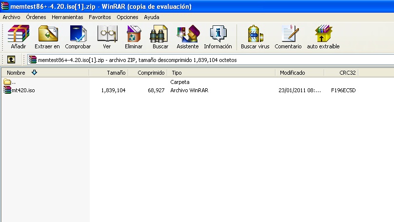

I guess this is the ISO file that I should not to burn
But this
where the BOOT folder contents the files that are going to do the job. I will make the memory test and feedback.

You want exactly what my previous post stated: Download - Pre-Compiled Bootable ISO (.zip)
Then use the .iso as input to a burning program like ImgBurn to create the bootabel CD.

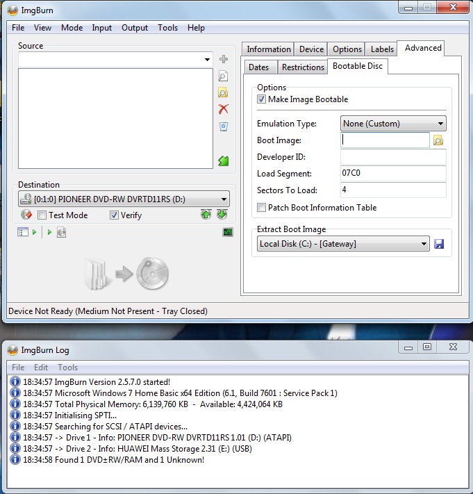

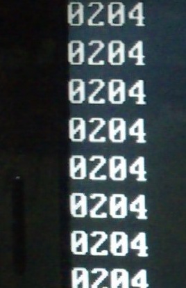

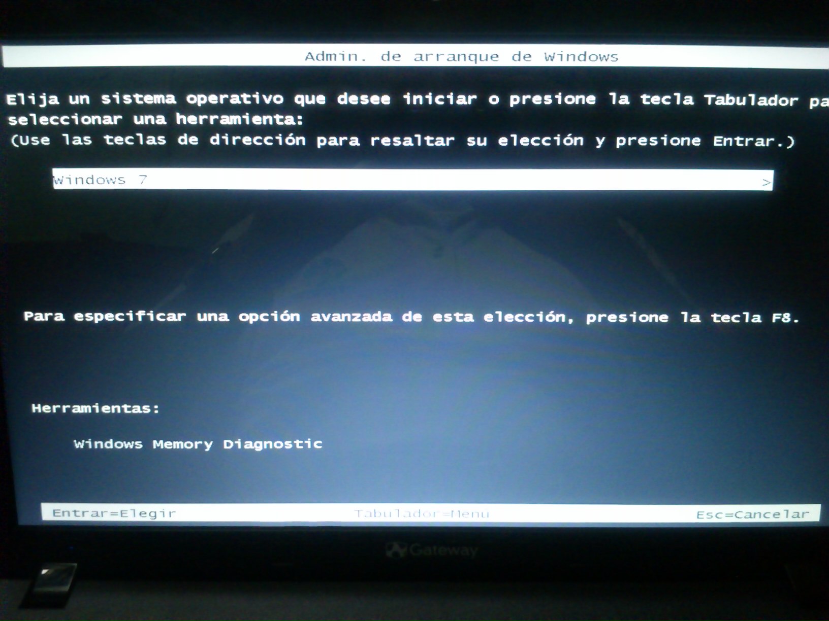

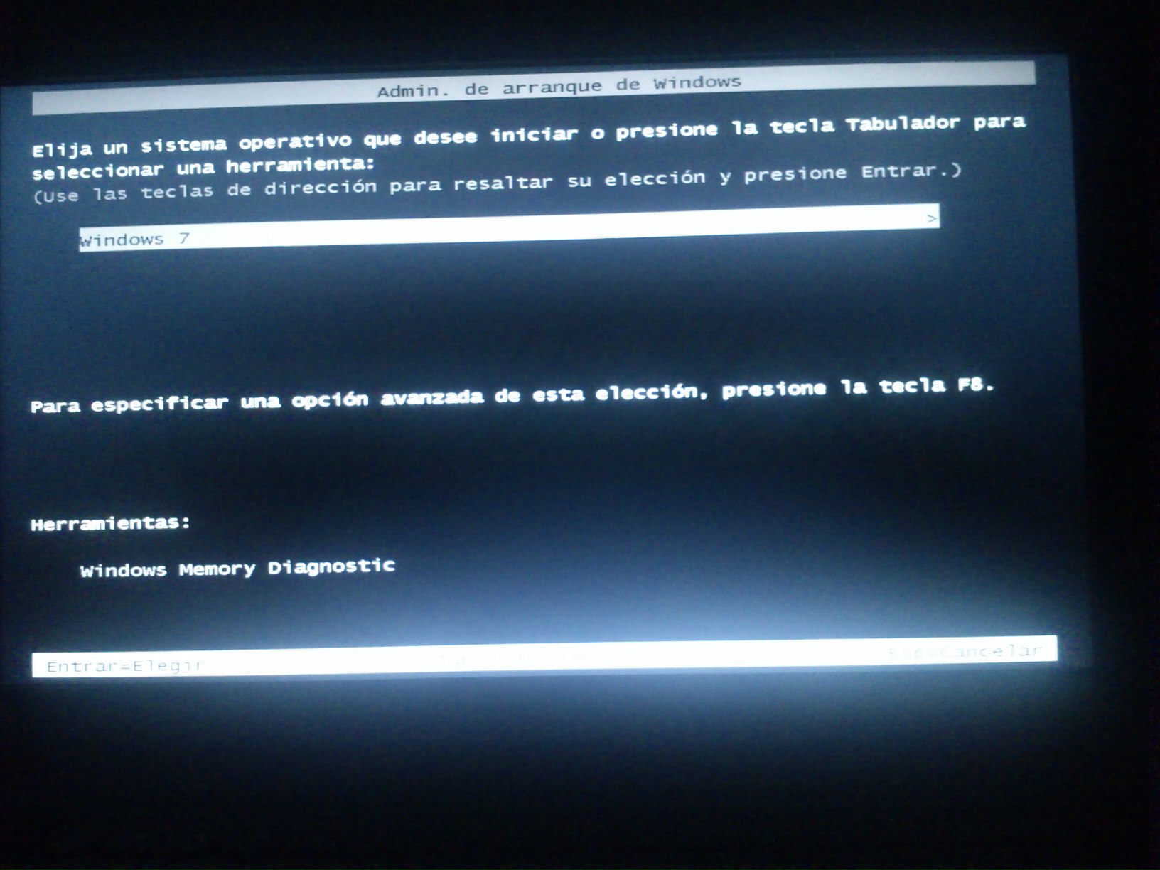

For sure I´m making some mistake, because I could not make a bootable disc using ImageBurn to use memtest. Perhaps I´m missing some files to make the disc.
In the "source" window I add the folder unzipped and go on the ImgBurn process, until a window appear "process complete" or something like that. When starting windows a black screen like this appears, the lap starts beep over and over.
I´m making something wrong, the blue screen of memtest does not appear, but always I start windows it asks to make a memory test

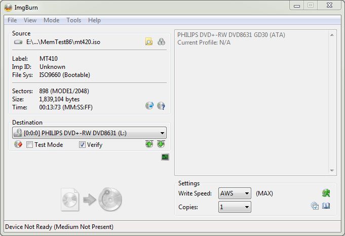

You downloaded memtest86+-4.20.iso.zip.
You unzip it to get mt420.iso.
Start ImgBurn, point to mt420.iso (you do not unzip or extract it's contents).
Output is your CD/DVD burner with a CDR or CDRW disc in it.
Click the Write symbol at the bottom..

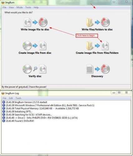

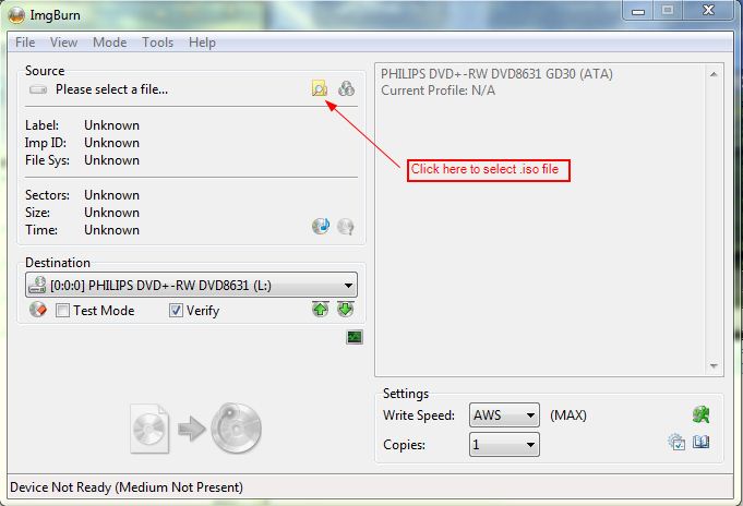

This is what ImgBurn windows look like to me. They don't match what you show so I'm not sure what you have.
Output will be a CDR or CDRW disc.
Try downloading ImgBurn from here: http://www.majorgeek...faa3374cb1dcd89

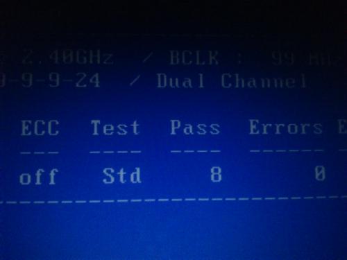

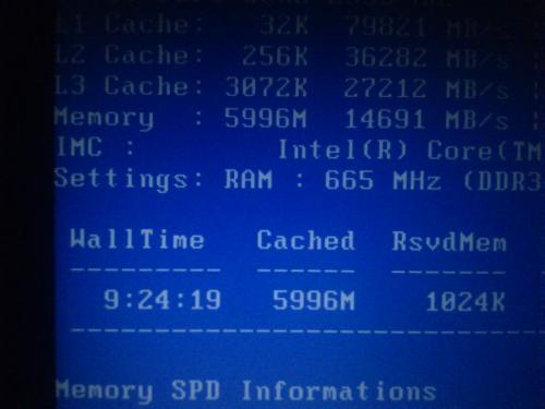

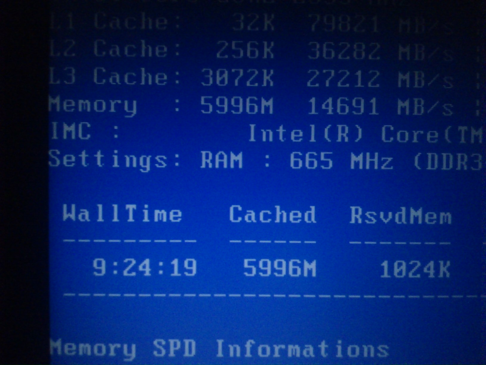

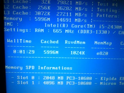

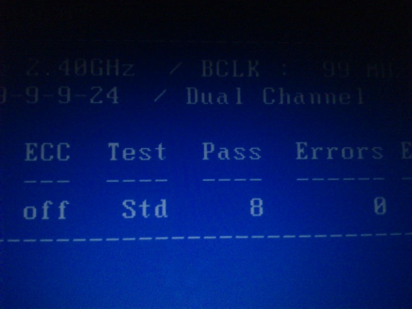

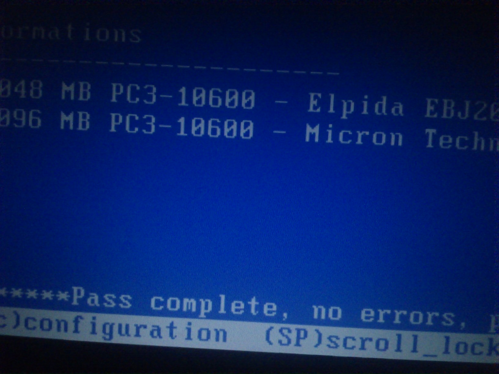

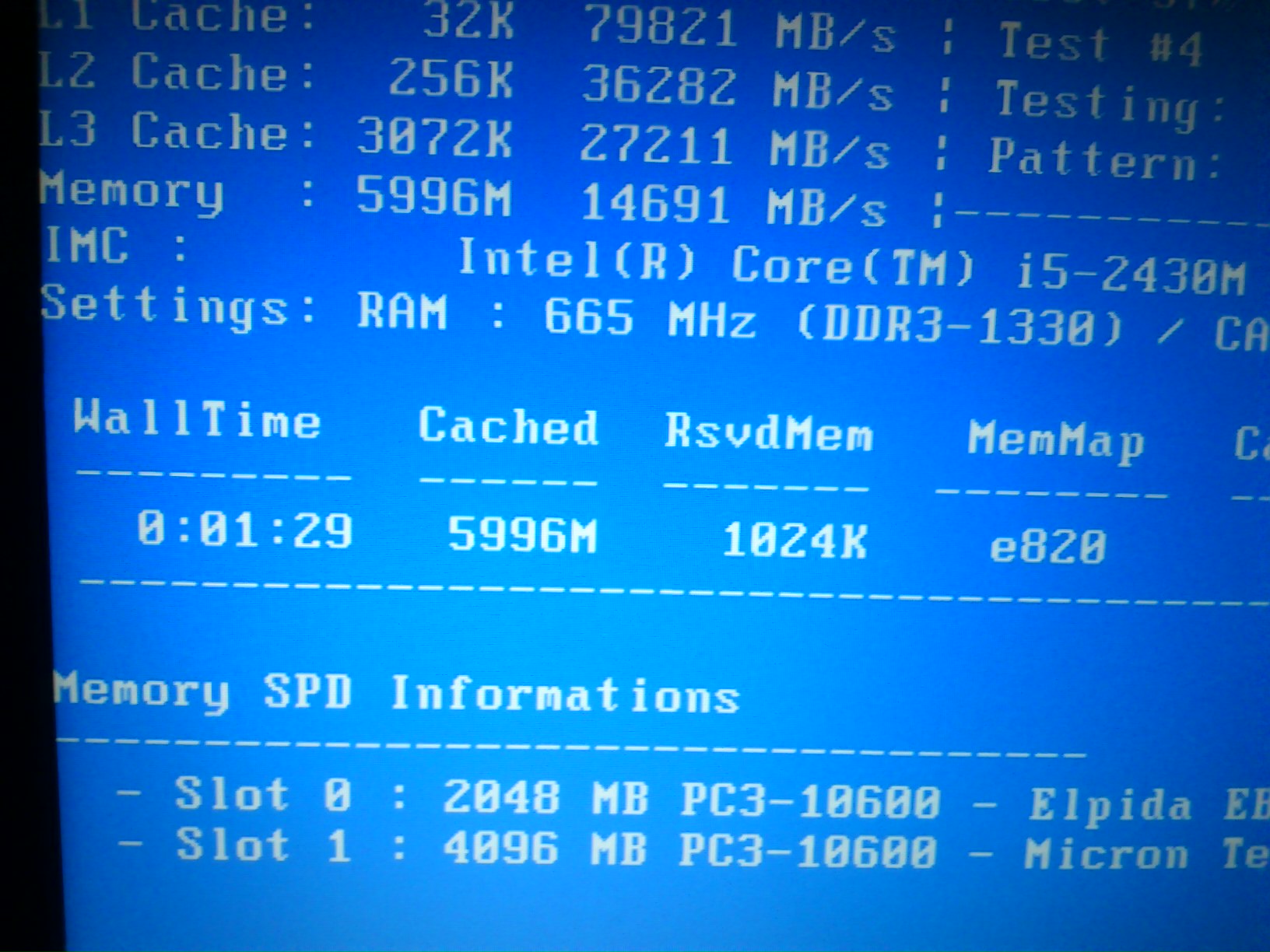

Memtest results gave no errors after nine and half hours of overnight analysis as shown in the attached pictures.
This morning I found 8 cycles finished but no errors. Then restarted windows and the same menu appeared asking for memory diagnostics. Assuming RAM is OK ¿something else could cause all the problems?

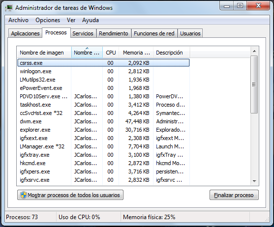

I absolutely agree with you regarding a hardware issue since the factory-state was already done. Anyway just for the record, the problems of popups asking files and icon deletion were stronger after typing Ctrl-Alt-Supr to call the task administrator. This is not the case now and I don´t know why. Here you can see the window of the task administrator, some processes with no description are shown just in case some strange things could be noticed.
