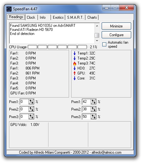

Download Speedfan and install it. Once it's installed, run the program and post here the information it shows. The information I want you to post is the stuff that is circled in the example picture I have attached.
Depending on the results we may need to run further software for comparison.

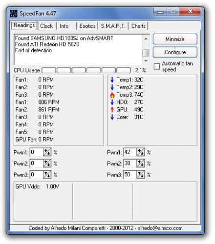

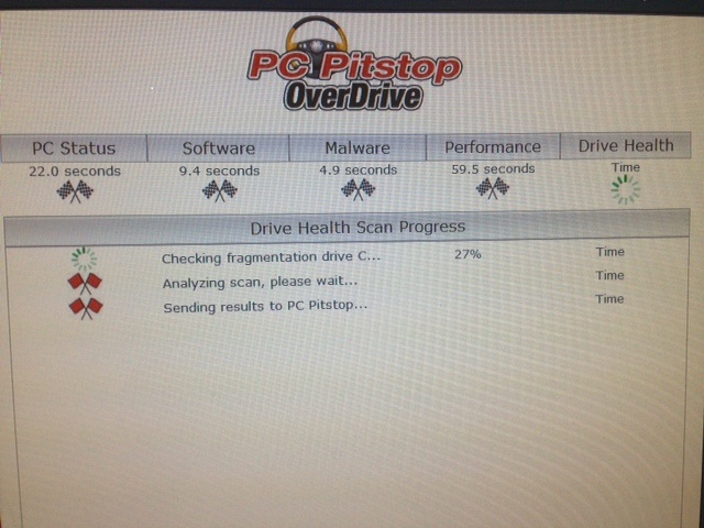

Thanks, Phill for the help. Here's what's happening. I have been able to run the SpeedFan program and have attached the screen shot. I am running into a problem with the PCPitStop website. I have tried to run the OverDrive Tests a few times and the computer keeps locking up before I can complete. The weird thing is that it always locks up at the same spot. It locks as it is scanning the Drive Health Section and Checking Fragmentation in Drive C. It locks up at 27% four times in a row. Three times running the my computer regularly and once in safe mode. I thought it was kind of weird that four times it locked up at 26%! That said, I've attached a pic of what the screen looks like when it locks (I took it with my phone). I also attached the link to the partially completed test below. Thanks again for your help!!!

There are a couple of things of note in the test results but due to the problem checking the HDD I would suggest that before we proceed further you back up any important data on the HDD as a precautionary measure (in case of HDD failure) once you have done this or if there is nothing on the HDD that you wish to keep let us know and we can continue.
