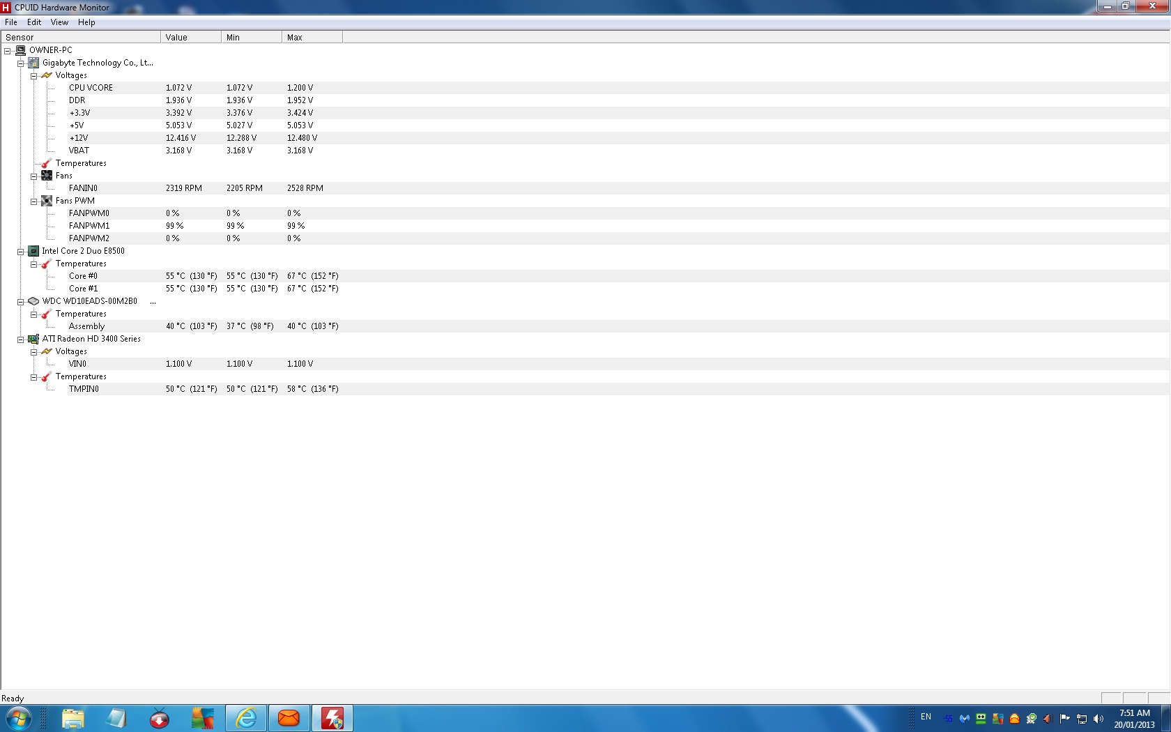

Lets take a look at your voltages by doing the following instructions.
Please download and run Hardware Monitor
Installation (setup version only)
HWMonitor is a hardware monitoring program that reads PC systems main health sensors : voltages, temperatures, fans speed.
The program handles the most common sensor chips, like ITE® IT87 series, most Winbond® ICs, and others. In addition, it can read modern CPUs on-die core thermal sensors, as well has hard drives temperature via S.M.A.R.T, and video card GPU temperature.
Ricky_22
Ricky_22
  • 349 posts
as the other file was so long, although I have posted it, I attached it also ,so that it's more clear, hope I did the right thing there - file titled Hardware Monitor,jpg

Many thanks
Ricky

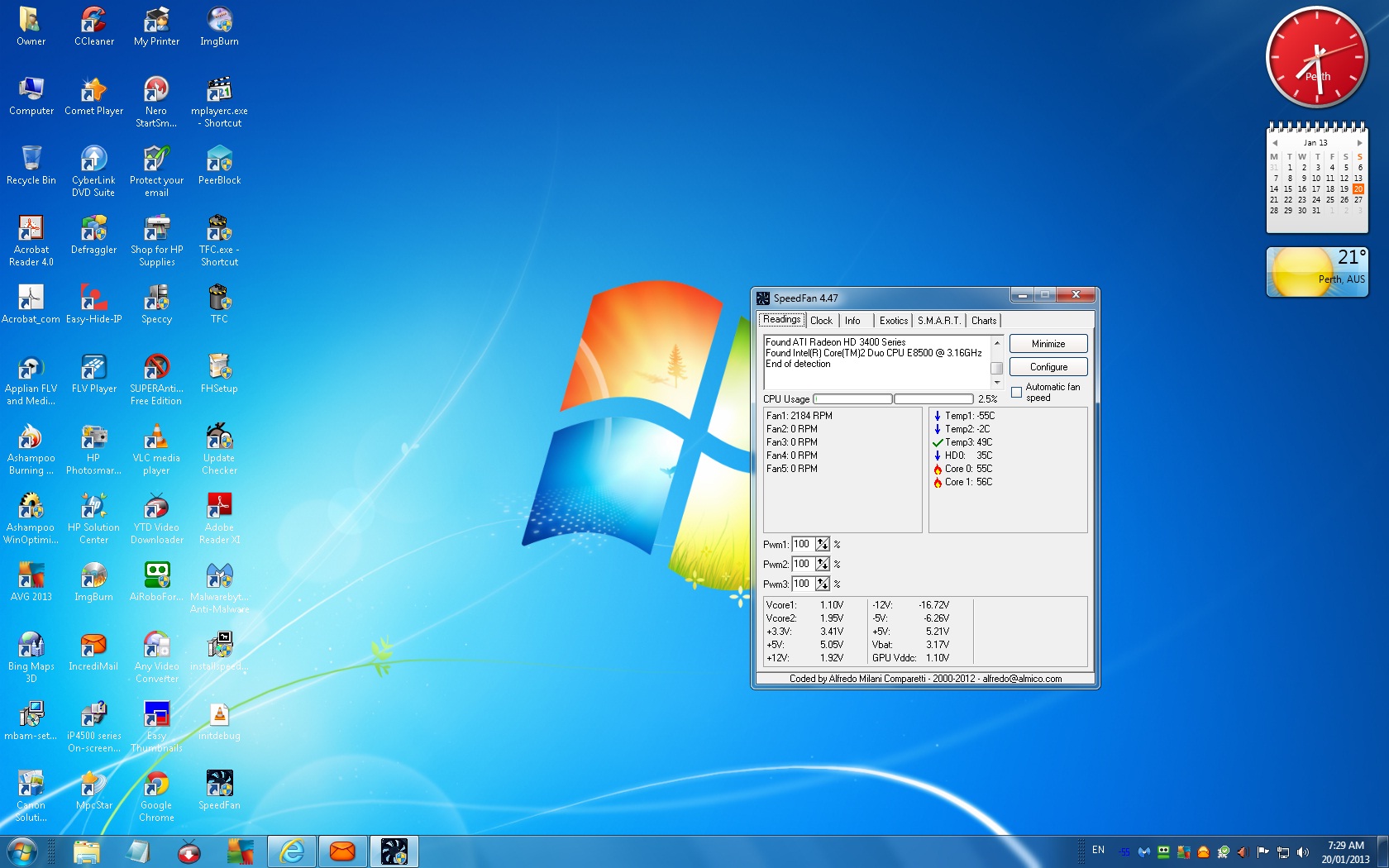

Yeah speedfan shows a possible problem with the +12 volt rail but hwmonitor shows it as being good. I am more inclined to believe hwmonitor's readings.
