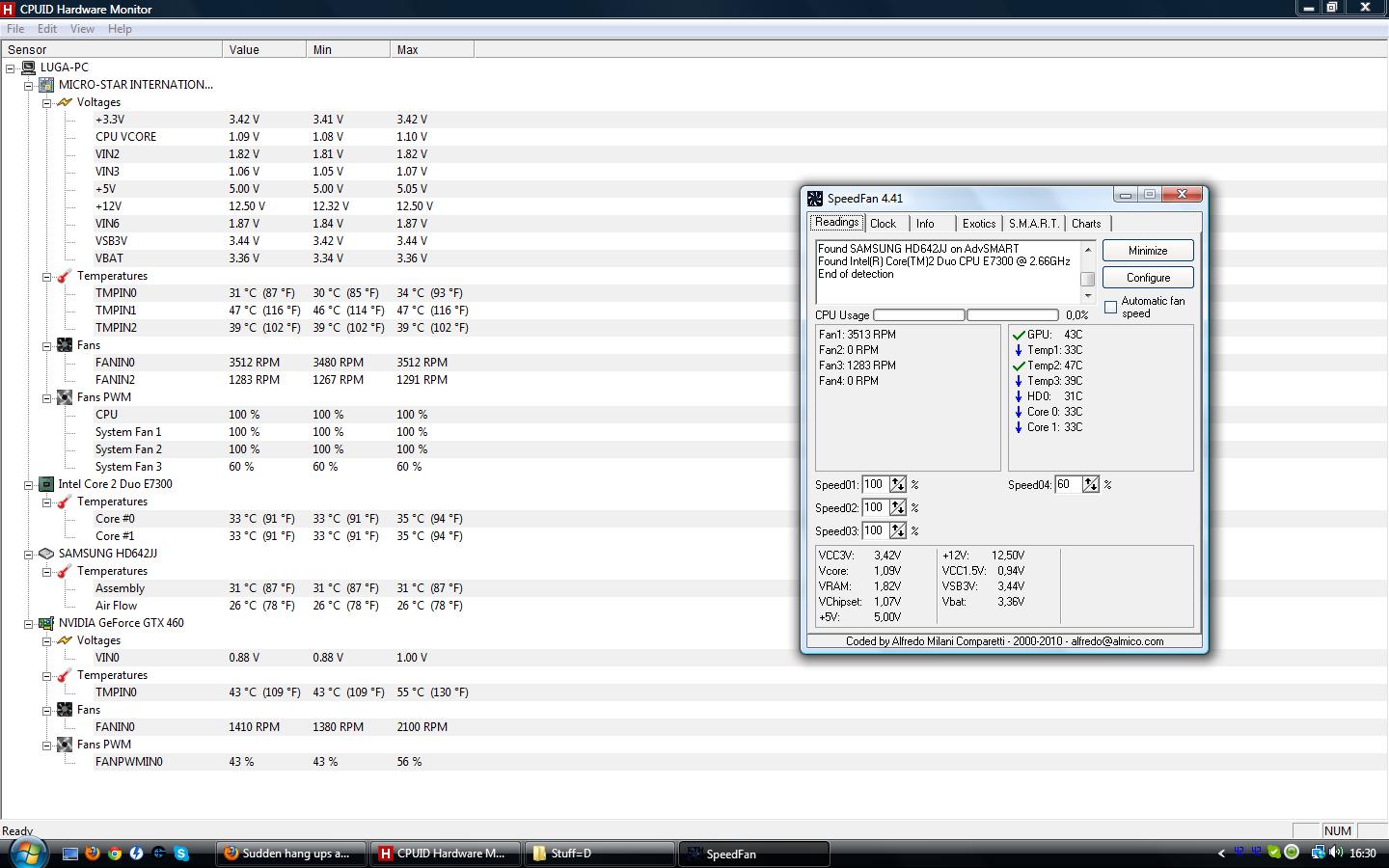

Next run Speedfan and post a screenshot of the results for us;
Download Speedfan and install it. Once it's installed, run the program and post here the information it shows. The information I want you to post is the stuff that is circled in the example picture I have attached.
Depending on the results we may need to run further software for comparison http://www.cpuid.com.../hwmonitor.html

  • 136 posts
GPU was at 55 when I opened Speedfan but I opened a window cause the room was hot and it cooled a bit and closed it again and now it's back at 56.

  • 25,117 posts
Temps and voltages are good in both programs :thumbsup:
If you have not done so already I suggest you back up all important data on your HDD as a precaution, use a HDD monitoring software that will warn you of potential HDD failure (free) http://www.acronis.c...nitor/#overview
