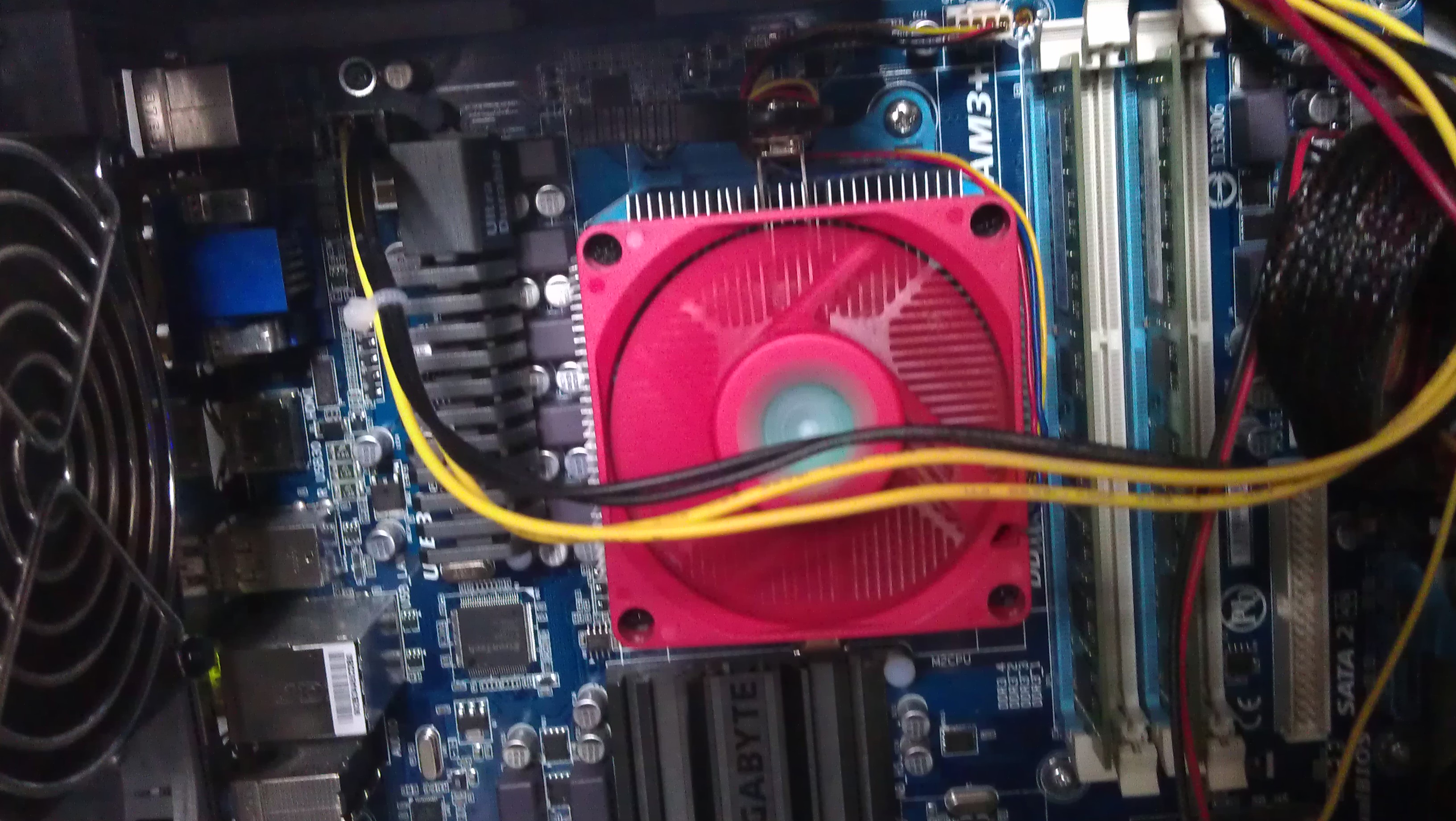

hello
I have converted all my cables and access in my pc to blue but i still have this horrible RED stock CPU fan. The question is how do i measure it to get a new fan, is it side to side or like tv's corner to corner? and any suggestions on what type of fans i should be looking at?
my mb is a GIGABYTE GA-78LMT-USB3 AMD 760G and the processor is a AMD FX 4100 4ghz

You do not need to measure the CPU cooling fan unless you have limited space inside the case, if this is the same computer as the one at your earlier topic then what you are looking for is an AM2+ CPU cooling fan http://www.geekstogo...08#entry2308608 These fans can be quite expensive BTW and especially blue ones, how about a neutral colour or black/white but no red.

i was kind of hoping that i didnt have to swap out the heat sink aswell as im not too keen on putting new heat putty, not too sure how to do it properly to be honest.
pics of the cpu space

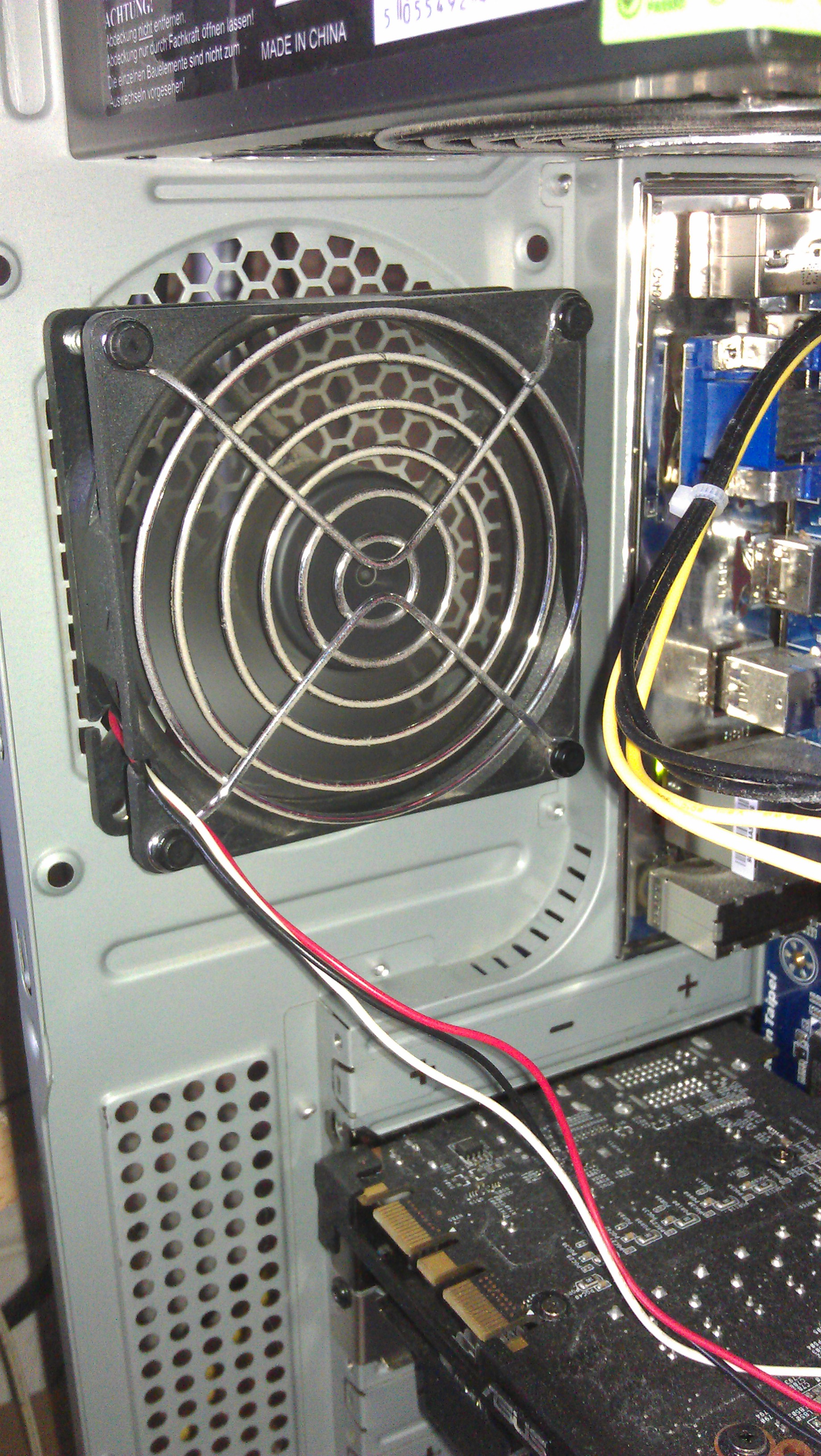

and this is a pic of where i would like to put an oval exhaust fan but need to know how to measure what size i need?

For the CPU cooling fan you could purchase a HS that has a detachable fan like yours, example http://www.ebay.co.u...=item35c8fada61 finding a fan on it`s own is proving difficult but I will keep looking.

Not a stupid question at all and in answer to your question as long as the screw holes on the fan correspond with those of the HS yes you could use one (there is a but though) the direction in which the air is pushed or pulled depends on the heatsinks own fitting instructions as they are not all the same, put the fan on in the same orientation as the present red one and you cannot go wrong, now the but part, keep in mind that the CPU fan will have either 3 or 4 pin connections so as to monitor the CPU temps and RPMs of the fan and any replacement fan needs the same to keep a check on CPU temps etc.

I am a little concerned with using a case fan as im not sure they have the same RPM or at least enough for the use i give it, I play very demanding games for hours on end, and the last thing i want is for the processor to overheat, so i either need to get a new heatsink with fan and get the guts to fit it correctly, or just hope that i can get a fan that will fot my current sink, but how do i measure what size fan i need?

The crux of it is that you would be far better to purchase a new heatsink and cooling fan that is specific to your CPU as it will have a guarantee, have a pre applied thermal pad on the HS + be 100% compatible.

Looking at the pic of your rear exhaust fan, it appears to be too small as it does not covers the perforated back vent holes. measure across the top two screw holes.
Visible are three slightly protruding screw holes, two at the top and one bottom left, measure across the top two holes,,, then top left to bottom left.

The fans are measured across and up and down (not diagonally like a TV). The holes are what you are trying to match up, but the actual dimension of the fan will be a little bit more because it is measured edge to edge. You may also need a depth adjustment if you are limited on space in the cabinet (this is usually not a problem).
All fans will have a tag with voltage amperage, and rpm on them to assist in matching them. Exact fans are becoming difficult to match on older CPU's. I had to retrofit one on my CPU. I couldn't get the right depth nor longer screws to mount it.
