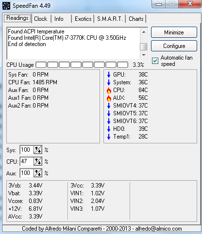

Download Speedfan and install it. Once it's installed, run the program and post here the information it shows. The information I want you to post is the stuff that is circled in the example picture I have attached.

Here is my results from speedfan
I have a atx-500 500w power supply. Also bare in mind that it is 2 or 3 years old

Things of note in Speedfan are the high CPU and AUX temps, the voltage readings are inconclusive + you only have one fan speed reading (+ the GPU) - how many cooling fans do you have.
NB: Uncheck the Automatic fan speed box in Speedfan and see if the CPU temp comes down any.

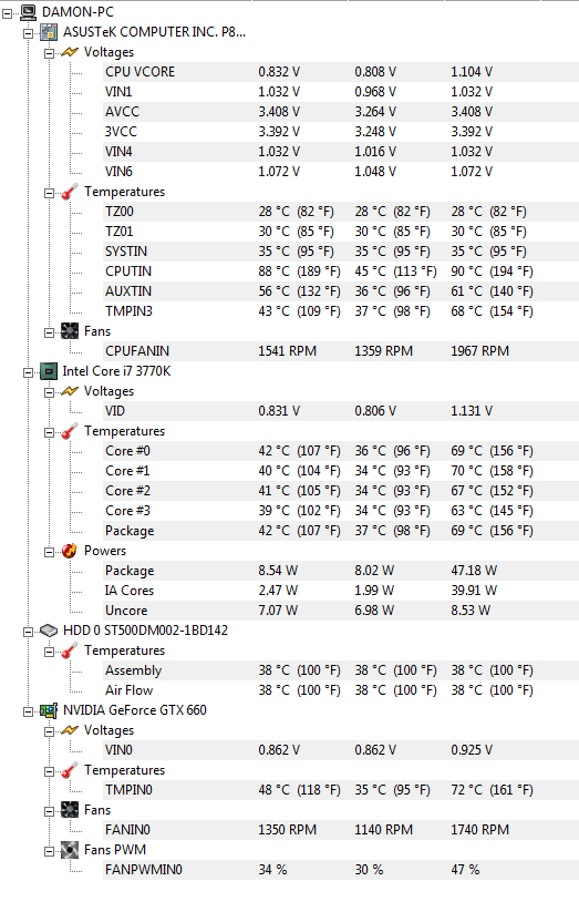

I have not yet checked the brand and model name of my psu but i have used a difference software to moniter my temperatures on my pc.
There are 2 pictures, one that is during no game is being run (cooler temperatures), and one that is during a game is being run (higher temperatures). Hopefully this will help.

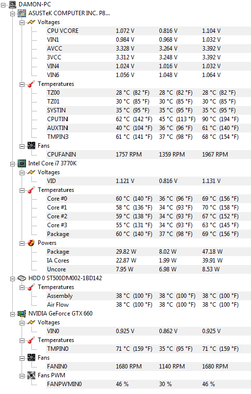

  • 25,095 posts
Have you done this.
