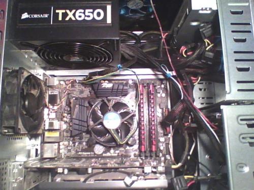

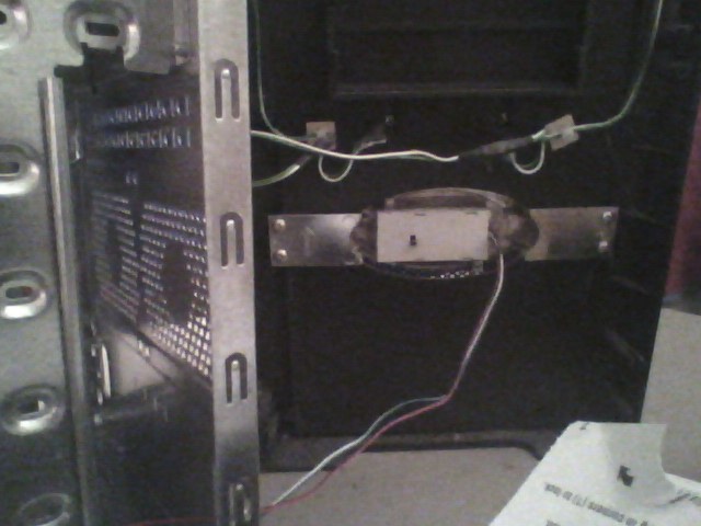

I took off the front cover of my case and found that you can in fact fit two fans in there for front mount fans. However, where the LCD temperature display is on the front has very minimal opening for airflow. I feel it will not be adequate enough to be done with the restriction of airflow. I did flip the rear fan to now blow out and rerouted all of my cables and made a LOT more room in the case.
Two things I learned today. One, the other side panel is simply screwed in and can be easily removed to access the space behind the motherboard which allowed me to better adjust and store the cables out of sight as much as possible! Two, the metal edges inside are VERY sharp and I actually have a few cuts now.
Anyways, Phillpower2, I feel everyone has the right to see the monster they helped create. All pictures were taken today, after I went inside and did everything stated above. Here it is!
Side panel before redoing the wires.
Behind the front panel where the LCD temperature display is, behind the spot for front fans.
All the wiring, redone. I now see the dust I completely missed on the rear fan!

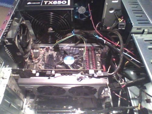

Zip tied and neatly as possible placed wires stored the expansion bays.

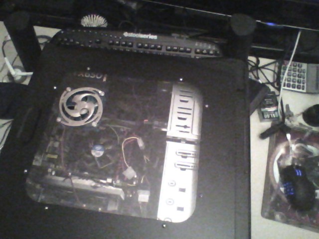

Better view of the hardware. See the fan at the top, that is the one I had to mount on the outside because the PSU was too long.
