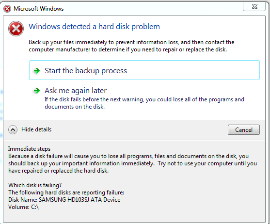

On saturday I got this pop up 'windows detected a hard disk problem'. (not my photo, but this is the same type of pop up) 110jihc.png
I googled and found a "fix" : TYPE gpedit.msc ON RUN. Navigate to Computer Configuration\Administrative Templates\System\Troubleshooting and Diagnostics\Disk Diagnostic...Double Click on "Disk diagnostic: configure execution level", set it to "disabled". "Not configured" is enabled by default.

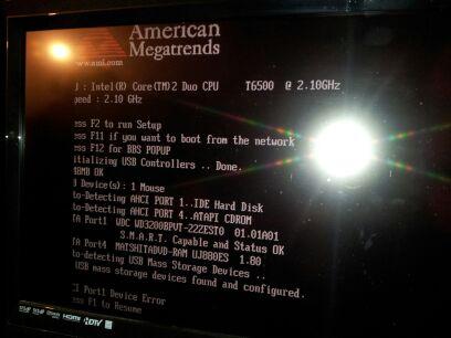

Sunday my laptop turned off/restarted and I got this error page that doesnt show up on my laptop, but shows up on my tv (hdmi connected) 20130819_184919.jpg
I noticed the "AHCI port1 device error" all the way in the bottom. I did some research, but would like to know any and all reasons why I would get this error...

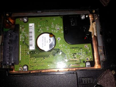

Extra info: On Friday night my laptop slammed shut fairly hard (it doesnt stand up on its own) I did open my hard drive area and noticed that the hard drive was crooked and being held by cardboard (not done by me).
20130818_194108.jpg This the hard drive that I straightened out, but laptop still shuts off.
20130818_194141.jpg This is for just in case you need it...

Looks to me like your hard drive is dead mate.
