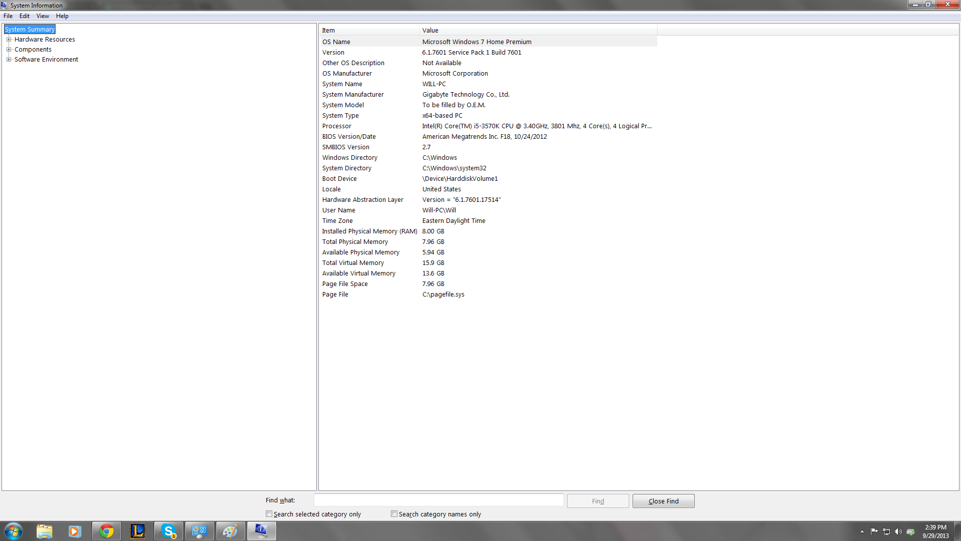

Custom Build
BOS error PFN_LIST_CORRUPT 0x0000004e (0x0000000000000002, 0x0000000000199800, 0x000000000021EFFF, 0X00000000000000001)
PSU 750W
GPU GEFORCE 670
is this sufficient?
