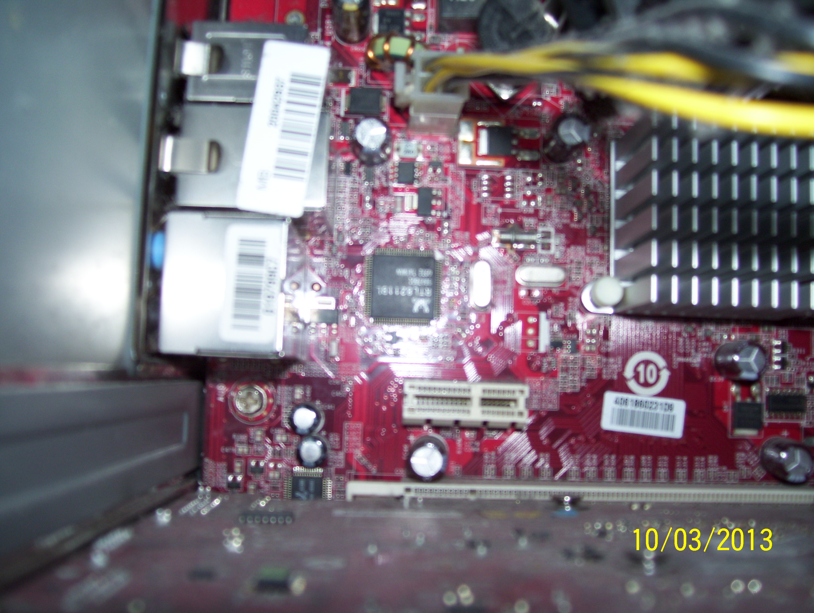

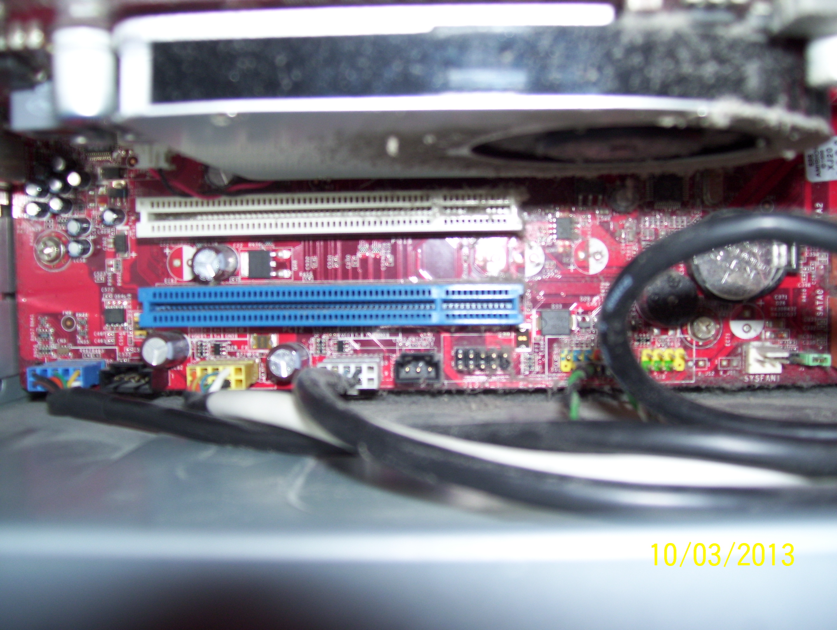

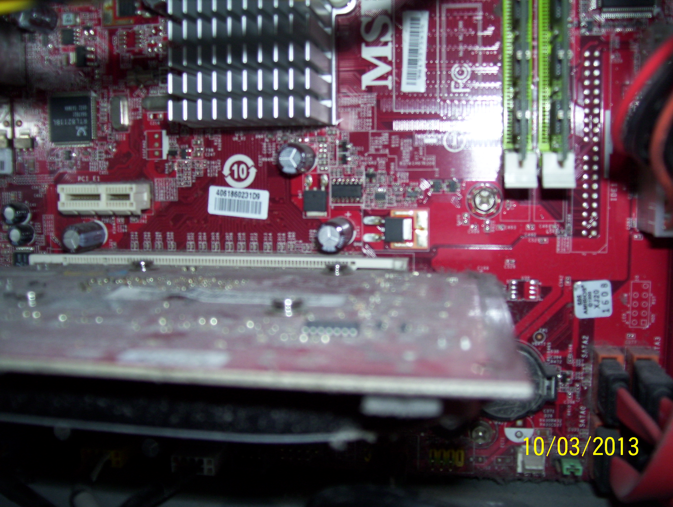

Cleaned fan but not much improvement PC shut down again but only playing online games.
Final pic in following post, pics are not great but that's the best i could do to get them into focus.
Regards coolsteel

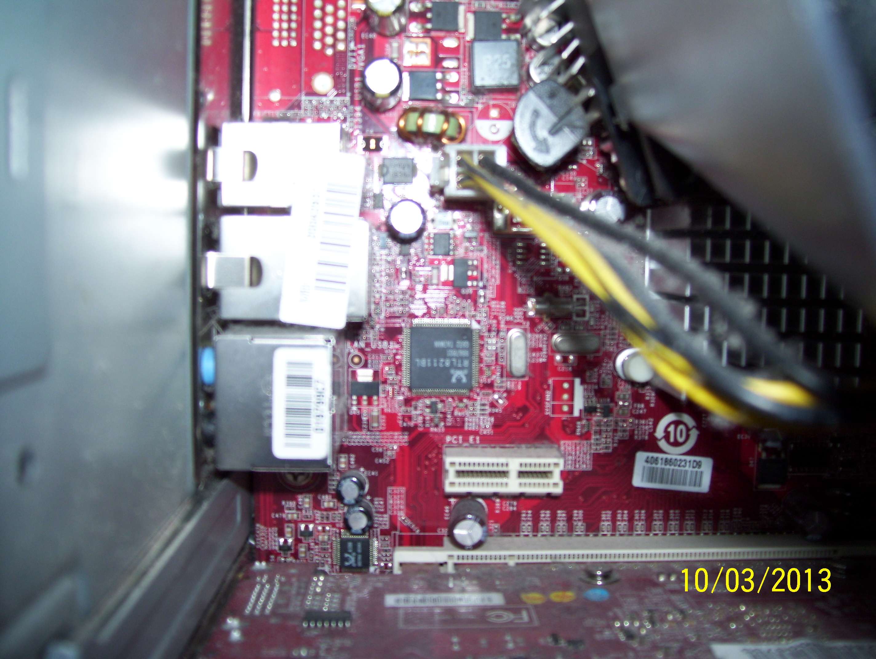

  • 74 posts
final pic

From what I see and can tell, they appear to be ok. Can you leave the side panel of the machine off and see if it makes a difference in the temp worth noting? Beyond that, can you also verify the other fans have been cleaned as well.
