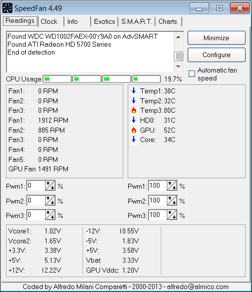

tonydaturtle
tonydaturtle
  • 8 posts
Thank you phill.

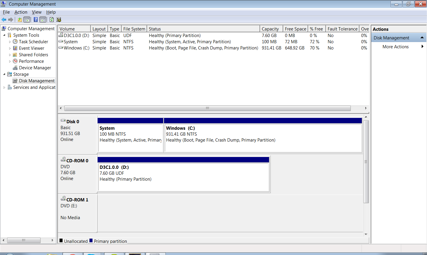

Here are the requested screen shots.
I also forgot to add the minidump files in my first post, so here it is.
Edited by tonydaturtle, 10 November 2013 - 01:10 PM.
  • 24,569 posts
Hello tonydaturtle
The HDD looks ok :thumbsup:
You have high temps and CPU usage showing for a computer that is not under load, has it ever been overclocked.

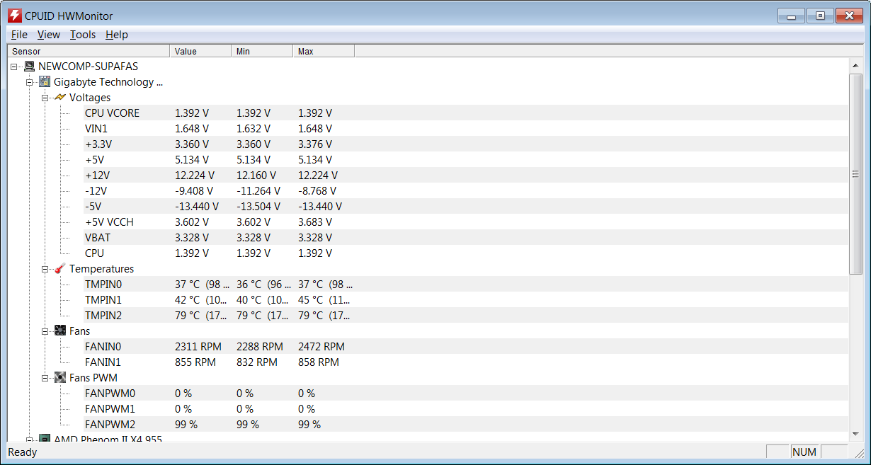

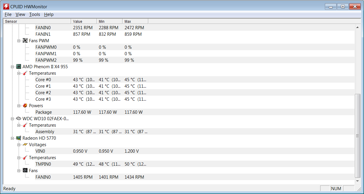

RunHWMonitor and post a screenshot for us to compare to Speedfan.

Oh sorry about that, the PSU is a 700watt XION and the model number is XON-700P12N.
And the HWN screen shots are as follows:

  • 24,569 posts
From my previous reply;
Can you answer this please.
The temp 3 reading is high again but it is difficult to determine from which item of hardware the temperature is from.
Voltages are ok.
