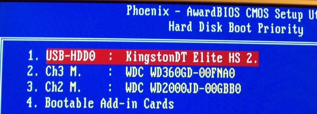

Now I wonder if there is now no driver on the machine to run the DVD drive, so I made a bootable USB flash drive with the Win7 iso. Of course, my BIOS doesn't seem to have a boot from USB option, and still no matter what I do I get the same Disk Boot Failure message.
In some BIOS the USB options only show if you connect the USB flash immediately after Power On the machine and enter the BIOS.
After this some bios will detect the Flash Drive as a floppy drive or Hard Disk Drive and in this case you need to search for the option to order the drives priority inside each category, like on the image.
