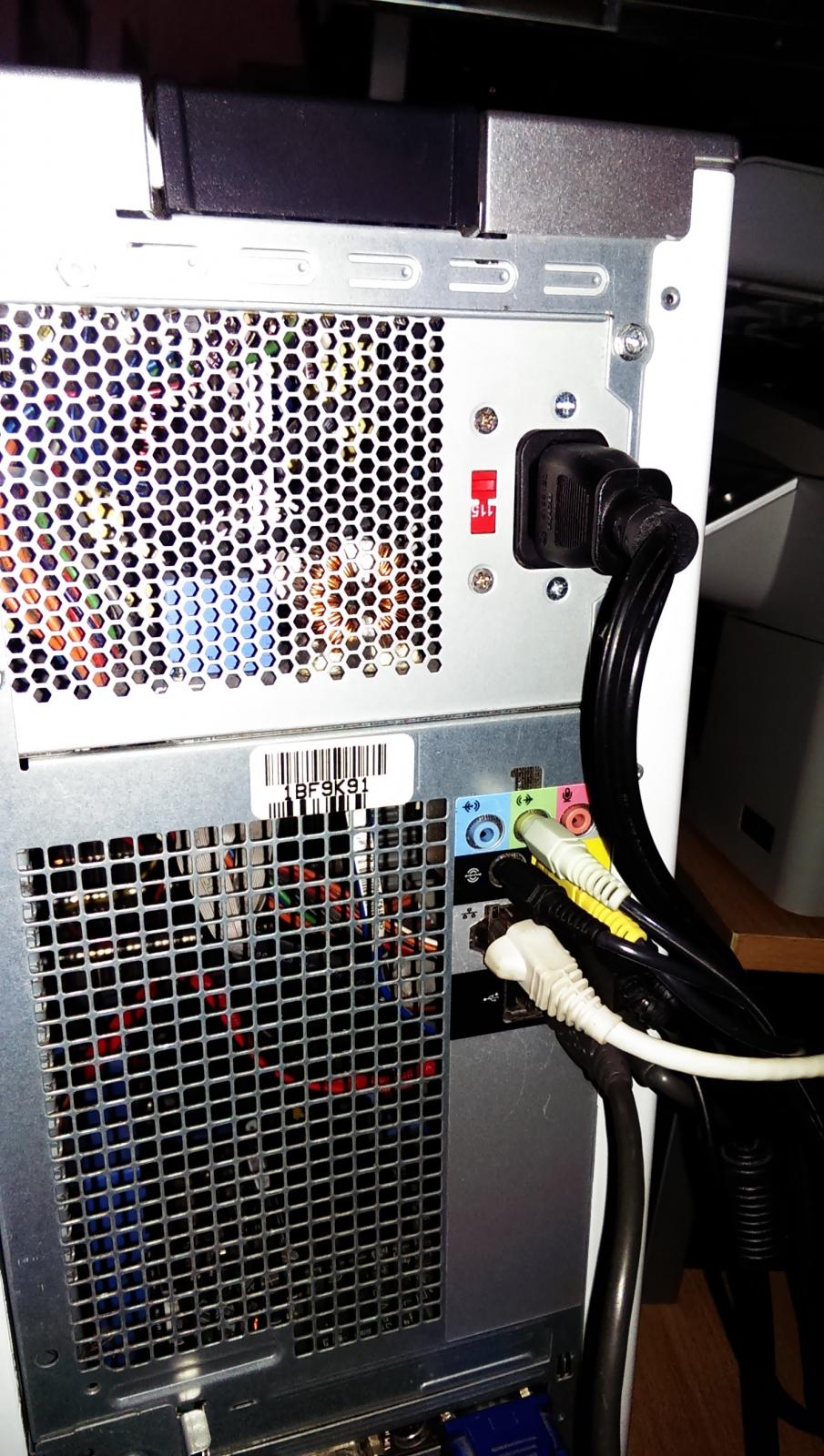

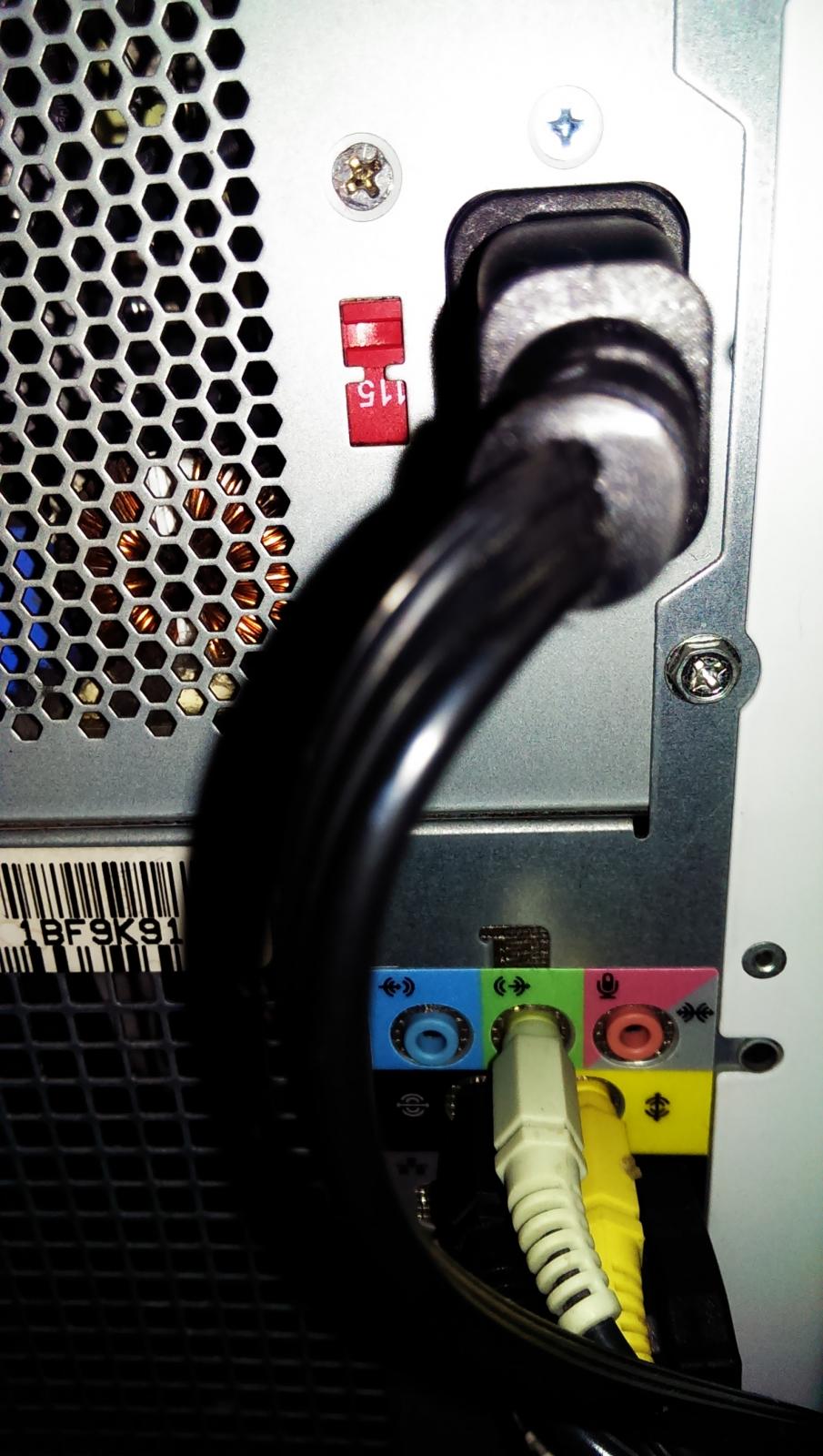

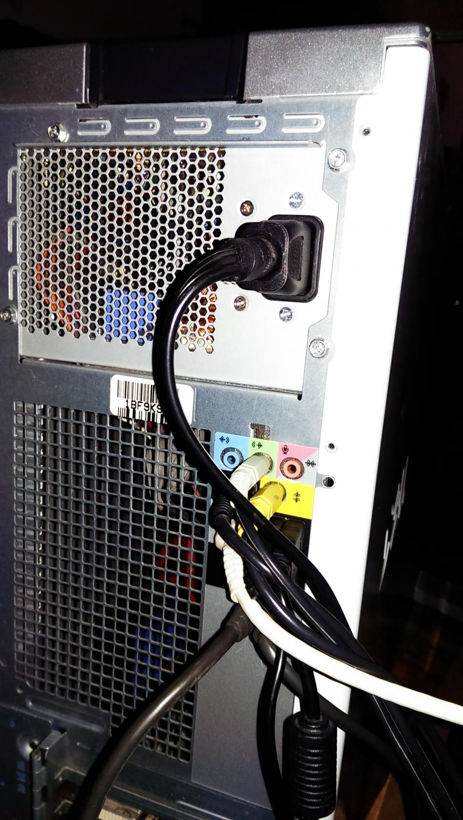

Can you do a photo of the back of the case
#513
Posted 30 May 2014 - 08:49 PM
Back of my tower??
#514
Posted 30 May 2014 - 09:26 PM
Yes please.

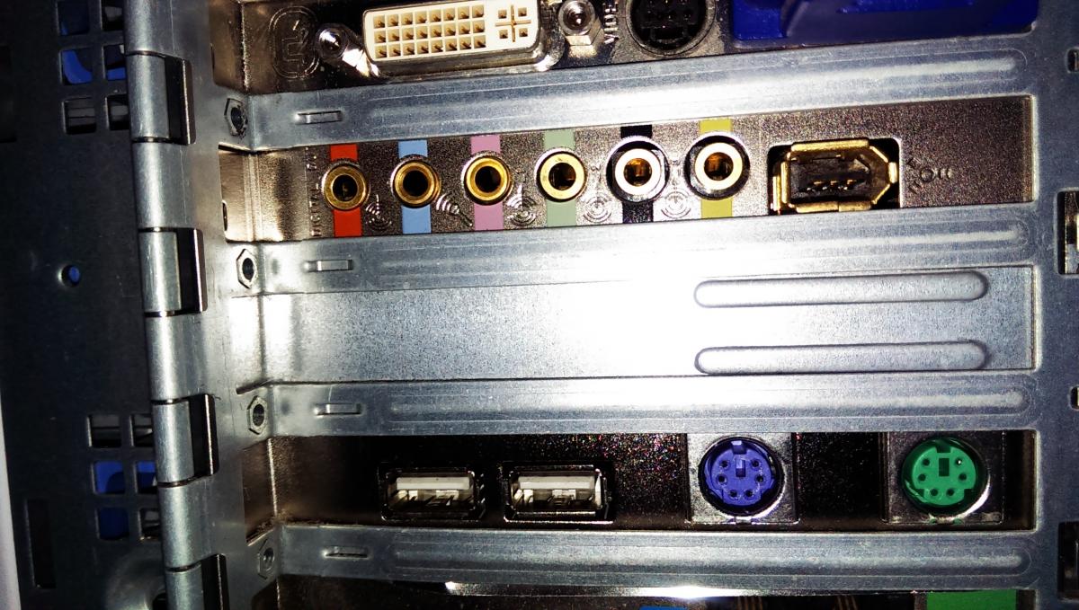

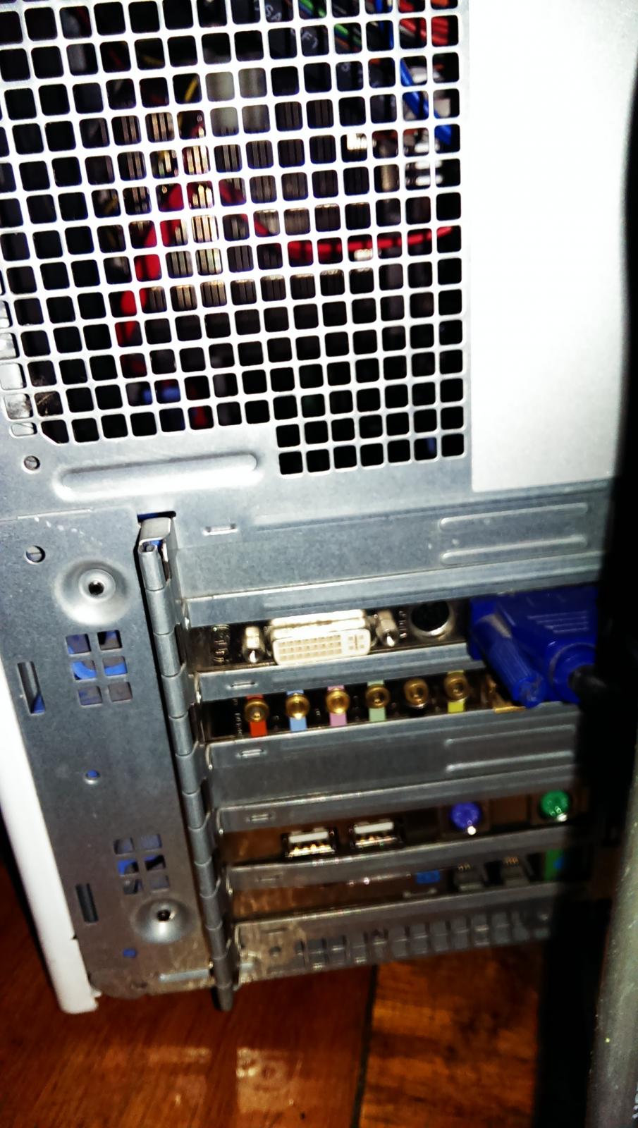

Gday Lexy.
If you look at the last picture, you can see a row of ports with coloured tabs, this is a sound card installed in a PCI slot.
Please make sure the computer is off. > unplug the speaker cables from the top ports and plug them into a matching coloured port on the sound card.
Turn on the computer.
If any Wizard starts, please follow the prompts.
Do you now have sound?

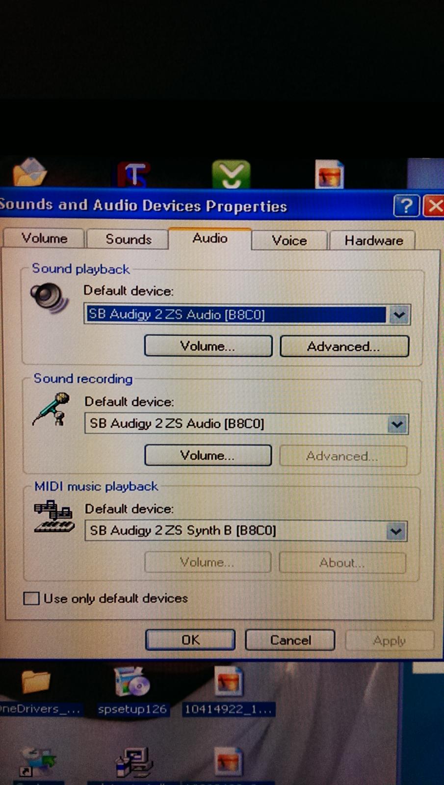

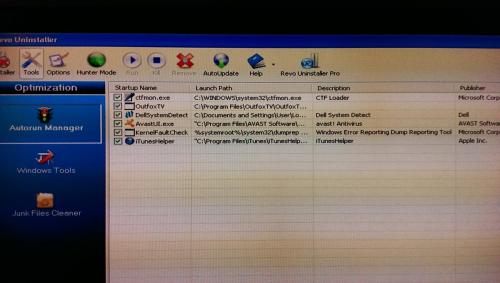

Gday.
Some preperation jobs.
Follow the steps on the image below, > restart the computer, do you have sound?
Start Revo Uninstaller, run full screen, > on the top menu, click Tools, in the left hand window that open, > click the traffic light icon.
In the right hand window you will see a list of the startup items. Please take screenshot/s so we can see all the whole list.

Posted 11 June 2014 - 08:18 AM
Red, Green, Black and Yellow
Some Creative Speakers denote the following colour codes for speaker connections:
Green: Front Left / Front Right
Orange: Subwoofer / Center
Black: Rear Left / Rear Right
Grey: Side Left / Side Right for 7.1 systems
Creative Sound Blaster Cards will have the following codes:
1) Line Out 1 jack (LIN_OUT1: GREEN):
Connects to Front Left and Front Right inputs on powered analog speakers or an external amplifier. Also supports headphones.
2) Line Out 2 jack (LIN_OUT2: BLACK):
Connects to Rear Left, Rear Right, and Side Right (only on 7.1 systems) inputs on powered analog speakers or an external amplifier.
3) Line Out 3 jack (LIN_OUT3: ORANGE):
Connects to Front Center, Subwoofer, Side Left (only on 7.1 systems) and Rear Center (only on 6.1 systems) inputs on powered analog speakers or an external amplifier.
#525
Posted 11 June 2014 - 08:41 AM
What are u asking me to do?
My apologies for not understanding
