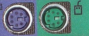

By chance do you have or can you get a PS2 kb and mouse?
It may be that if you can use a PS2 kb and mouse you can get into windows and then uninstall the last driver or drivers for the USB and then everything should work fine then.
#89
Posted 26 February 2014 - 09:36 PM
Hate to sound dumb but what is a ps2kb kb & mouse.
