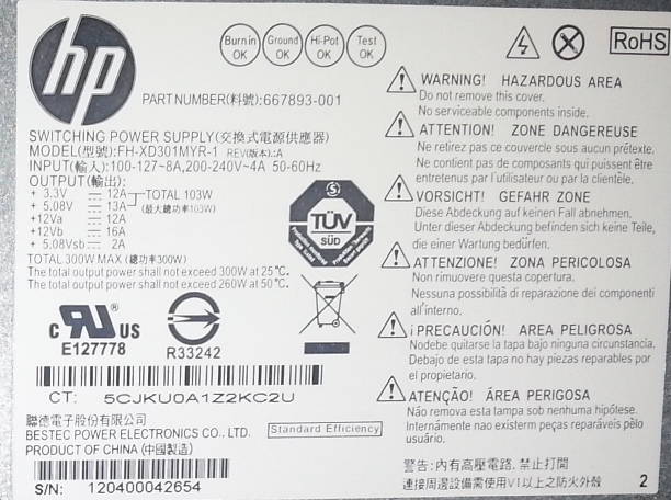

I've attached a photo of the PSU label.
Edited by Chucklebun, 16 May 2014 - 06:17 AM.

The PSU while not brilliant quality wise should be adequate for supporting your system (predominantly the HD 7570).
