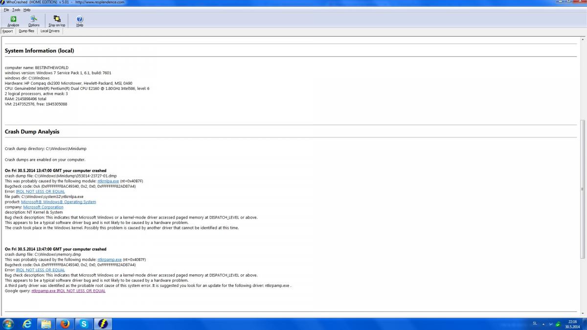

Hi !
When I go outside I usually put my computer in sleep mode. I did the same today. First I thought I hit a shut down button by accident when it has turned off but when I turned it on again later I got the message that Windows didn't shut down successfully but I chose to start it normally anyway. So I decided to check my computer with WhoCrashed and below are the results...
Thank you for your help in advance !

  • 25,095 posts
Hello Andro
Any further crashes.

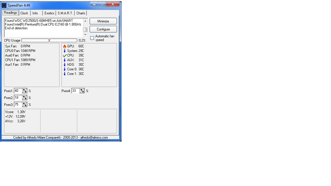

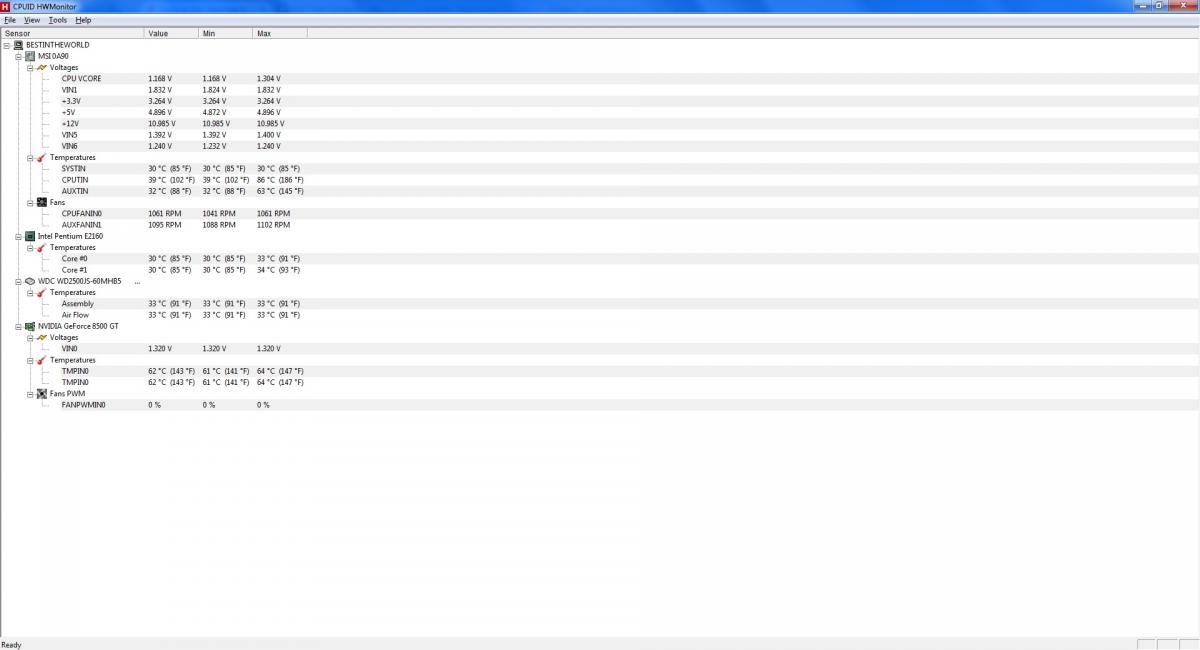

The one thing that I noted in your Speccy results is that the +12V rail on the PSU is low, this would cause the computer to blue screen so we should check it out first
Download Speedfan and install it.  Once it's installed, run the program and post here the information it shows.  The information I want you to post is the stuff that is circled in the example picture I have attached.
 Download then run HWMonitor and post a screenshot so that we have a comparison to the Speedfan results, details from here

  • 228 posts
The Stop code is 0x0000000A.
Yes my MB has an integrated video chip.

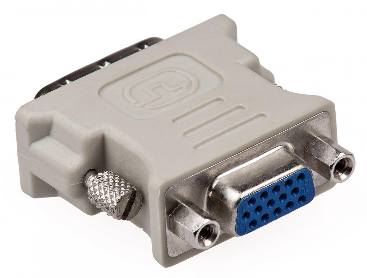

You do have an add on video card which is an 8500 GT but if you check the back of your case you may see a second VGA port as in the attachment below, again can you check this and let us know.

  • 228 posts
Don't worry...I understand that you don't have always time to be here :)
Yes this is the MB I have in my computer.
I see that VGA port but I can't use it because in this case I don't have a picture on my monitor so I'm using VGA to DVI adapter and it looks like this...
