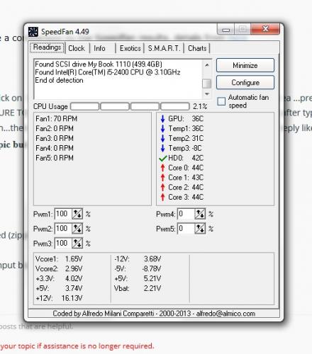

Download Speedfan and install it.  Once it's installed, run the program and post here the information it shows.  The information I want you to post is the stuff that is circled in the example picture I have attached.

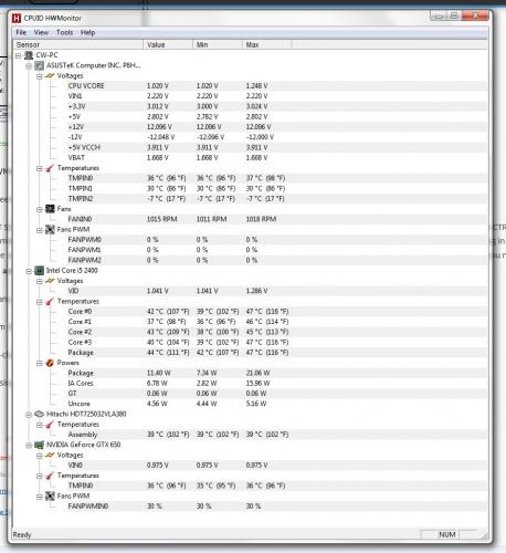

 Download then run HWMonitor and post a screenshot so that we have a comparison to the Speedfan results, details from here

Here is what you asked for.  There was only one dump file so that is all there is in the zip.
*Note: The Speedfan temp values alternate from green check 37 to the red arrow 44 as I was monitoring it.  About half of the time they are green and vice versa.

Your PSU readings are out of wack, the CPU is getting hot + there is only one cooling fan reading which is at 70 rpm, post the requested HWMonitor screenshot for us while I check out the crash dump.

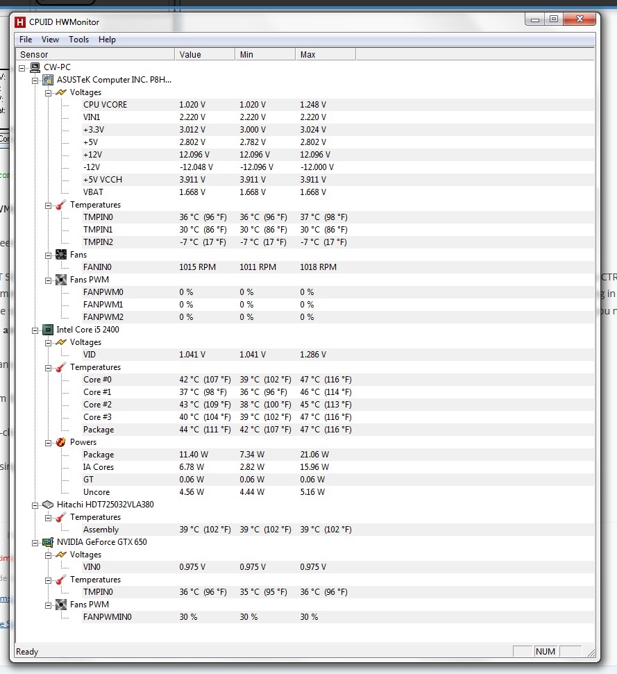

HWmonitor

HWMonitor also shows that the +5V rail is low, not only does this supply the video card slot but also the HDD, see attachment below, your crash dump suggests issues with the HDD (see below) with one of the possible causes being related to a bad PSU.
