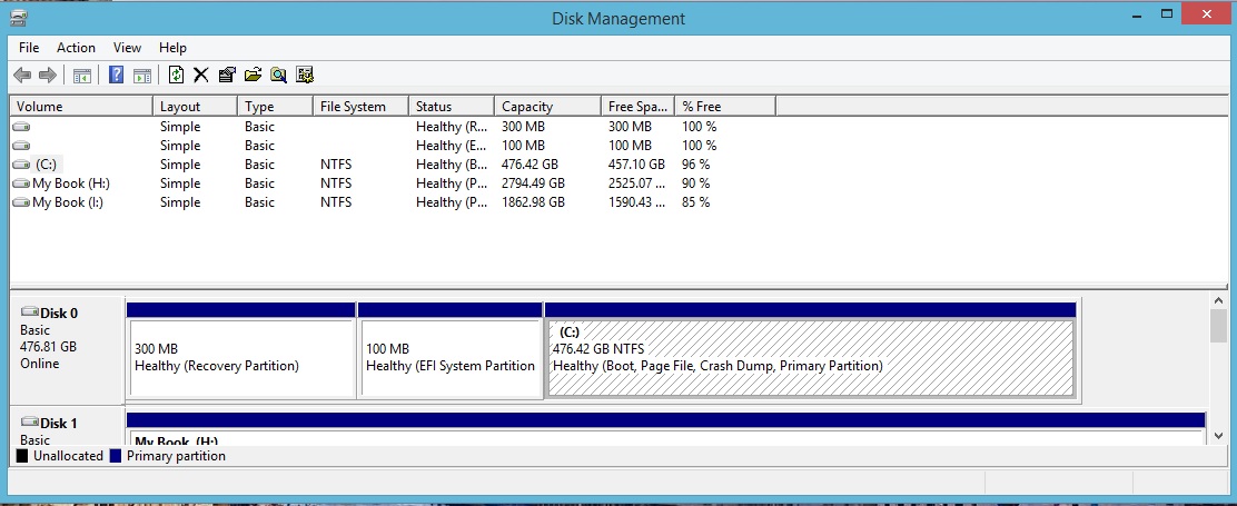

About a few weeks back i bought a SSD it is a 512GB and i did a clean installl of Windows 8.1 Pro 64bit on it.
Recently i noticed my BIOS Mode is UEFI. Before this upgrade to the SSD i had a 2 WD 1TB HDD and it was in Legacy Mode then.
I know i made no changes to my BIOS, before or during this upgrade to the SSD.
Just wondering what made this automatically do this, change to UEFI.
I know the BIOS shows EFI, when accessing it.
If i go into the BIOS my boot order is UEFI BOOT MANAGER, Crucual SSD, External HDD and then DVD Drive.
Somone else told me this.
If your BIOS is set to work for both: UEFI+MBR then you can install in either style.
When you did a fresh install. From the Installation disk, you have the choice to install using GPT style or MBR style and apparently you selected GPT style.
I attached an image from Disk Management that shows 3 partitions, usually only 2 for Windows 8.1, one for recovery one primary.
What i want to know is, that it is o.k. to leave it this way or not, most benefits for this is faster boots, secure boot (which mine does not support) HDD over 2TB.
Although from the screen image it does noy say the type is GPT,as another person told me it would be.
This is something i read about Windows detecting UEFI, possibly doing a GPT style later. Similar to how i did mine with just a DVD of Win8.1, but mine was originally set to Legacy mode.

I wanted to know is it best for me to stay this way, i know now i can go back to MBR. And with Windows 8.1 Pro 64bit
Yes stay with GPT and UEFI
MBR cannot boot from a GPT partitioned drive
As you have found UEFI boots from the FAT partition on a GPT disc
that is the UEFI Boot Manager
To go back now to MBR you would have to re-install you cannot simply enter UEFI and change to MBR - legacy mode - if you did Windows as it is now installed will not boot
Even without secure boot,  and I am surprised if the motherboard is UEFI firmware that secure boot is not supported, UEFI still enables ELAM - early launch anti malware, which is inherent in the included Windows Defender but is also possible in all the major 3rd party antivirus providers.
This means in simple terms that the AV is active in the boot process rather than only on the completion of windows loading
