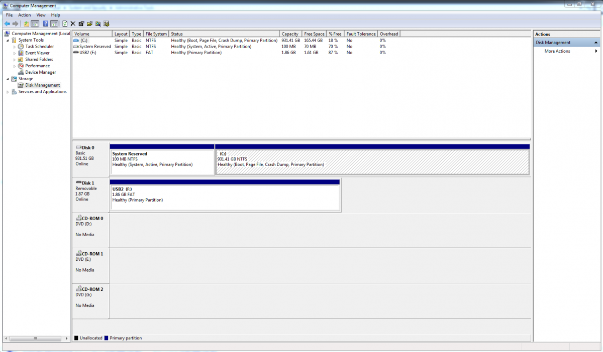

Hello Puddd,
Please provide the brand and model name or number for the MB, HDD and PSU, can you also provide a screenshot of Disk Manager for us
1.        Click on the Start button and then choose Control Panel.
2.        Click on the System and Security link.
Note: If you're viewing the Large icons or Small iconsview of Control Panel, you won't see this link so just click on the Administrative Tools icon and skip to Step 4.
3.        In the System and Security window, click on the Administrative Tools heading located near the bottom of the window.
4.        In the Administrative Tools window, double-click on the Computer Management icon.
5.        When Computer Management opens, click on Disk Management on the left side of the window, located under Storage.
Note: If you don't see Disk Management listed, you may need to click on the |> icon to the left of the Storage icon.

Hi Phillpower2, thanks for responding.
The Mother board is a Gigabyte GA-B85M-D3H Motherboard. More info here, https://www.pccasege...oducts_id=24115
The Hard drive is a Seagate Barracuda 1TB ST1000DM003. More info here, https://www.pccasege...oducts_id=19747
The Power supply is a Antec High Current Gamer 520W Modular HCG-520M. More info here, https://www.pccasege...oducts_id=19762
I couldn't figure out how to directly place the image in the forums so I have hosted it on www.imgur.com, I apologise if this is not your preferred way of receiving images. I just found out you don't allow me to add images, I will attach it. Here is the imgur link anyway. http://imgur.com/oXUxCjH
Thank you.

It may or may not be related but your free storage space on the C: drive is getting too low, in order to avoid data corruption and/or mechanical HDD failure for data only HDDs you must always have a minimum of 10% of the HDDs overall storage capacity available as free space and between 20 and 25% of a HDDs overall storage capacity available as free space if the OS is on it, the free space allows for information to be copied to and from the drive efficiently and it reduces the risk of the OS being overwritten/becoming corrupted by a simple task such as installing a Windows or a third party software update.
Not having the above can render a computer inoperable if the HDD concerned has the OS on it due to the MBR (Master Boot Record) becoming damaged/corrupt, please see information @ http://pcsupport.abo...sterbootrec.htm

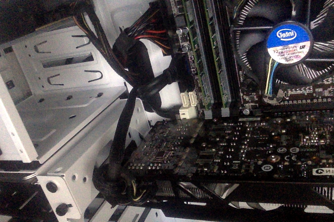

I will defiantly try to clear out some space on the PC, thanks for that advice. I'm not sure what the hard drive is plugged into on the MB, I had the pc constructed for me. I just checked and it seems to be plugged into the white space to the left of the sata3 ports. Seen here https://www.pccasege...M-D3H-large.jpg sorry I couldn't be of more help. I did Seatools for DOS by burning it to a disc from the .iso file.

Hey I just wanted to run some things by you before I changed ports. There are two cables plugged into some sort of adapter to the left on the sata3 ports, is this sata0, (is it even an adapter or is it part of the MB). I would have to remove the graphics card to get the cables out of there, something which i'm rather apprehensive about doing, any tips so I don't mess it up? And if the white thing is an adapter would I need to take it off and put it on the sata 3 ports, or am I fine to just plug the 2 cables into the 2 sata3 ports.

Correct, your connections are to ports 0 and 1 where they should be and they are connected with a terminal block which is good, I would not go to the trouble of partially dismantling the computer but instead start the warranty procedure for the HDD, it is the safest option as it reduces the risk of any possible mishaps.
