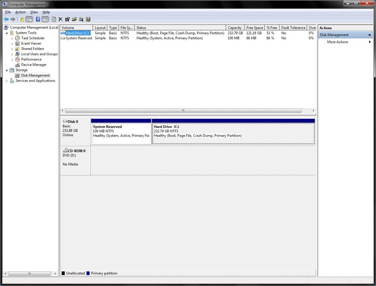

Do the following to take an expanded screenshot while the above is open and showing on your desktop.

here's the picture you requested.

The HDD looks fine but I also asked the following;

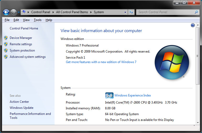

Oh, sorry, I was in a bit of a rush yesterday, I missed that part. My computer was made for me by my computer friend because he said he could make a fast one for cheaper than retail.
Here's my system details. My friend showed me how to look at this stuff when he set up my computer.

Hi, I am afraid that is perhaps a little too basic, to save Phil a job, can you please download Speccy from Pirriform. this link auto starts the download.
http://www.piriform....wnload/standard
Once downloaded, install it and open it.
Once it has opened and analysed the system, click on "File" top left, then select "Publish snapshot", that will give a unique link, if you can post that link here we can see what is what from that.

http://speccy.pirifo...BRtgTHpNjhrHo54
  • 24,821 posts

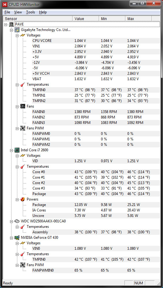

Two things of note in Speccy are 1: you are using Norton AV which is a hog on system resources and slows down your machine, if it is a paid for product make a note of the licence key and then uninstall it using the correct removal tool from here and then download Avast free from here 2: your power readings are anomalous and need to be checked out, see below;

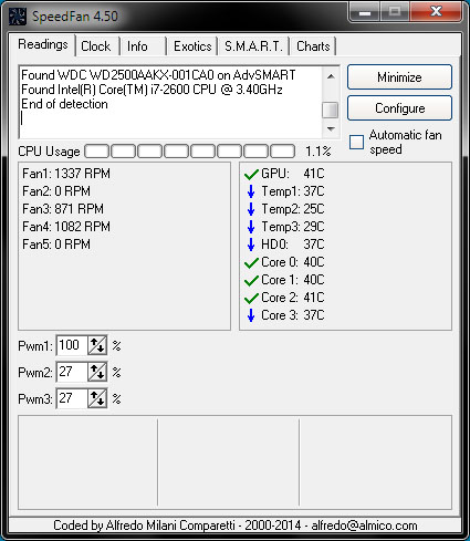

Download Speedfan and install it.  Once it's installed, run the program and post here the information it shows.  The information I want you to post is the stuff that is circled in the example picture I have attached.

Anyway, here are the pictures you wanted. The "Speedfan" didnt have all of the information though. the bottom circle is blank on my computer for some reason, is that a problem with my computer?

The PSU readings are inconclusive but that is most likely the MBs own monitoring software locking Speedfan and HWMonitor out, you can check the +3.3V, +5V and +12V readings in the BIOS, compare them to the table below and let us know if they are the same or at least within tolerance;
