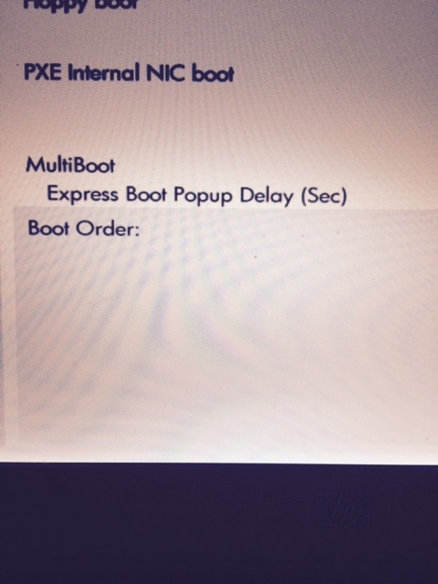

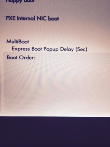

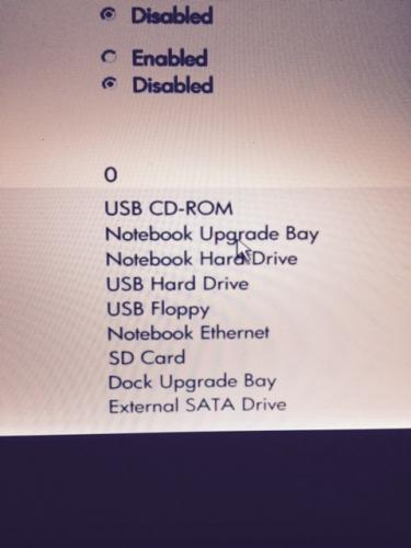

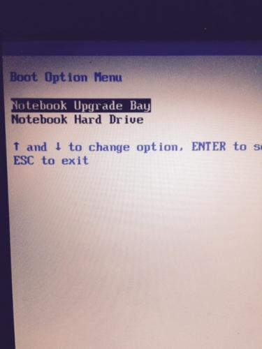

Not great to be back needing assistance yet again, but certainly appreciate all you do to help morons like myself.  I burned the CD and added FRST to a USB.  I then went into the BIOS, ESC then F10 and put USB/CD Rom as #1 in the boot order.  The machine proceeded to bot normally, only giving me the option of booting to xp or the recovery console. When I went back into boot options, F9, I realized there was no option for CD Rom, just Notebook Hard Drive and Notebook upgrade bay.  Since it was on HD i switched it to Upgrade Bay.   It is still booting from Hard drive or at least not boting from the CD.  Each time I boot it brings me to the windows login screen.  I must be doing something incorrectly, I appreciate you looking into this for me.  Thanks.

Being a Malware guy and only a passable Hardware guy, I might not have the answer to your question, however, this link was in the instructions above, did you try it or did it not answer your question? :)

I believe I have followed what that article says, however, no joy in booting from the desk.  Maybe it would be better if I go into the hw thread and post about booting to cd in xp on an hp.  Once I get that I can folow your instructions at that time.  I don't want to hold anyone up.  Is that the best course of action?
