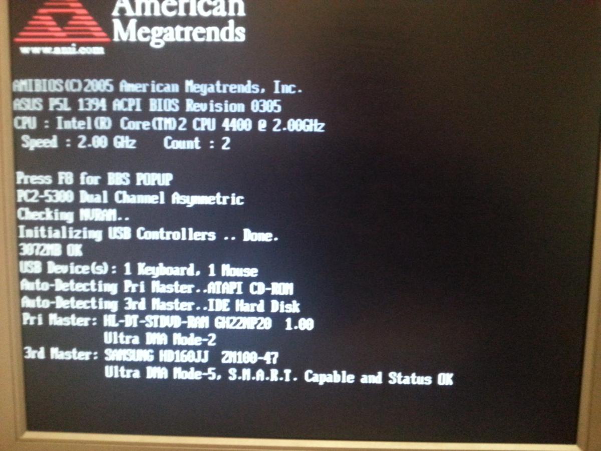

Here it is
P.S. Sorry for the bad quality, the high quality photo taken was 2.1 MB big, and it wouldn't let me upload it because of the size (Yes, it is JPG)

The BIOS is detecting the keyboard and mouse which is a + but as the keyboard will not work it does not help as you cannot navigate the BIOS  :( this can happen if Legacy USB Support is disabled so a PS/2 type keyboard is still required for testing purposes atm.
I note from the screenshot that the Samsung HDD is set as the 3rd Master and as being the IDE type, the search results that I got for that HDD say it is SATA, is that correct.
HDD example result here

Seems like it is a SATA, didn't notice that the computer is detecting it as an IDE drive, but it worked fine until today. And about the keyboard, well, it works fine, because before the screen that I took a photo on appeared, I had to press the delete key (because of the quick boot being enabled), so I guess it works

The USB ports being disabled after POST resulting in the keyboard not working is just one possibility that we are checking out and I am not saying 100% that it is the cause, it is a well documented problem if you Google it.
While the POST is being carried out the BIOS chip provides the drivers and support for devices such as the keyboard, the fact that the mouse and keyboard are shown in the BIOS only means that when the BIOS chip tested them they were detected and working, it does not mean that Legacy USB Support is enabled in the BIOS which is what needs to be done as when POST hast been passed the BIOS chip does not control the USB ports anymore, an explanation here
Regarding the HDD, can you try the following for us, disconnect all drives from the MB and only connect the HDD that has the OS to SATA port 1, re connect only the keyboard, display and power supply then power up the computer, let us know if there is any change.

Nope... nothing changed, still stuck
  • 25,120 posts
Hmm, try disconnecting the keyboard, mouse and the Samsung HDD and then power up with only the screen attached, this to see if the BIOS chip behaviour changes.

After performing the tasks called for by Phillpower2 and you still can't perform POST. some thoughts.
If you have not got your MB manual, download, > http://dlcdnet.asus....P5L_1394_V2.pdf
Your board is quite old and the CMOS battery may be low, replace it with a CR2032 3V Lithium Cell.   The holder for the battery is delicate and can easily be strained, check that the battery is not loose.
Check the Clear CMOS jumper is present and installed on the correct pins, MB manual, Page #20.
Check the . USB device wake-up jumpers and Keyboard power are on the Default pins, Page, #21.
If you cannot borrow a PS/2 keyboard, buy on, i,e, > http://www.bestbuy.c...kuId=1307758700
Use the setup as Phillpower2's instructions.
Hmm, try disconnecting the keyboard, mouse and the Samsung HDD, also the DVD drive, and then power up with only the screen attached, this to see if the BIOS chip behaviour changes.
Power up and start tapping the Del key.
If you can enter the BIOS,
Set the date and time, > Go to the exist screen, > press the F10 key, > a confirmation message will be display, > click OK.   Your computer will restart.
If everything is OK, you will see a message, something like, no boot device, or, select boot device.
Shut down the computer and connect the HDD to the SATA #1 (red) MB manual page #25.
Power up, Please post back the results.   Do not connect anything else or go further until given further instruction.

I disconnected the HDD from the MB. After that, I managed to access the BIOS setup utility and change the time and date, as you said. But after I rebooted and reconnected the HDD, it is still stuck and it is still detected as the 3rd master.
Initial OS was Windows XP
Installed Windows 7 like 6 months ago

Fixed it, bought another HDD and it works like a charm.
Thank you all!!
