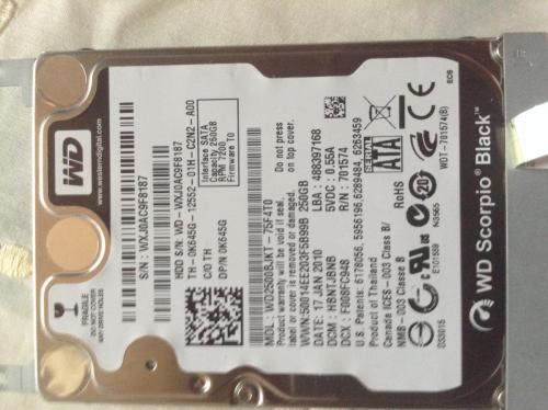

  • 159 posts
Heres my harddrive,whos the maker?
Wester digital scorpio?
#231
terry1966
terry1966
    Member 1K
  • 1,143 posts
western digital is the maker, here's a link to it's Data Lifeguard Diagnostic program for Windows :- http://support.wdc.c...0&sid=3&lang=en
