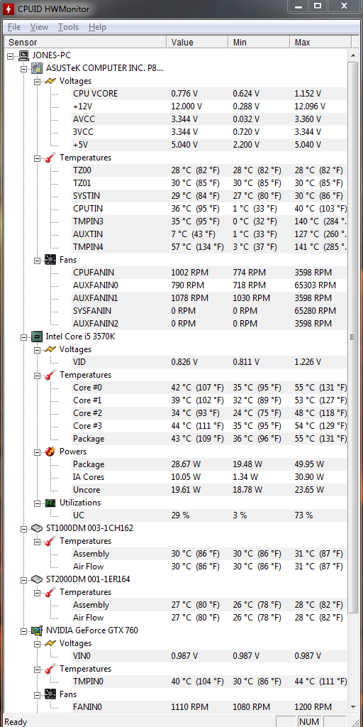

I also have been monitoring temperatures and everything seems OK except with the ASUS Suite 2 which seems to be giving me warnings of the PSU volts being too low occassionally but CPUID HWMonitor says they are steady.

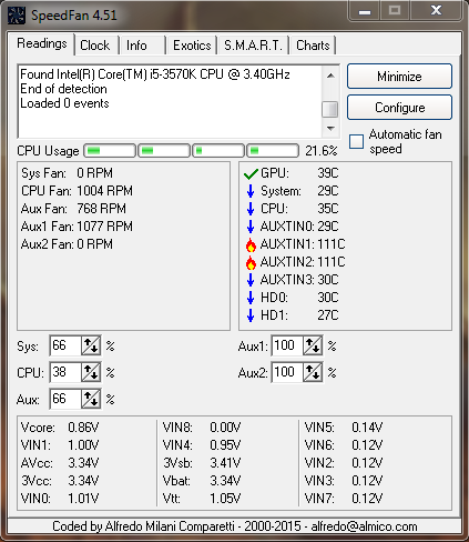

Download Speedfan and install it.  Once it's installed, run the program and post here the information it shows.  The information I want you to post is the stuff that is circled in the example picture I have attached.

Heres the update

The V core readings are too low and there are high MB temperatures reported, this may suggest bad voltages due to one or more MB VRMs (Voltage Regulator Modules) being faulty, has the system ever been overclocked, if yes, to what voltage.
TMPIN 3/4 = Sensors near the GPU/VRMs
AUXTIN is the power supply temp sensor if there is one.
What is a VRM explanation here

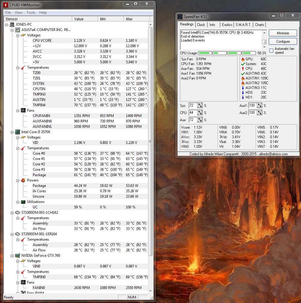

Played H1Z1. These are the results.
Also I ran the Intel Diagnostic Tool. Ran it twice. Passed both times.

Notice the increased temps, corresponding increase in voltages and the high CPU usage, these will increase further when you are actually gaming, the PSU output still appears stable so it points back to a VRM again I'm afraid.
Good news on the two Intel passes but can I ask if any voltages were reported.
