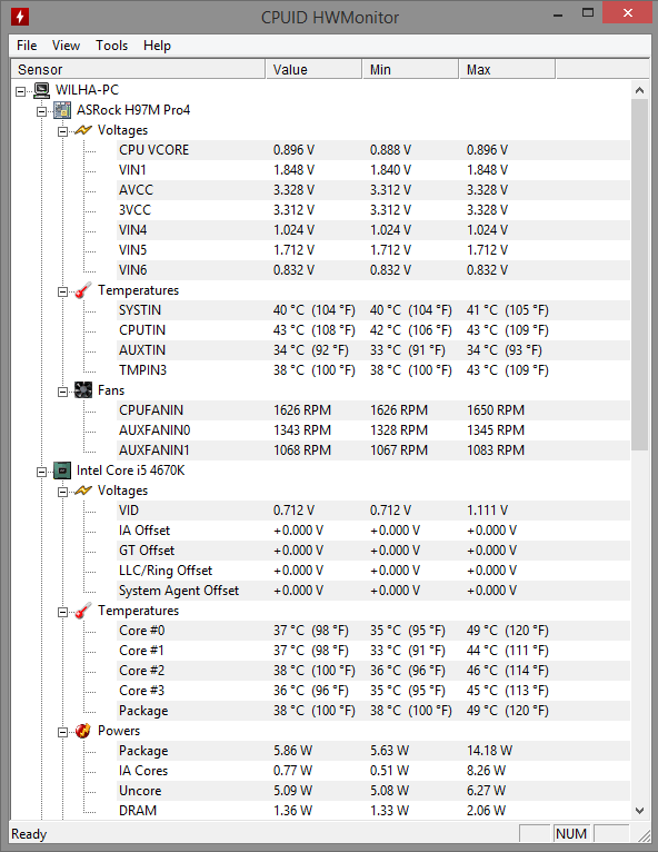

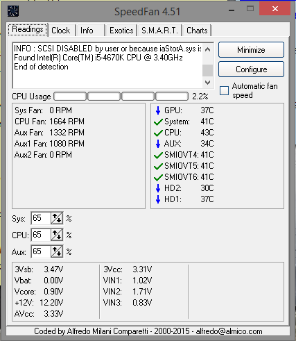

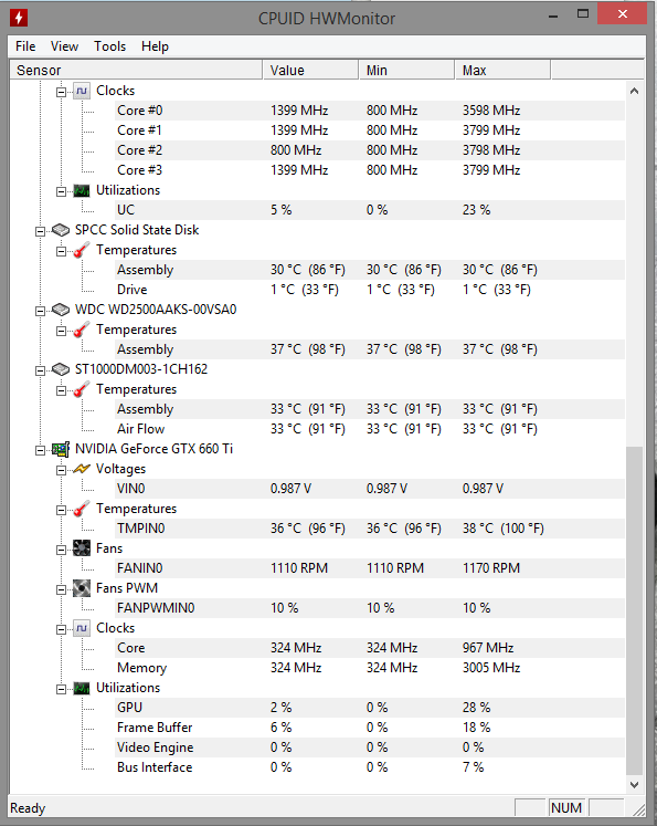

Attached is 1 screenshot of SpeedFan and 2 of HWMonitor, as well as my lastest crash

  • 24,572 posts
Note* - Even after doing the above, my PC still freezes occasionally and sometimes I do still get the BSOD
Is this only happening when you are connected to the internet?
Chrome is related to both of your latest crashes so the cause points towards your internet be it hardware or software related.
For testing purposes, uninstall Chrome and use IE to see if it still crashes.
If the computer still crashes, create a new restore point and then do the following;
Uninstall TorGuard** and NetBalancer and then the following two devices in Device Manager Windows Adapter V9 and Viscosity Virtual Adapter V9.1
**TorGuard loads on boot and so it is possible for it to cause problems as soon as Windows has booted.
Test the computer.
