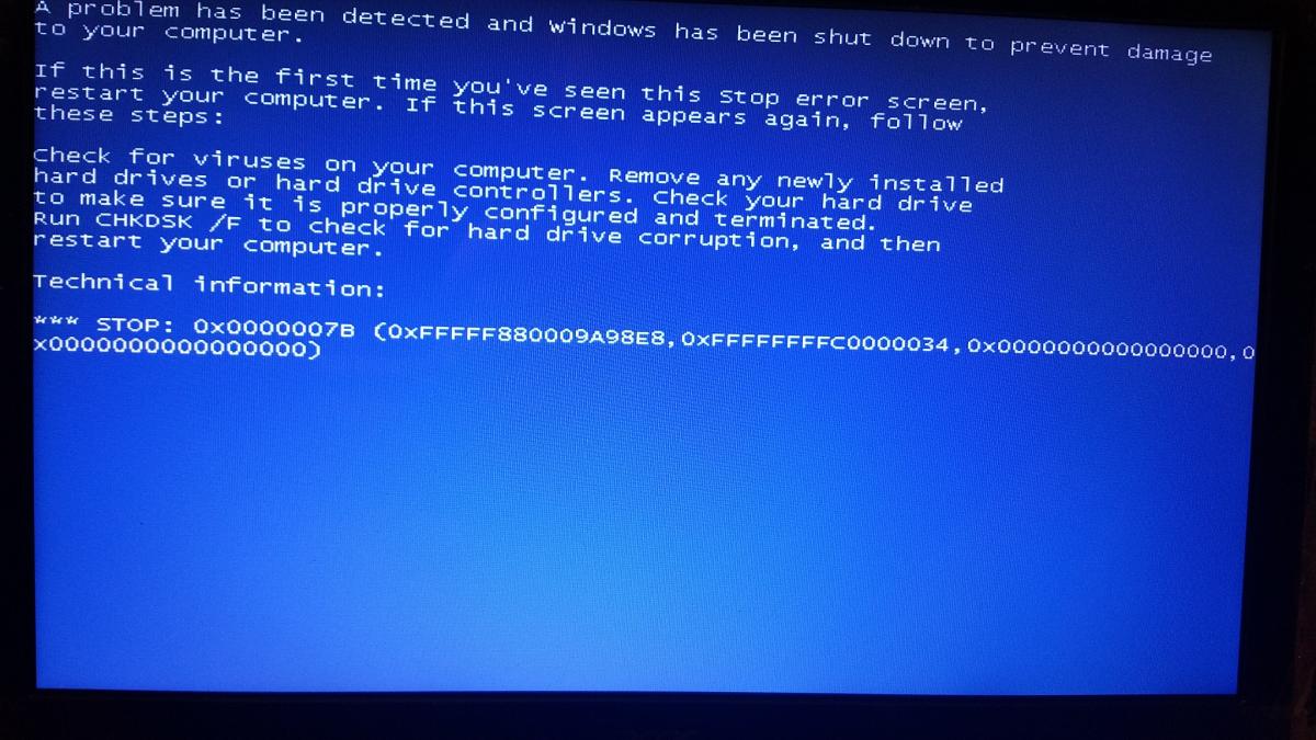

Boot to the Advanced Boot Options Menu, aka Safe Mode menu. Select Disable automatic restart then boot. If you get a blue screen it will stay. Record the information or even take a picture with a digital camera and upload here.
You press F8 during boot to get to the Advanced Boot Options Menu.

Ok, here is the results
Thank You

7B is a disk boot error of some kind.  Lomg discussion on this here: https://social.techn...=w7itprogeneral
This post by HugoCore fixed some people:
I had also Windows 7 with 0x0000007B blue screen while loading Windows 7.
It's turn out that the BIOS had been change to another disk mode, IDE, ex-raid. For now I wanted IDE, to be simple.
Here's what works with me:
In the BIOS, i went change the SATA to IDE mode (NOT RAID, NOT AHCI)
1.Boot Win7 DVD
2.Choose the Language Selection.
3.Choose Repair.
4.On the recovery tools choose the Command Line Console
5.Type:regedit <ENTER>
7.Highlight HKEY_LOCAL_MACHINE
8.File > Load Hive
9.Select < windows partition with problem > \Windows\System32\config\system (Backup this first, it's advised)
10.Regedit will ask for a Key name: Name it something like "temp"
11.Located HKEY_LOCAL_MACHINE/temp/Select/Current
12.Searched for every key containing the value “SCSI Miniport” where the "Start" value was a "3" and changed the "Start" value to a "0". (F3 to search next result).
13.Highlight "temp"
14.File > Unload Hive
15.Restart
16.Enter in Win7 :)
Other possibilities as well, read through that thread.

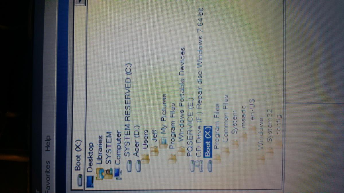

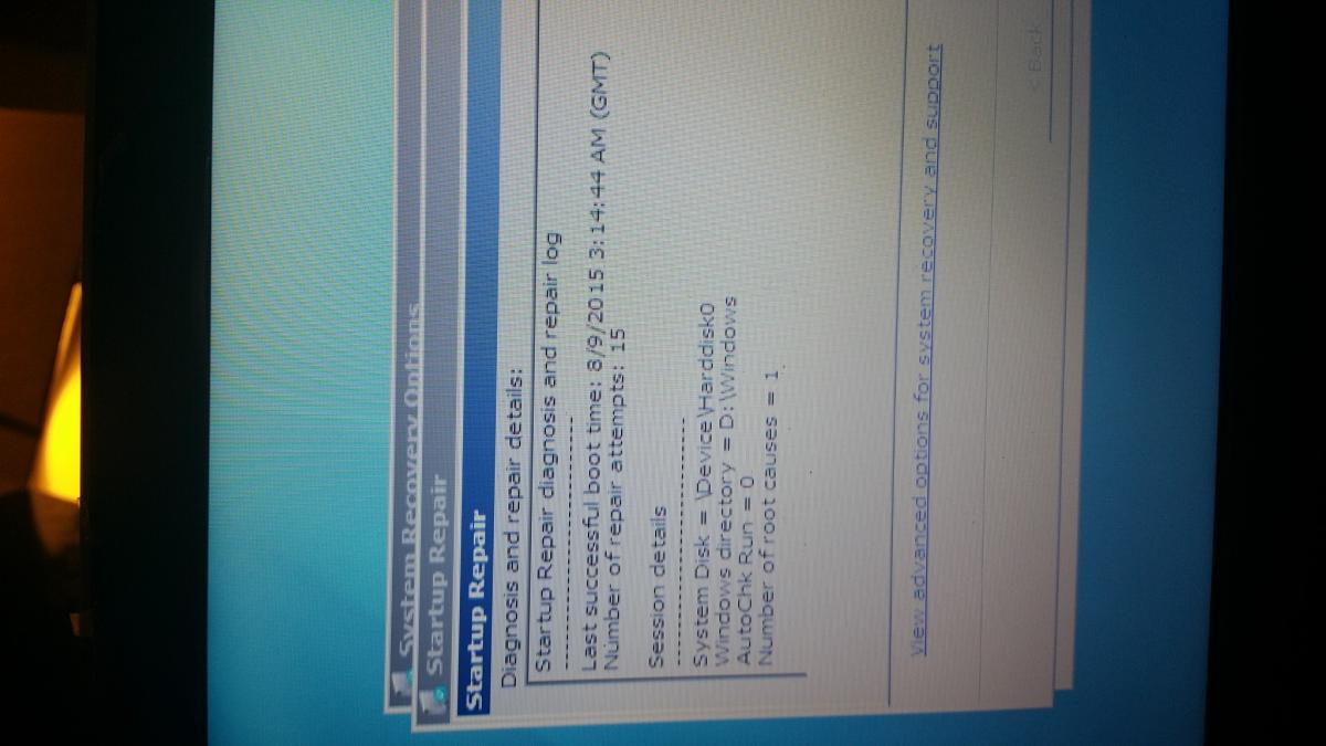

Hey, ztrucker... thank you for helping me out, im still at it trying to figure this out. Restoring isnt a option yet, as i got lazy and didnt back anything up! Anyways i was messing around and it seems my windows 7 is a different letter than C: ? I was wondering if this could be why its not wanting to load, i did do the suggestion from that website you mentioned and now i dont get the blue screen it boots right into windows system recovery but it dosnt fix anything. I think i am getting close to getting it working, hope you had a good weekend, i know i did! Oh, check out all the drives its showing i only have 1 hard drive in the laptop it looks like windows 10 did a number!

Looks like you were booting from a recovery disc or something as the boot drive shows as X: which is typical for that environment. You Vista boot drive showing as D: is also normal as often it does not get assigned C: in the recovery environment.
Do you have a Windows 10 install flash drive or DVD? If not, see here: Windows 10 ISO Download
You can boot it then take the Repair choices to get to a command prompt where you can copy your data off to a flash drive. Once you have that then you can do the restore to factory state or a clean install of Windows 10.
