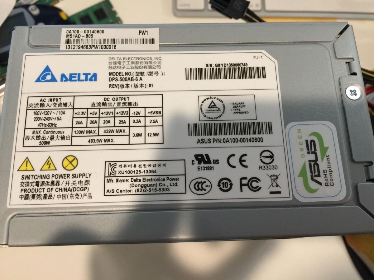

The power supply i have is called:
Asus Delta dps-500ab-6 a
Also took a picture of my graphic card by the connecting cables.
Here's the picture. If you would be so kind to explain what the difference between these two are ^^ i'm curious.

From doing research on this PSU not a quality PSU. PSU are important to system would never want to  overload more to it then it can handle. Better quality PSU has better components inside.
Good idea here are connections and specs and also in this picture. http://specsen.com/p...s-500ab-a-500w/
You basically have enough wattage for that particular card, but amperage is what concerns me on this PSU and it's quality. GTX 750ti basically need 20amps on +12v rail. I know you may not understand this part, but it is important.
Specs link says 18amps and picture i found shows 20amps.
So i would really first need you to pick out exact model of this card you would purchase and then i can look again, as told before some specs change with this card. As some model are different specs.
From your picture it shows (2) 6 pin connectors so you are fine there for GTX 750Ti from what it needs on PSU.Just Google GTX GeForce 750Ti see number of diffrent versions, makes and models with slightly different specs there is also a SC Super clocked version, one with 2 fans instead os one fan.

Thanks for the info. The card i'm wanting to get specifically: https://www.komplett...2gb-physx-cuda#
The site is in swedish, but you should still have the name for the card.I don't know of any sites that are written in english should you need to read about it. Unless you simply need the name of the card.
good to know that the pin connectors match. And for the 18/20 amps stuff. yes i have no clue what it means.
Also, What should the consequense be should the psu has 18 amps and whatnot, and the gpu requires 20,
Assuming that's what you said. (Unless i misunderstood)  Would stuff break? would it not work?
