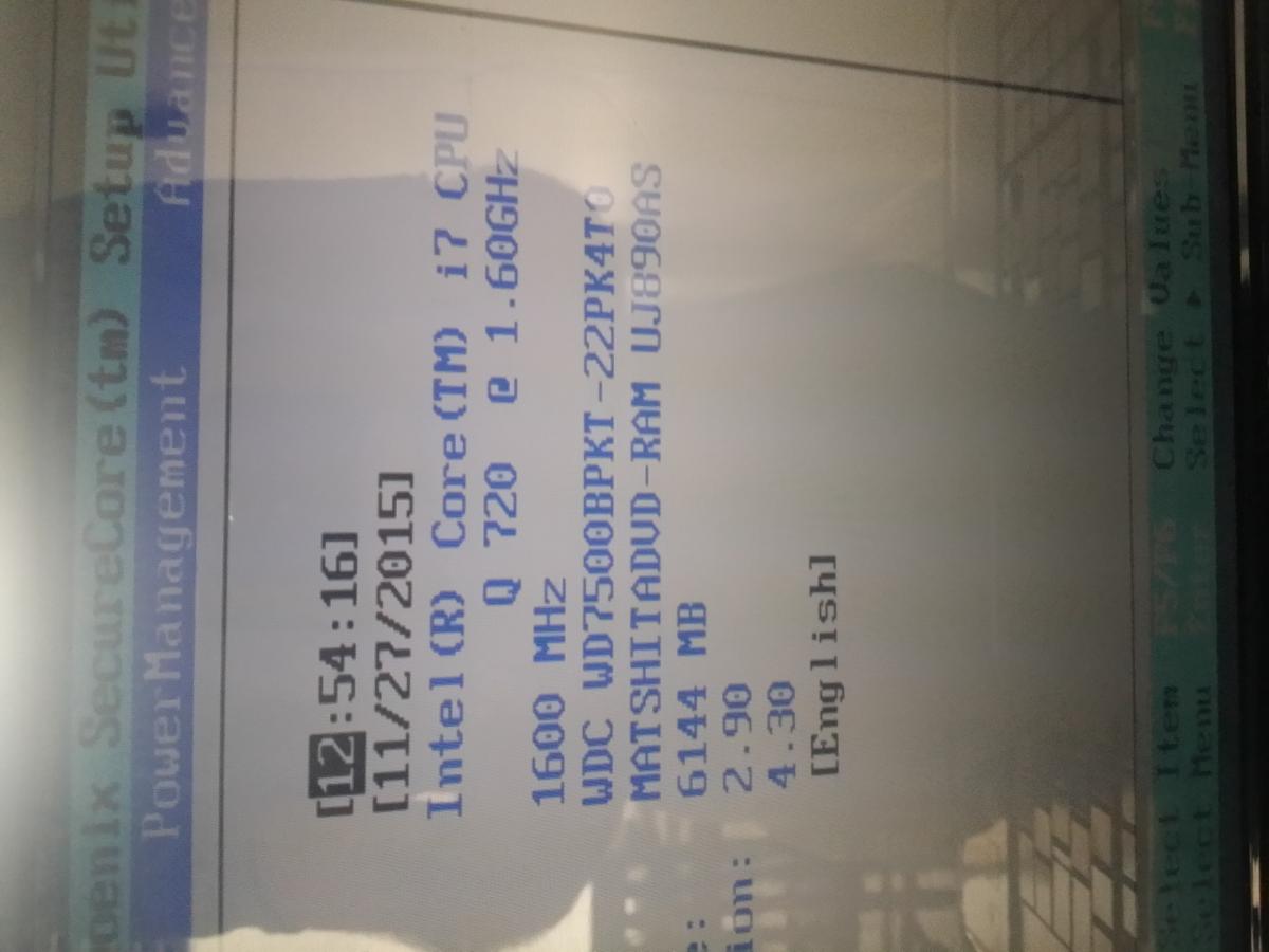

So, my Satellite has been playing up, it's getting old I guess.
I've attached my laptop specs to this post.
For context, 3 of the 4 USB ports no longer work, the DVD drive head is misaligned, the FW port is sketchy, and the SD card slot is a no go. It runs very hot, and I've been having software problems where I get constant hang screens when searching for something through Explorer, the spinning wheel of nothing. At least the HDMI port works...

Anyone have any ideas??? I have a new laptop in I'm but I won't have the $$$ until another month. I use this laptop for work (audio) and am currently unable to develop or complete any current projects!!@
