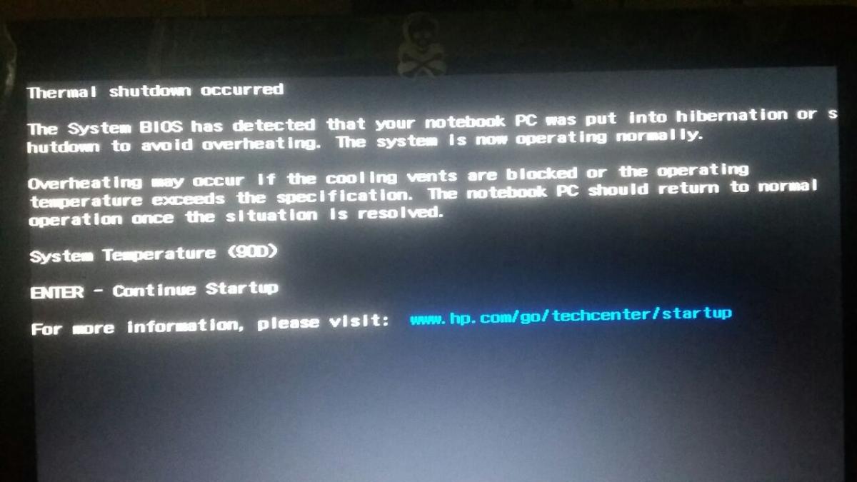

Is this one from Blue screen ?

Sorry about not answering your question earlier i have not payed much attention to screenshot you posted it looks like computer overheating which can also cause BSOD errors. You need to clean all dust and dirt from inside of your computer case and apply new thermal paste to CPU and if its possible to GPU. Make sure fans are working and free of dirt and dust.
Just some friendly advice to the OP :)
I would highly recommend using Arctic Silver 5 I have used it on quite a few laptops and the results are fairly good. There are other types of thermal compound out there that are good as well.
When you clean the Thermal Compound on the chip use some cotton swabs with some dabs of %90 isopropyl alcohol to clean the chip properly. All of the old paste is factory made and is not the best that's why I open PC's up just to give them new paste.
Assuming there is dust in there use a pressurized air can to blow all the dust out. Don't put too much pressure on the can or you'll end up with a frozen motherboard which will possibly kill your computer.

Deamon77 is using a netbook as per the screenshot in post 4 so therefore can't apply thermopaste or clean inside the computer.
What the OP can do is make sure that the cooling fan and vents on the netbook are clear of dust and debris.
Also be sure your not using it on you lap and blocking the vents.
