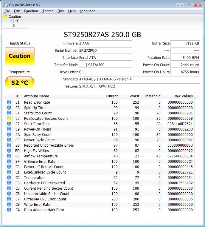

My Acer Aspire 6930Z laptop had recently refused to boot so I had someone do me a fresh Vista Home Premium SP2 install.
It's now incredibly slow, has a lot of Acer progs I don't want, has lots of start up items I don't know whether I can get rid of and it also won't shut down properly! It usually, on shut down, goes blank after a couple of minutes but the screen is still glowing slightly as it is still receiving power. I then have to press the on/off button for a few seconds to complete the shut down!
I use Firefox, as I did before the issues, and wondered whether anyone can look at my system and point me in the right direction towards a faster machine. I'm 99.99% sure it's not a virus issue as I had the fresh install done yesterday morning.
I've also noticed that when I check for Windows Updates it just carries on checking for hours without finding any!
It also took me over two days and many attempts to successfully install Flash Player.
It performs as though I have dozens of progs running at the same time ................................. but I don't!

  • 24,716 posts
Hello
Only thing jumping out is the amount of memory being used which is very high for a computer that is not under load;
Physical Memory
Memory Usage:
60 %
Couple of suggestions, the first one is to post an Autoruns log for us, see here
3: Click on the "Hide Signed Microsoft and Windows Entries” option.
5: Save AutoRuns.txt file to known location like your Desktop > when you click on File > Save you will then get the option to Save as type, click the drop down tab, change it to Text and then click the Save button.
6: Attach to your next reply.
Tutorial here
2nd: Download and run TFC from here the computer should automatically re-boot on completion but if not do so manually.
3rd: Defrag your HDD with Auslogic from here a tidy drive is a faster drive, please note that I am not suggesting that you use any other product or service at the link.
The above may take a while to complete no rush here so do it in your own time and if possible please complete the three steps before posting back unless you have a problem or a question etc.

Please download then run CrystalDisk, take a screenshot of the results and attach to your next reply, download here

Sorry Slime but that is not the screenshot that we need, please click on the File tab first.
Hopefully this is the one you're after!!
Sorry but no, the information that we need is as in the example attachment below, you may need to do two screenshots as you cannot expand the window to full sized meaning that the info on the bottom needs to be scrolled down to before it can be seen, please only use the method provided for uploading the image/s;

Hopefully this is what you're after ............................... there's a horrible orange caution button that's scaring me.
I managed to get all the info on one screenshot too!

  • 24,716 posts
Please leave the audio drivers (apologies for the blip btw) for now as they are not your most pressing concern, possible HDD failure is.
Download and then run both the short and extended Seatools test for the HDD, download here
