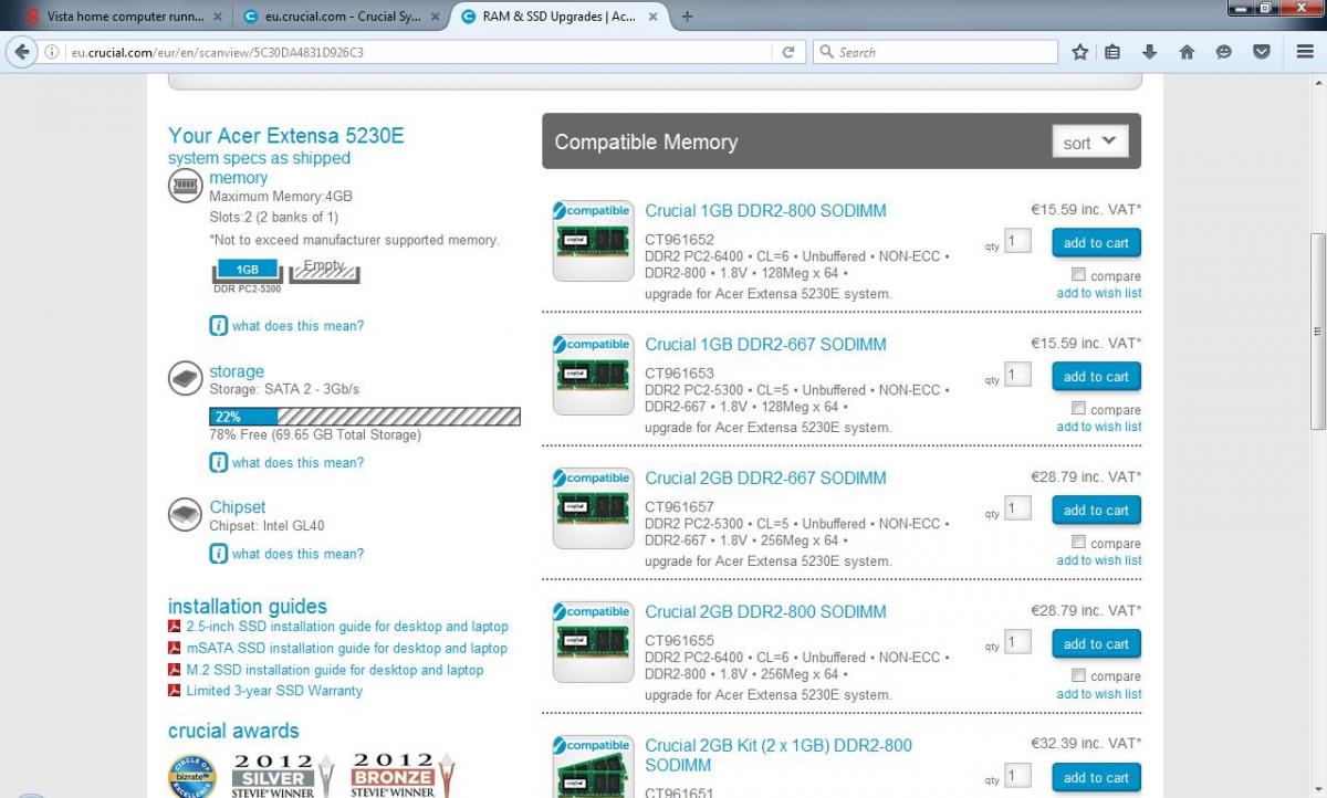

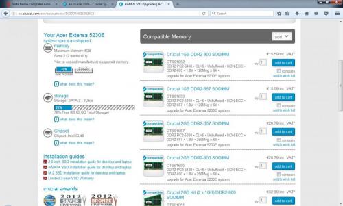

Use the Crucial system scanner tool here to find the best recommended Ram for your system, no need to purchase from there, write down the details then shop around for the best prices local to you.

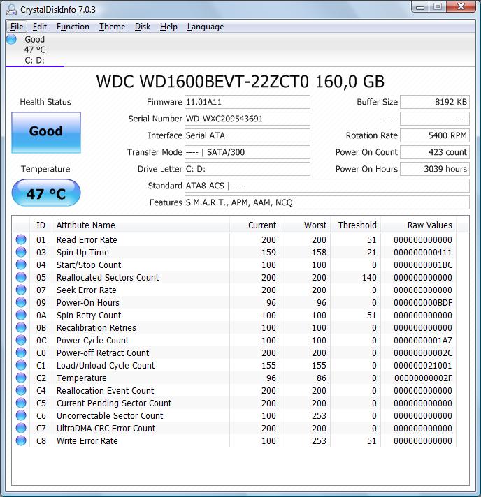

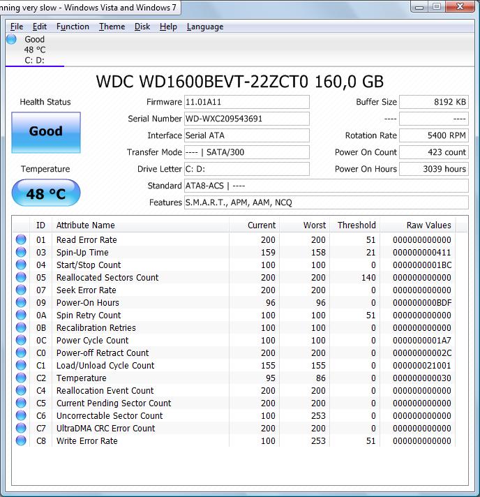

Test the HDD with CrystalDiskInfo 7.0.0 Standard Edition which you can download from here once done grab a screenshot (possibly two) of the results and attach to your next reply for us.

thanks phillpower,  i thought about the virus because it won't update mse definitions, and failed to download crucial and crystaldiskinfo (I had to download it to another pc and run it from a stick) and here's two results.

i managed to download crucial scanner so could I please ask which one of the first two 1gb memories should I buy..if it makes a difference.

Your HDD checks out as being fine Dimitris, not sure about the MSE updates though as Speccy is showing that it is fully up to date.
Regarding the RAM upgrade, there should be a 2 Xs 2GB DDR2-800 option, if your budget will allow it that is what I suggest you purchase.
