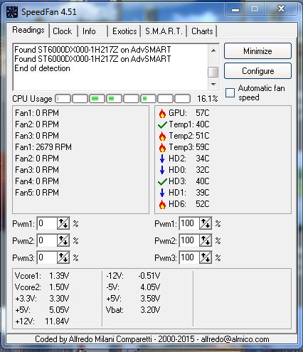

Download Speedfan and install it.  Once it's installed, run the program and post here the information it shows.  The information I want you to post is the stuff that is circled in the example picture I have attached.

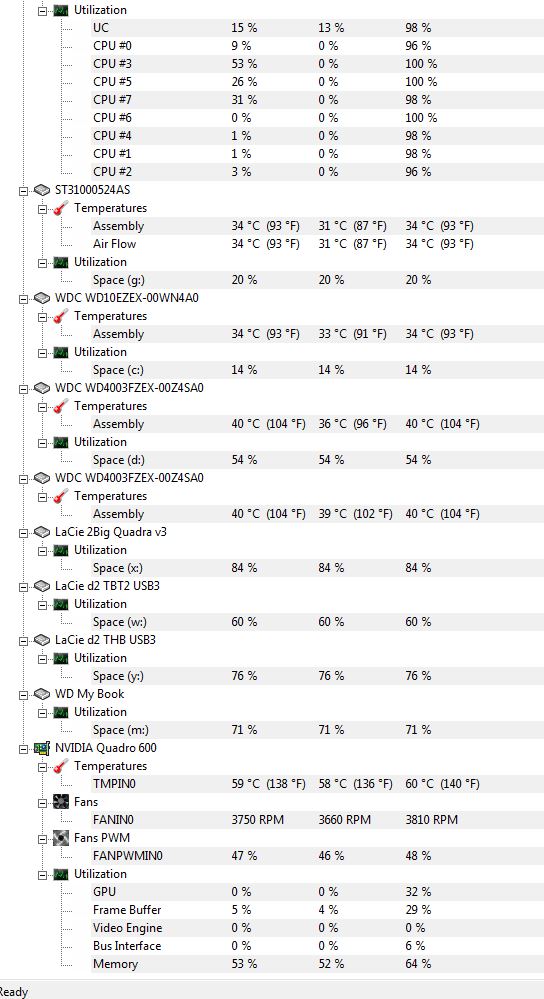

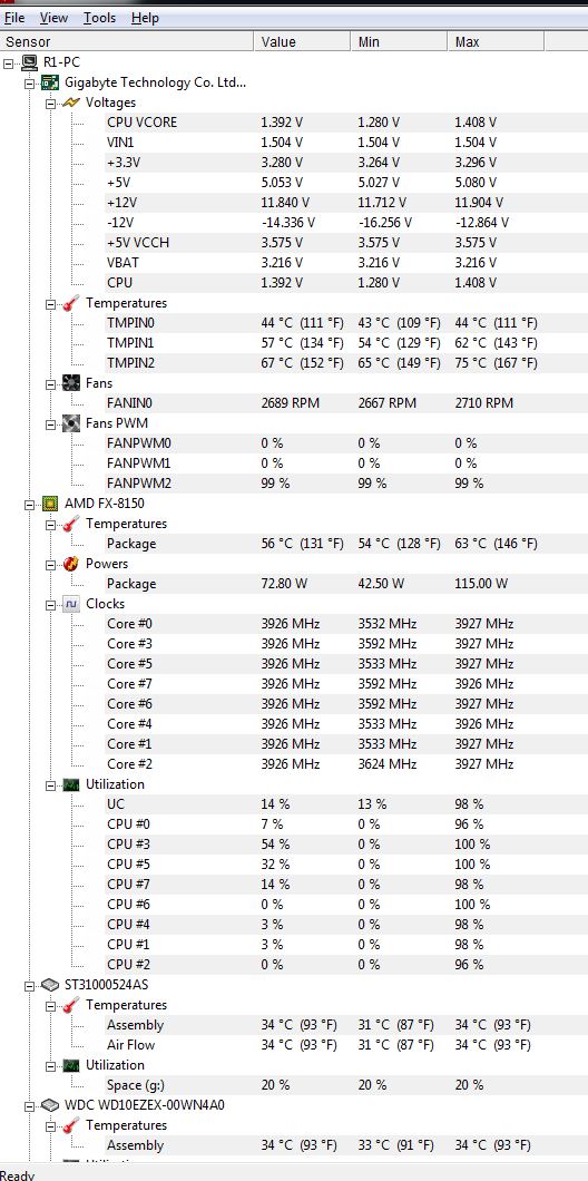

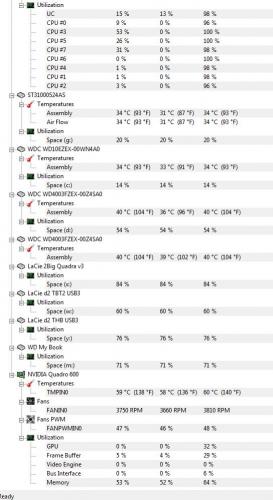

  • 25,111 posts
The bottom half of the HWMonitor info is not showing so we can only go on what we can see;
From the info shown above we can see the following;
You have high temps for a computer that is not under any load.
You have high CPU usage for a computer that is not under any load.
Voltages with the exception of one look ok but all may change significantly when you are multitasking etc, the +5VCCH is showing to be too low, sometimes called the +5V VSB (voltage stand by) this powers the USB ports and MB when the computer is in stand by mode.
At least one of your HDDs is overheating to the extent that it will cause problems.

Put the computer under the best load that you can, grab only new HWMonitor screenshots and then upload all of the available info for us.

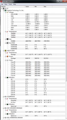

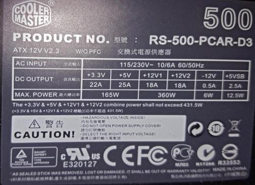

PSU andpsu.jpg psu.jpg 2 HDMonitor shots attached.
I opened Premiere Pro video program, and Cubase Audio software, my 2 biggest consumer of power.  I tried to get a snip while playing, but every time I alt tab to go to the HDMonitor, the playback stops.  though I didn't notice much of a change in the readings..

That PSU is so old and of such poor quality that I would not trust it as a doorstop, a 500W PSU that is potentially 9 years old, can actually only produce 360W, only had a two year warranty when new and does not even have a 80% efficiency rating should not be used anywhere near your HDDs if you value the data on them, the RS-500-PCAR-A3 /-PCAP-A3 at the link here is the same as yours and if you check the same PSU at the link here you will see it was classed as a Fail when tested, you need to replace the PSU with a quality brand PSU that can actually produce nearer the claimed 500W and is a minimum of bronze rated, if you really must use the computer in the meanwhile disconnect as many HDDs as you can to ease the load on the PSU before it goes pop on you.
Just so that you are aware, the PSU has two +12V rails rated at 18 amps each, divide the total power output of 360W by 12V and you get 30 amps which = 15 per 12V rail, one +12V rail and 15 amps is taken up by the CPU leaving you with the second 12V rail and 15 amps to power your video card and multiple HDDs etc.
