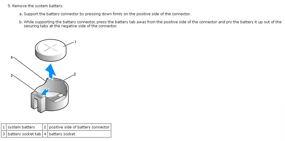

Does this help?

That's what I found in the manual.
It's also how pretty much all cmos batteries are changed out.
We need to see what yours looks like.
You're in the process of moving, so when you get a chance.

Wasn't meaning to interfere 123Runner. Just thought that showing Janis a picture of what the manual says it should look like might help her suss out what might be causing the problem. :(

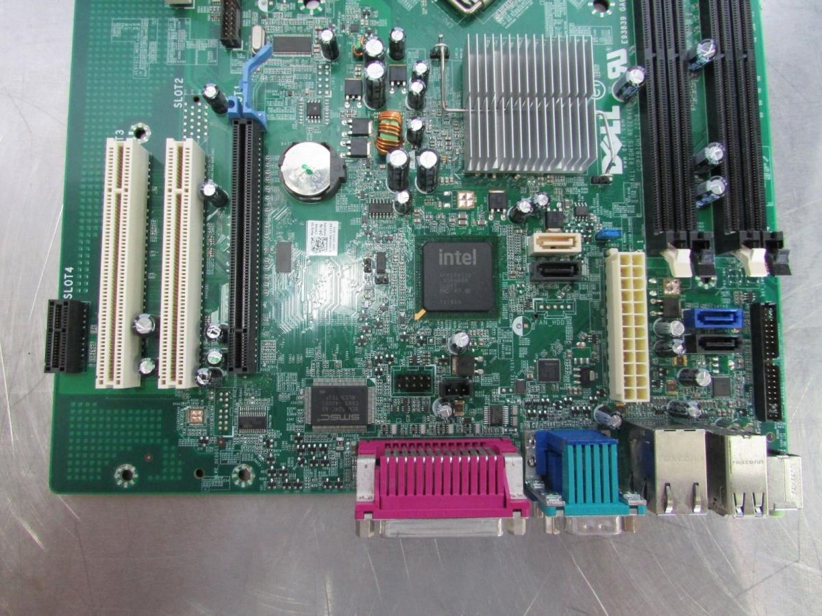

CANNES450
CANNES450
  • 2 posts
Gently push a very small screw driver into the slot in front of battery casing, in front of the large black connector.
The battery will then pop out. To put a new one back just push it in.
