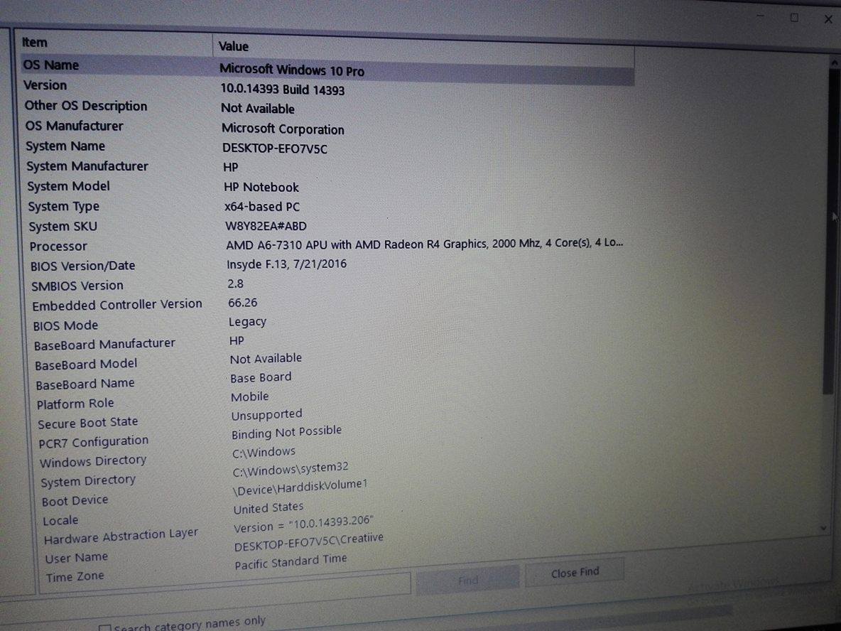

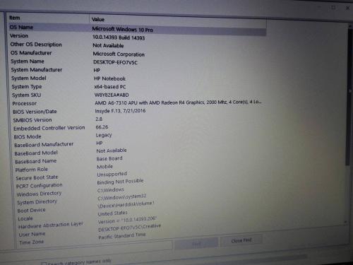

I recently got a new laptop (hp 15 ba011ng ) and it came without a system ( freedos 2.0). I checked msinfo and it said Legacy in the information. I checked the bios and i had an option of disabling legacy... I did. It stated under the uefi boot priorities, which was an ok for me to confirm that i have uefi.

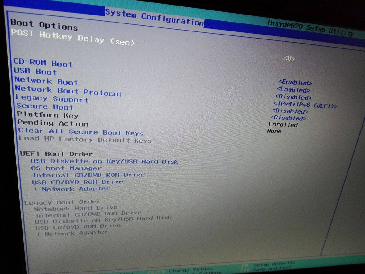

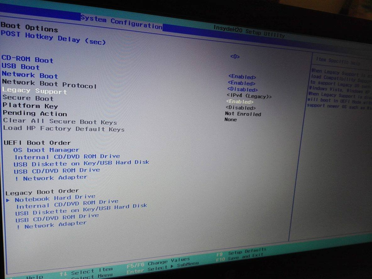

​hope this helps anyone
​in the bios when I disable or enable legacy, the grey out areas ....remain grey -_-

Change the Legacy Support to Disabled then try to install with Secure Boot Enabled and also Disabled.

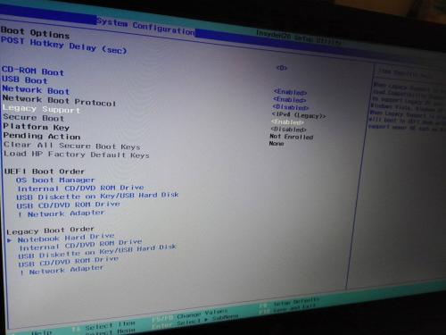

ok well here goes nothing. ill update you guys with the results .
these are my initial starting settings.

? No i had legacy disabled
The uefi boot order is shown in the pics of tge bios

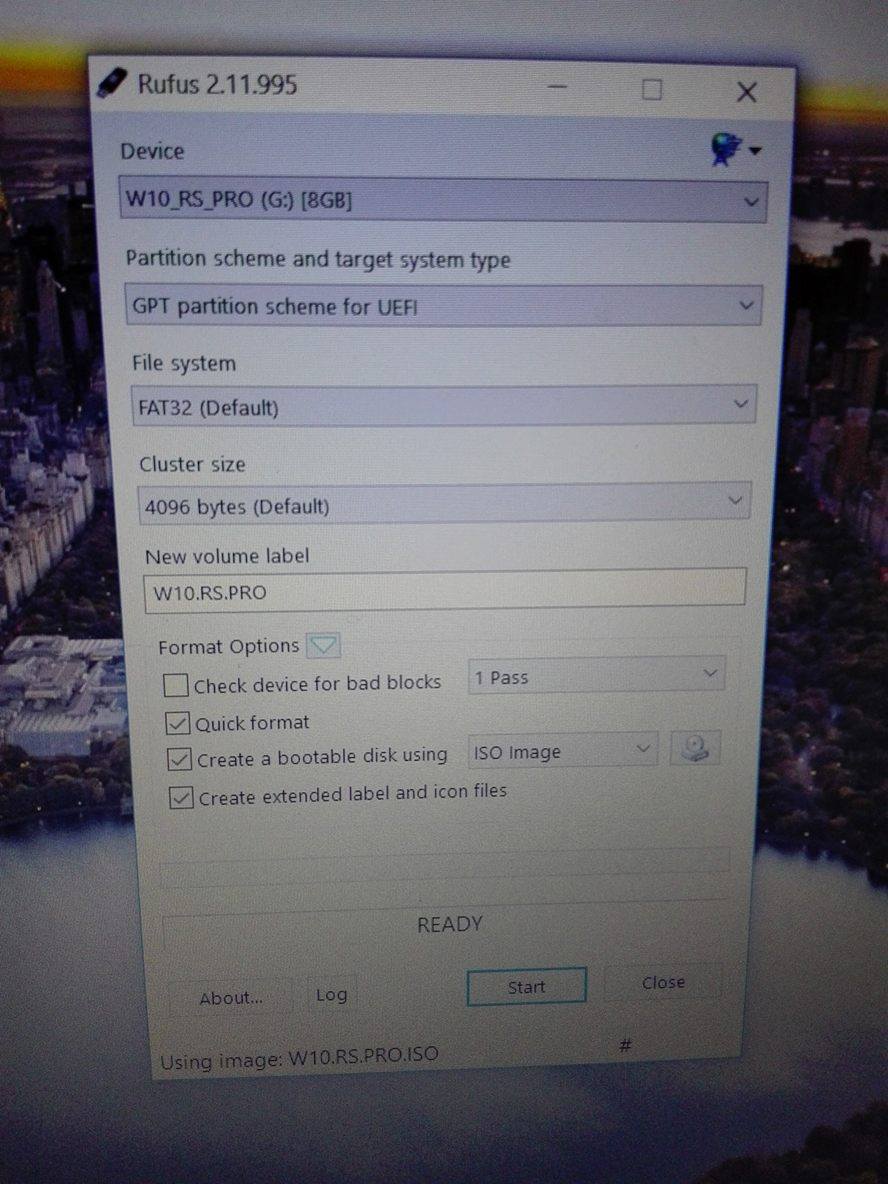

No i havnt, i used rufus... With the specified settings within the pic that iv uploaded.
On Rufus select MBR partition scheme for UEFI and on the UEFI configuration set Legacy Support to Disabled and Secure Boot to Enabled.
