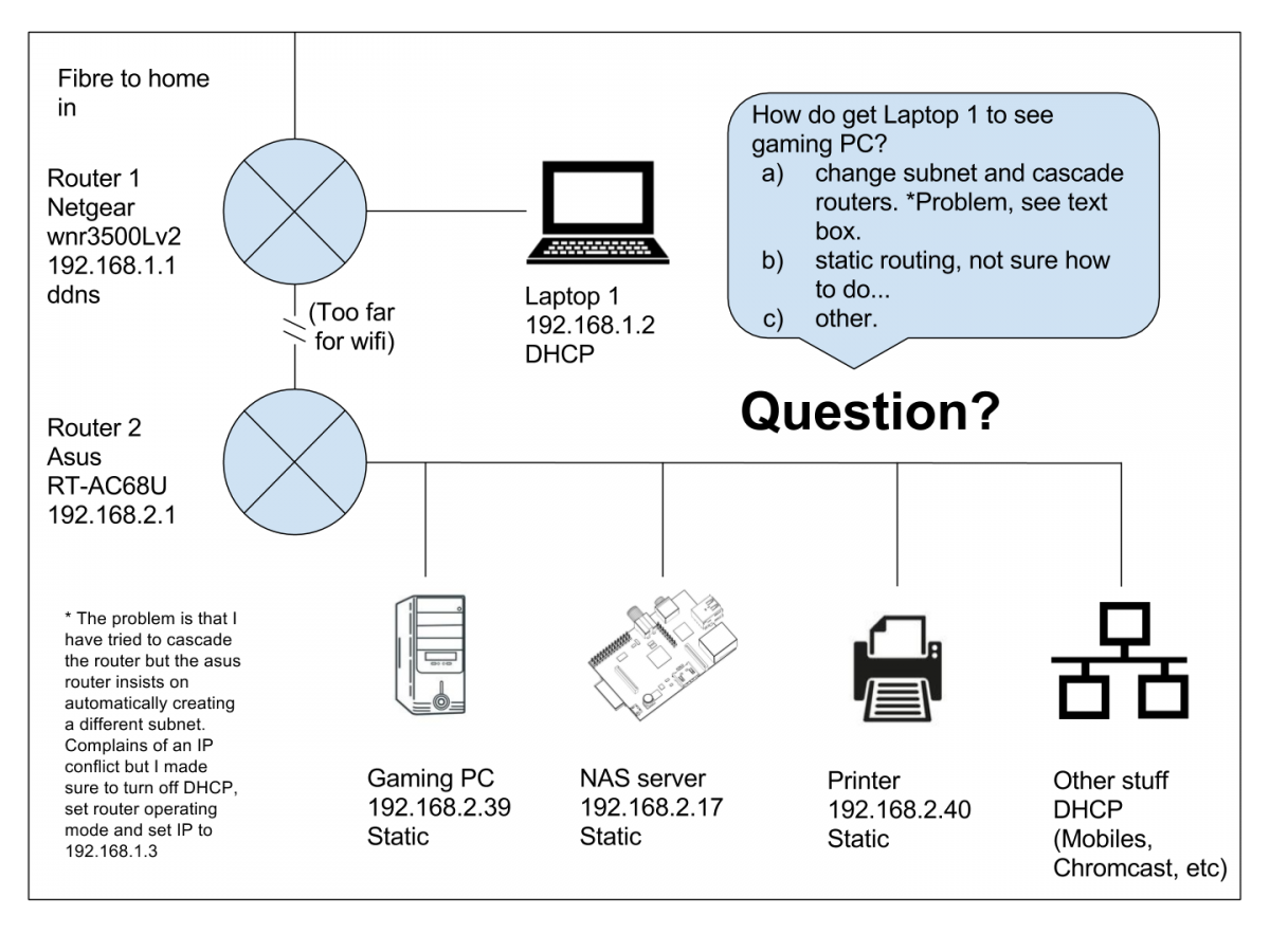

How do I cascade these two routers? 1. netgear wnr 3500Lv2 2. ASUS RT-AC68U
Alternatively, how do I create a static routes between 2 pcs on different subnets?
See link or attached image for my network diagram https://goo.gl/N5Tsd3
I have two routers to cover my home because the wifi doesn't cut it, I want to go to wires... One is a netgear wnr3500Lv2. This is set as the primary router with DHCP ethernet in from ISP (in the hallway). The other is an asus RT-AC68U. A much better router with good wifi range and features (in the lounge).
The problem is that I have tried to cascade the router but the asus router insists on automatically creating a different subnet. Complains of an IP conflict, even though I made sure to turn off DHCP, set router operating mode and set IP to a free static address on the primary netgear router...
So,
How do get Laptop 1 to see gaming PC?
a) change subnet and cascade routers. Problem see text above.
b) static routing, not sure how to do...
c) other.
Thanks for the help!

Can the devices on the ASUS get to the Internet OK?
How are you connecting the two routers?   Assuming a wired connection between one of the the Netgear's LAN ports and the WAN port on the ASUS and internet connectivity on the ASUS.   What IP address is the WAN connection on the ASUS? Assume it's a 192.168.1. something.  Let's say it's 192.168.1.3

You shouldn't need a static route on any of the ASUS devices as the ASUS will just send all non local traffic up the pipe to the netgear.
It would be wise to assign a static ip on the WAN side of the ASUS so that if you lose power it will always use the same IP.  Since the Netgear assigns ip address from the bottom of the range use something in the upper range say 192.168.1.254.
