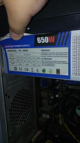

axl2468
axl2468
  • 85 posts
The brand name is encircled.
  • 24,572 posts
If not done already, reinstall the chipset drivers for your motherboard.
Has the above been done.
RAM usage aside for now as Windows being updated and checking the PSU output are more important.
Can I ask what type of Windows installation media was used to reinstall Windows and from where was it obtained.
Sorry but got to be blunt, your PSU is junk  :(
Please note that there is one thing that is possibly worse than using a known poor quality brand of PSU and that is using one that is unheard of, for brands of PSU to trust and brands to avoid please refer to the two attached links here and here
PSU database here

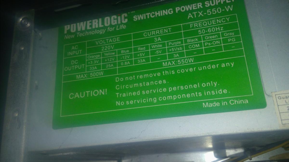

2. I have another PSU on a "PowerLogic" computer. Can I use this or will I have to buy a new one? (It's really hard to find genuine products in a country filled of low-quality products.) If I have to buy a new one, do you have any recommendations for the cheapest good-quality PSU?

You could try swapping in that PSU for testing purposes but as you will already be aware you would just be replacing one poor quality PSU with another, try installing the chipset drivers first and then testing the system.
