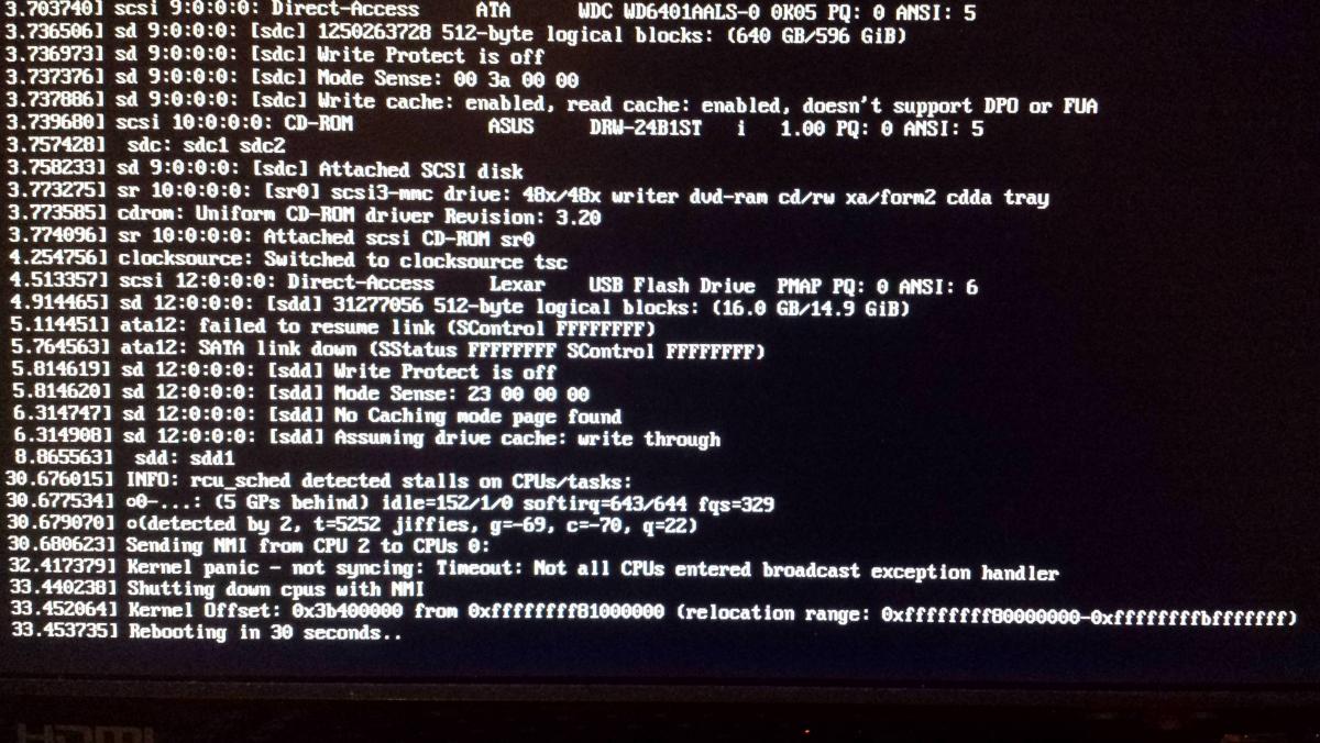

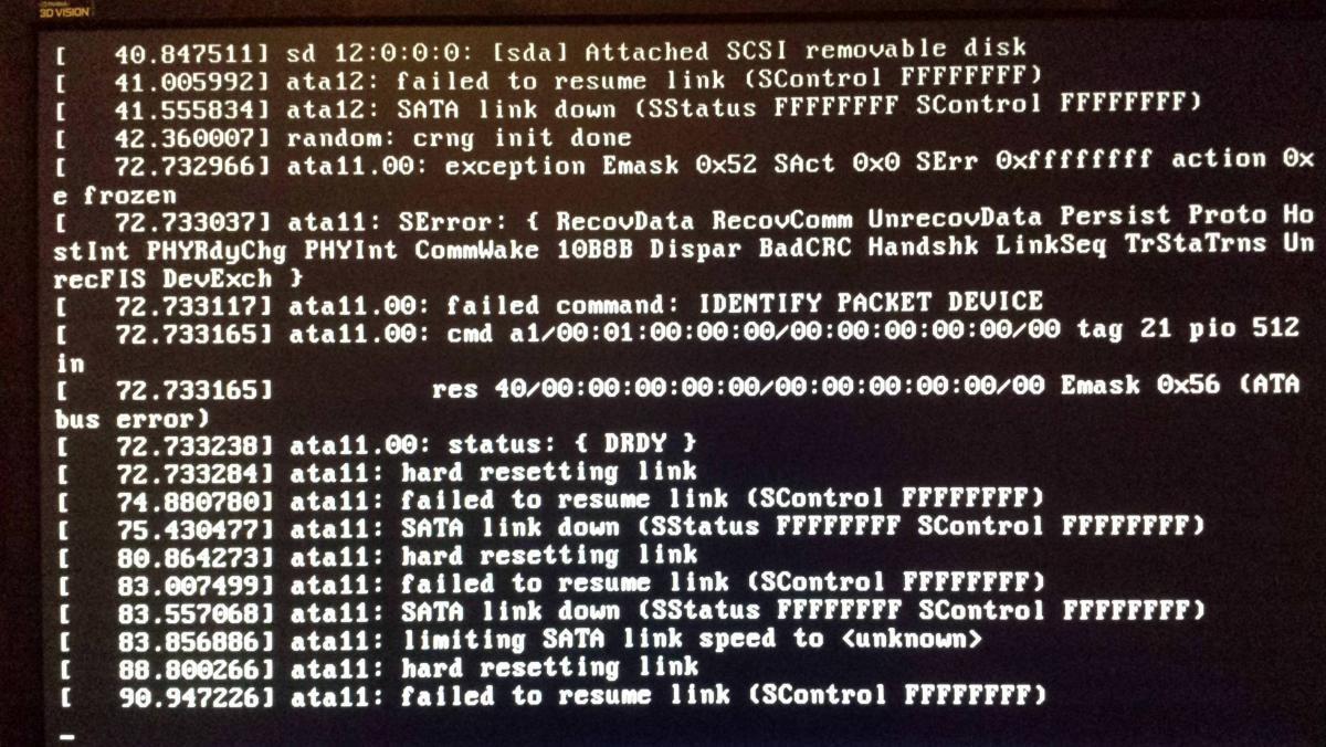

This issue is now SOLVED. I'm leaving everything below in case someone else has a similar issue in the future. The problem was that the ASM1061 the DVD drive is attached to doesn't support ATAPI commands that were being sent. This can be solved by: Unplugging the DVD drive, adding this boot flag: libata.atapi_passthru16=0 or editing /lib/udev/rules.d/60-persistent-storage.rules by finding the word ATAPI and commenting out the next line.

I'm trying to install Tails 3.3 on 16GB Lexar Jumpdrives, which are known working sticks. I've been following their installation guide to a T and I'm stuck on step 4.4. I've done all the applicable troubleshooting steps listed in the guide and the attached picture is the result of the debug nosplash command it said to do at the end of the troubleshooting notes. It says it'll reboot in 30 seconds but it's actually frozen. Unfortunately the errors given aren't listed in their troubleshooting guide.

Update: I removed the overclock from my CPU and unplugged all USB peripherals except mouse and keyboard. I no longer see the kernel panic, however it is now freezing on the errors in the screenshot attached.
